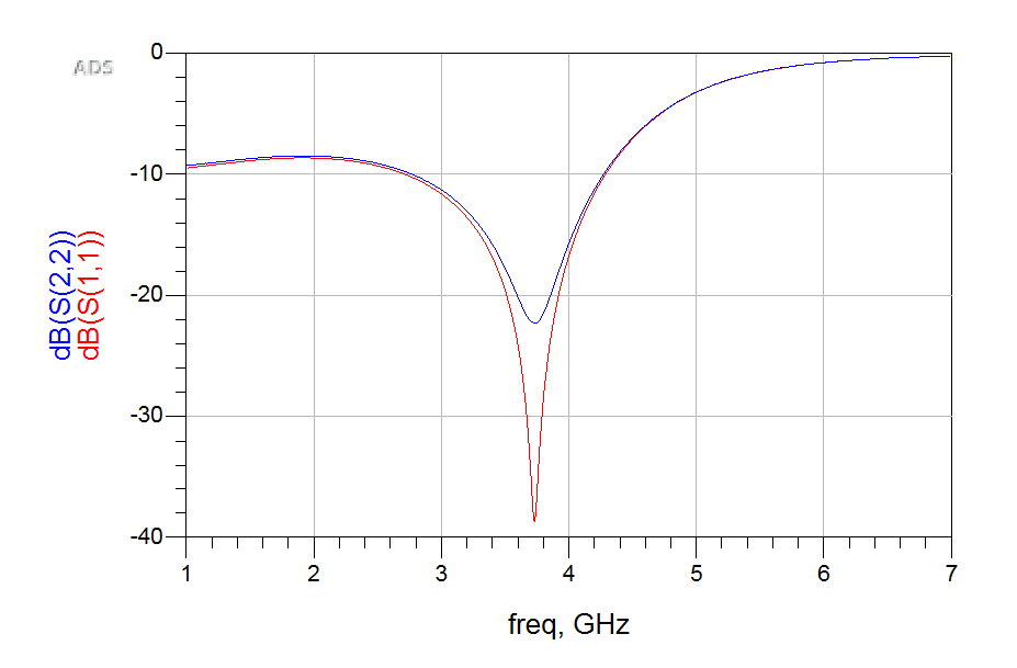

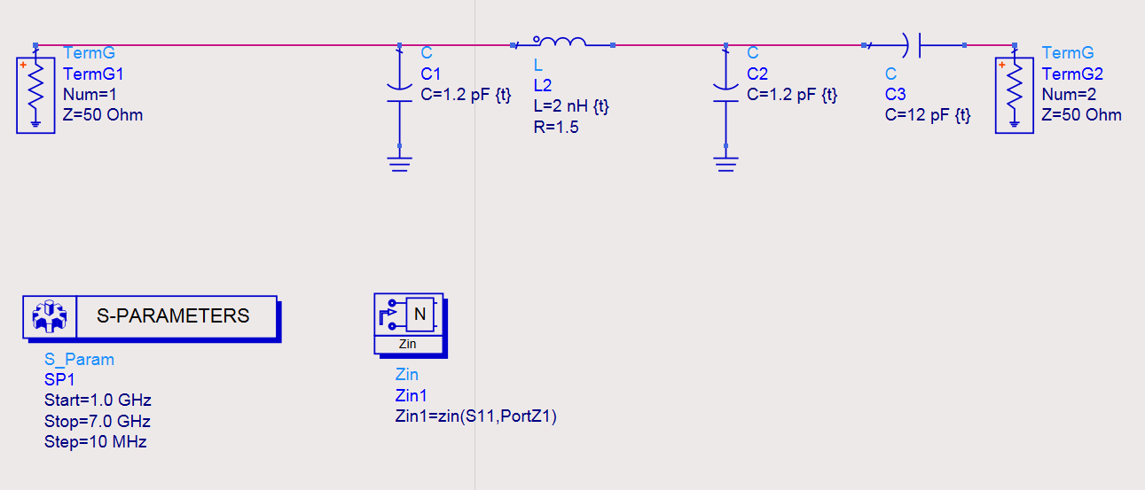

    I don't wanto to go directly from RF_P/N to the antenna. I want to study the Balun and the filter circuit with a simulator, in order to change the values of the components to keep into account the impedance of the lines of the PCB.
    To do this I used the following scheme:
    Obtaining the following graph for the scattering matrix:
    I expected a minimum in 2.4GHz but it is in 3.7GHZ, however I used 50Ohm as input impedance (RF_P/RF_ pins) which is not for sure the correct value. I need that value in order to insert it in this simulation and later I will do what I explained before.
    Is this methodology uncorrect for the cc2640?
    Thanks in advance.
  • " I want to study the Balun and the filter circuit with a simulator, in order to change the values of the components to keep into account the impedance of the lines of the PCB.": From the network you have shown, it looks like you use ideal components and you are not including the layout in the simulation.
    Normally a different length of the traces in your layout vs the reference design have limited impact. If you want to be sure, you should simulate the reference design layout with component models and compare with your layout. Then the impedance of the terminals have no impact since you are comparing.
  • I have used ideal components as a first test in order to understand the behaviour of the matching circuit, I wanted to add the layout after this.
    I will try to compare the refernce design to the mine as suggested, thank you.
