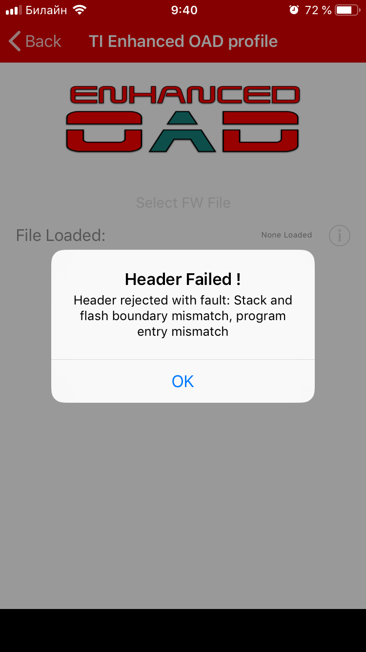

I use CC2640R2 LP, CC2640R2 SDK 3.20, and iPhone 6S.
I trying to experiment with default on-chip OAD examaple. I tested OAD with BTool - all is OK.
Now I try to perform update with Starter app. To do this i sent simple_peripheral_cc2640r2lp_oad_onchip_app_FlashROM_oad.bin file to phone and copy/share the file with Starter app. Message that the file was copied appears.
But when I try to perform update I have this error:
Also I cannot select exact file to download, because "Select FW file" is inactive. SensorTag app have the same issue. What I'm doing wrong?
    There has been some problems on the iOS app, we are working on it. Will let you know once we have pushed the fix to the apple store.

    The fix for iOS app will be pushed to the public within a week or two.
    We are still validating the android app bug/fix.
