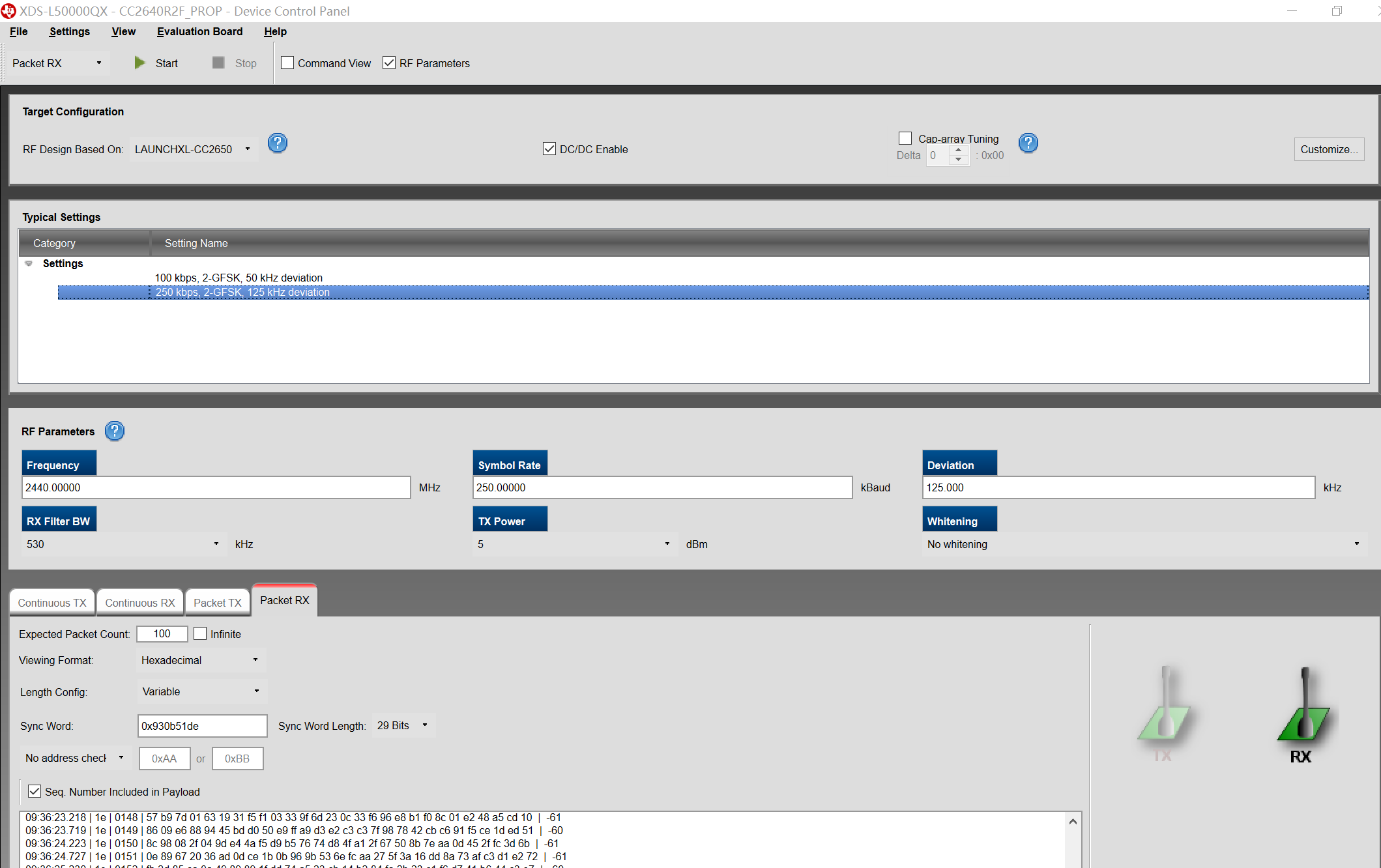

2: When rfPacketTx working on board A, The board B can received packet in proprietary mode on 250kbps,2-GFSK, 125KHz deviation status, But in 100kbps,2-GFSK, 50KHZ deviation can not receive any packets, Why 100kbps can not working??
3: Which working mode for CC2640R2F set in project rfPacketTx BLE Mode or Proprietary Mode  , I have not find the code for working mode setting, Where can I find the code???
  • The rfPacketTX example does only support proprietary packets, and you cannot configure a receiver for BLE mode with SmartRF Studio and expect packets to be received. What you receive on channel 37-39 are advertising packets and are not the packets you send with using the rfPacketTX example.
    The rfPacketTx example are using the 250 kbps settings in Studio as default. If you want to change to 100 kbps, you need to do a code export in SmartRF Studio, and replace the old settings in smartrf_settings.c with the new 100 kbps settings.

    Now I have modify the rfPacketTx.c in order to sent out my own data packet, I have set the packet as
    "Hello world!! for CC2640R2F" --------------------sent packet from board A
    "llo world! for CC2640R2F" ------------------------received packet got by board B
    there are two chars "He" has lost in transceiver side, I have checked the code in rfPackTx.c which shown belwo:

    I have modified the rfPacketTx.x code and replace the rand() data packet with my own data packet[]="Hellow World ! for CC2640R2F"; But just received "llow World! for CC2640R2F", There are two chars lost in transceiver side, How can I find it back??? Below is my received raw data:
    16:23:05.831 | 1e | 18533 | 6c 6c 6f 77 20 57 6f 72 6c 64 21 20 66 6f 72 20 43 43 32 36 34 30 52 32 46 00 03 08 | -49
    16:23:06.336 | 1e | 18533 | 6c 6c 6f 77 20 57 6f 72 6c 64 21 20 66 6f 72 20 43 43 32 36 34 30 52 32 46 00 03 08 | -50
    16:23:06.838 | 1e | 18533 | 6c 6c 6f 77 20 57 6f 72 6c 64 21 20 66 6f 72 20 43 43 32 36 34 30 52 32 46 00 03 08 | -50
    16:23:07.341 | 1e | 18533 | 6c 6c 6f 77 20 57 6f 72 6c 64 21 20 66 6f 72 20 43 43 32 36 34 30 52 32 46 00 03 08 | -50
    16:23:07.846 | 1e | 18533 | 6c(l) 6c(l) 6f(o) 77(w) 20(NULL) 57(W) 6f(o) 72(r) 6c (l) 64(d) 21(!) 20(NULL) 66(f) 6f(o) 72(r) 20(NULL) 43(C) 43(C) 32(2) 36 (6)34(4) 30(0) 52(R) 32(2) 46(F) 00(NULL) 03(ETX) 08(BS) | -50

  • You need to turn off "Seq. Number included in the Payload"
