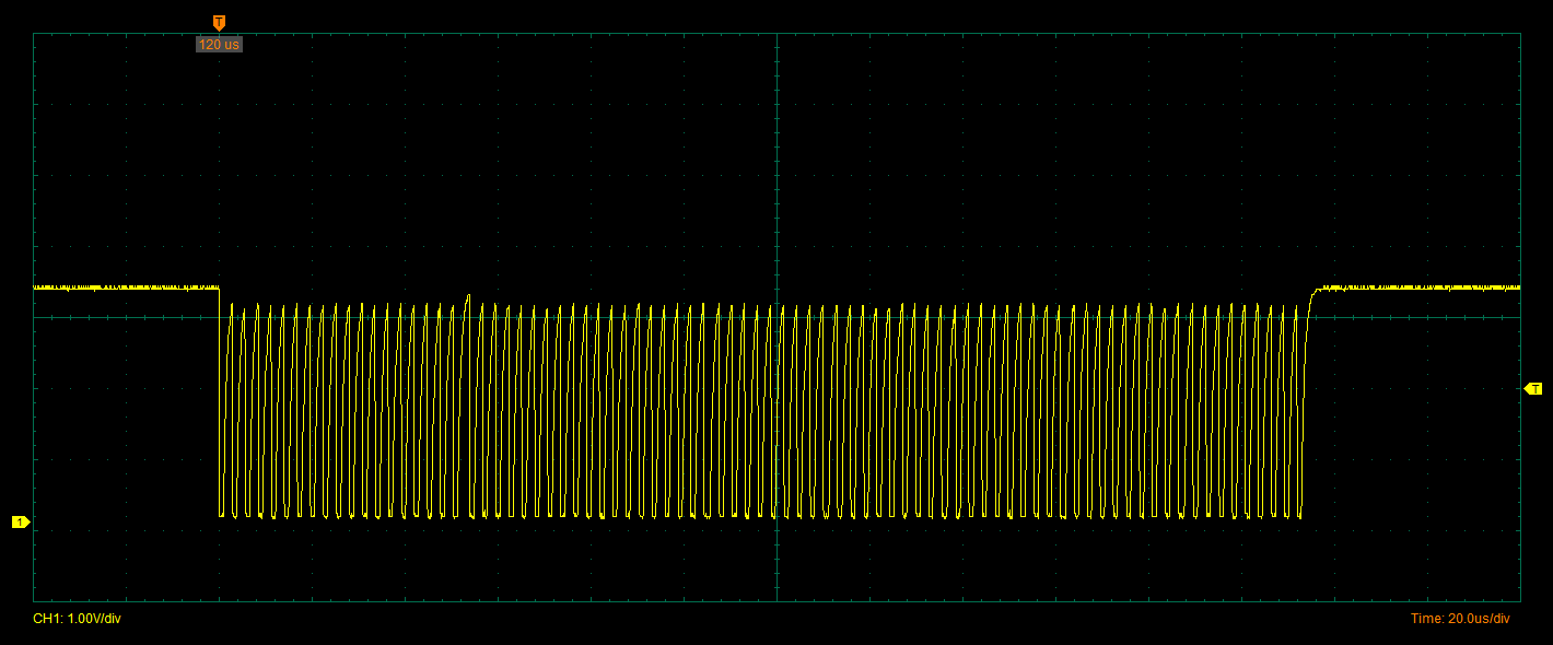

Part Number: CC2541
I have a custom board using the CC2541 chip, with two sensors attached to the I2C bus.
When reading data from sensor, I can see long gaps in communication, which I'm not used to working with different MCUs (TIVA, etc.).
It might be related to delays in I2CSTAT register update, since the I2C library is waiting between states (according to "Table 20-4. Master Receiver Mode" in user guide).
I need it in order to read data at high rate without affecting BLE connectivity.
