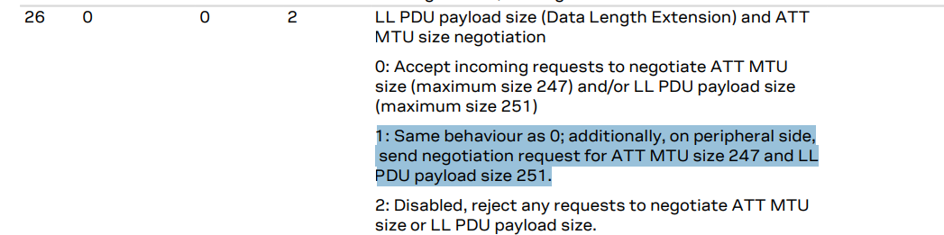

Hi
In the original thread, it said "Only the GATT client (e.g central) can initiate an MTU exchange procedure."
We would like to check that this limitation only applies to TI SOC???
Because we have another BLE module(U-Blox), it can request MTU exchange on the peripheral side
Thanks.
BR
Trevor

  • Hi Joakim,
    I did some experiments to compare the behavior between U-blox and CC2642.
    About the following experiments, I only modify the SIMPLEPROFILE_CHAR4 data length.
    Experiment 1: Peripheral sends 100 bytes to Central through the notification channel.
    Peripheral : U-blox module
    Central : Android phone with BLE Scanner App
    Result : Central can receive the 100 bytes.
    Experiment 2: Peripheral sends 20 bytes to Central through the notification channel.
    Peripheral : CC2642
    Result : Central can receive the 20 bytes.
    Experiment 3: Peripheral sends 100 bytes to Central through the notification channel.
    Peripheral : CC2642
    Result : Central can't receive any packets.
    Do you have any suggestions to me?
    Thanks.
    BR
    Trevor
