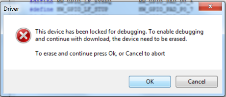

  • I tried this method, IAR Embedded studio throws this error when I remove the reset line connection to the target.
    I think the Embedded studio is trying to reset the target when I click on the "Debug without Downloading".
    Here is the communication log from IAR studio.
    Reset(resetForDebug=1)
    ReadConfig(*pConfig=0xFF) = 1
    WriteConfig(config=0xFB) = 1
    ReadXdataMemory(address=0x6249, count=1, pProtection=0x00000000)
    ReadXdataMemory(address=0x6276, count=2, pProtection=0x00000000)
    ReadStatus(*pStatus=0xFF) = 1
    I'm afraid it is not possible to connect to running target without reset of the CC2541 first. On CC2541 debug mode is entered by forcing two falling-edge transitions on the DC pin while RST pin is held low.
