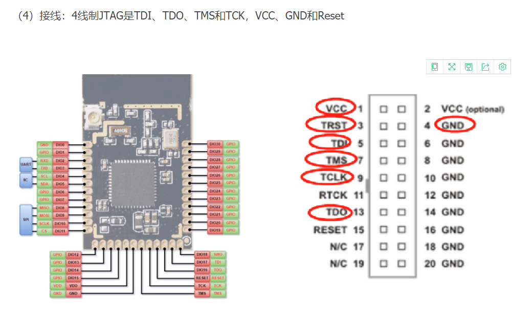

Does CC2640R2 support Jlink for debug and program download?
Do you know how can I program software into CC2640R2 by Jlink?
I tried flash programmer2,but failed. Do you have any suggestion?
Unfortunately, J-Link is not supported in Flash Programmer 2. Have you tried Uniflash?
You can use Code Composer Studio if you installed J-Link as a debug probe.

Dear Elin,
I downloaded Uniflash and tried.
Uniflash show that it support Jlink method.
But I follow the instruction to conenct jlink to CC2640R2.
The jlink always reply "cannot connect with target board"
my connection with target board is attached.
JTAG is connecting TDI、TDO、TMS and TCK,VCC、GND,Reset.
I saw that you pressed "This resolved my issue", did you get it to work using Uniflash?
