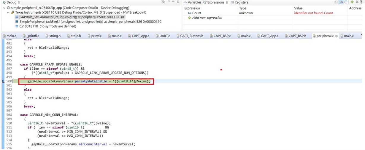

    we can sure the FW setting sould be correct by observed the "GAPROLE_PARAM_UPDATE_ENABLE" in debug mode as picture below:
    And by the way, this issue is only happened on WIN7 PC, WIN10 doesn't have this issue.

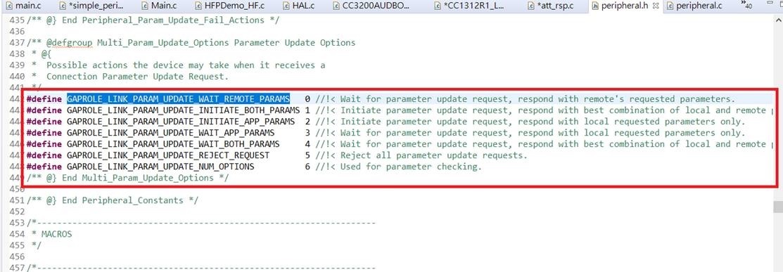

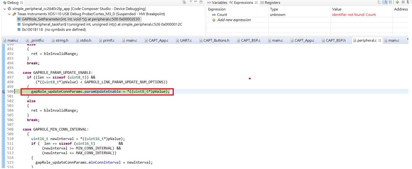

    2. we set GARROLE_PARAM_UPDATE_ENABLE as below,
    uint8_t enableUpdateRequest = DEFAULT_ENABLE_UPDATE_REQUEST;
    but anyway, we did try every items as picture below, the same still fail.
