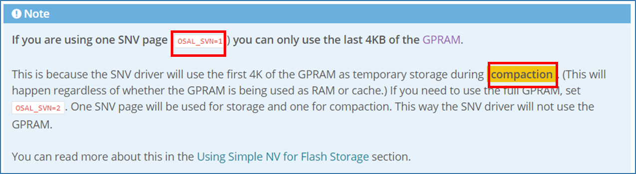

       According to the SDK, “If you are using one SNV page(OSAL_SVN=1)you can only use the last 4KB of the GPRAM”, as shown in picture 1 . The link of picture 1 is shown as followed .
http://dev.ti.com/tirex/content/simplelink_cc2640r2_sdk_3_10_00_15/docs/blestack/ble_user_guide/html/ble-stack-common/cache-as-ram.html?highlight=compaction#null
Picture 1
       My project is based on the simple peripheral project . I have already configured the OSAL_SNV as 1 , and configured the CACHE as RAM .

    In the software user's guide, it says specifically that even when you enable CACHE_AS_RAM with osal_snv = 1, the cache will be used as GPRAM to store data.
    The data will be saved from the start till the end of GPRAM. However, if a compaction is needed, the first half of GPRAM will be overriden and result in data corruption.
    What you need to do is to make sure osal_snv = 2, so that when compaction is needed, it will use flash to do the compaction instead of first page of GPRAM.
