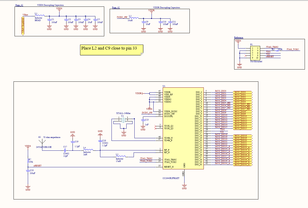

I have a custom-designed board that uses 7x7 MCU just like in the launch board. My board's schematic is almost the same as the launch board. I have also an external flash on the same pin, I have a motion sensor but I connected my sensor's interrupt pins on exactly the same with button pins of launch board, same I2C pins, same SPI pins, same UART pins, etc. Because of that, I did not think to create a custom board header and source files, instead, I use CC2640R2_LAUNCH.h and c files. I did not use 32KHz crystal but I already did this configuration properly. I am sure because before getting my custom board, I developed my code on the launch board referenced by custom board schematic. Only, I think, the related difference between custom and launch board is RF pins' schematic. I used Single-ended with external bias configuration.

Also, ı added my custom board's schematic (only MCU part) and its view.

    Your Schematic looks ok to me.
    Did you do any RF tests on your board?
    If not please do some basic tests (Tx power test, Freq accuracy, PER test) by using SmartRF Studio.

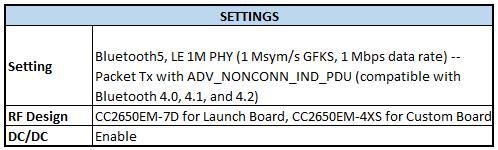

    I tested my card with SmartRF Studio with these configurations;

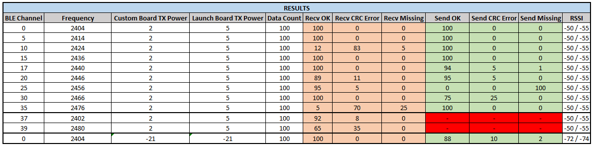

    and I tested my board with different channels (frequencies) and with different TX powers. Here are my results;
    I repeated PER test several times for each BLE Channel (both receiving and sending) and the results are average results.
    In the red part above, when I start the "Packet RX" mode at the launch board side, It receives 100 packets from other devices in my office I think because I could not press the Start button at Custom Board Packet TX mode in the meantime.
    Here are my results, if these outputs do not help you to give a clue of the problem, I am ready to do some other tests you advice or share PCB and software project directly with TI engineers.
    Dogus
    Your test results looks good. I don't see any issue with your results. The  Tx power is 3dB lower than LP  is because you use Single ended. This is expected result.
    The results shows that your board is OK. No issue with your hardware.
