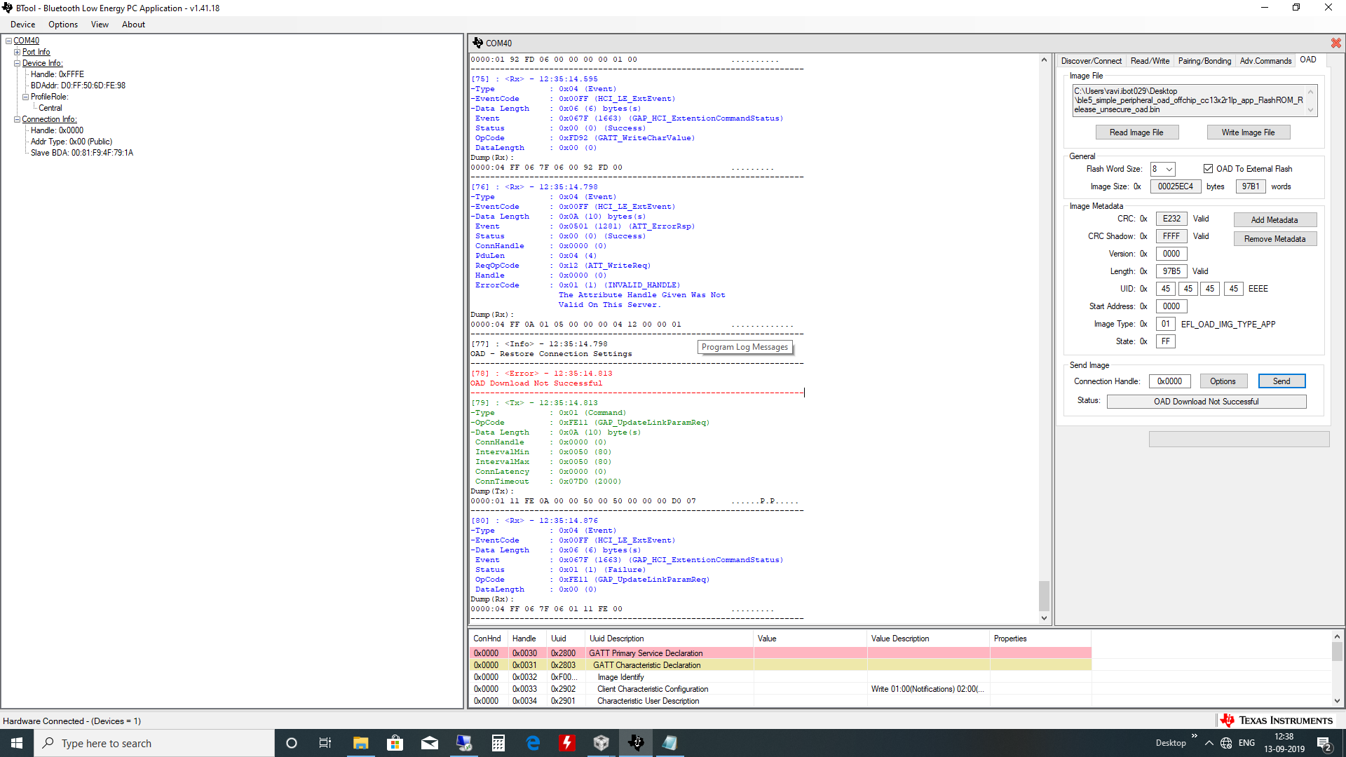

I am executing simple_peripheral_oad_offchip example in cc1352R1launch pad (E-version )and followed the procedure given in the ble user guide for over the air download(OAD) from btool but I am getting OAD Download Not Successful. I have attached the screen shot of the btool oad procedure, can u help to do successful oad.
    What SDK version are you using?
    I am using  simpleink_cc13x2_26x2_sdk_3_10_01_11 version sdk
  • Hi Ravi,
    Could you please share the full BTool log?
    I am still having the problem, I am using simpleink_cc13x2_26x2_sdk_3_10_01_11 version sdk, and the btool version is v1.41.8,tried with both cc1352r1 launchpad with(C,E versions) and I am using cc2540 dongle as central , I am attaching BTOOL log and screen shot

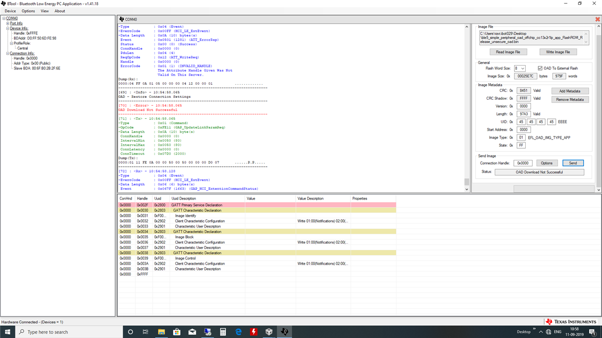

    [45] : <Info> - 12:35:11.330
    OAD - Update Connection Settings
    [46] : <Info> - 12:35:11.361
    Start OAD Download
    [47] : <Info> - 12:35:11.361
    OAD Send UUID Discovery
    [48] : <Tx> - 12:35:11.361
    -Type           : 0x01 (Command)
    -OpCode         : 0xFE11 (GAP_UpdateLinkParamReq)
    -Data Length    : 0x0A (10) byte(s)
     ConnHandle     : 0x0000 (0)
     IntervalMin    : 0x0006 (6)
     IntervalMax    : 0x0006 (6)
     ConnLatency    : 0x0000 (0)
     ConnTimeout    : 0x0032 (50)
    Dump(Tx):
    0000:01 11 FE 0A 00 00 06 00 06 00 00 00 32 00       ............2.
    [49] : <Tx> - 12:35:11.392
    -OpCode         : 0xFD86 (GATT_DiscPrimaryServiceByUUID)
    -Data Length    : 0x12 (18) byte(s)
     Value          : 00:00:00:00:00:00:00:B0:00:40:51:04:C0:FF:00:F0
    Dump(Tx):
    0000:01 86 FD 12 00 00 00 00 00 00 00 00 00 B0 00 40 ...............@
    0010:51 04 C0 FF 00 F0                               Q.....
    [50] : <Rx> - 12:35:11.424
    -Type           : 0x04 (Event)
    -EventCode      : 0x00FF (HCI_LE_ExtEvent)
    -Data Length    : 0x06 (6) bytes(s)
     Event          : 0x067F (1663) (GAP_HCI_ExtentionCommandStatus)
     Status         : 0x01 (1) (Failure)
     DataLength     : 0x00 (0)
    Dump(Rx):
    0000:04 FF 06 7F 06 01 11 FE 00                      .........
    [51] : <Rx> - 12:35:11.439
     Status         : 0x00 (0) (Success)
    Dump(Rx):
    0000:04 FF 06 7F 06 00 86 FD 00                      .........
     PduLen         : 0x13 (19)
     Format         : 0x02 (2) (A List Of 1 Or More Handles With Their 128-bit UUIDs)
     Handle         : 0032
     Uuid           : 00:00:00:00:00:00:00:B0:00:40:51:04:C1:FF:00:F0
    Dump(Rx):
    0000:04 FF 19 05 05 00 00 00 13 02 32 00 00 00 00 00 ..........2.....
    0010:00 00 00 B0 00 40 51 04 C1 FF 00 F0             .....@Q.....
    [59] : <Rx> - 12:35:12.704
    -Data Length    : 0x13 (19) bytes(s)
     Event          : 0x0505 (1285) (ATT_FindInfoRsp)
     PduLen         : 0x0D (13)
     Format         : 0x01 (1) (A List Of 1 Or More Handles With Their 16-bit Bluetooth UUIDs)
     Handle         : 0033
     Uuid           : 02:29
     Handle         : 0034
     Uuid           : 01:29
     Handle         : 0035
     Uuid           : 03:28
    Dump(Rx):
    0000:04 FF 13 05 05 00 00 00 0D 01 33 00 02 29 34 00 ..........3..)4.
    0010:01 29 35 00 03 28                               .)5..(
    [60] : <Rx> - 12:35:12.970
    -Data Length    : 0x19 (25) bytes(s)
     PduLen         : 0x13 (19)
     Handle         : 0036
     Uuid           : 00:00:00:00:00:00:00:B0:00:40:51:04:C2:FF:00:F0
    Dump(Rx):
    0000:04 FF 19 05 05 00 00 00 13 02 36 00 00 00 00 00 ..........6.....
    0010:00 00 00 B0 00 40 51 04 C2 FF 00 F0             .....@Q.....
    [61] : <Rx> - 12:35:13.236
     PduLen         : 0x0D (13)
     Handle         : 0037
     Uuid           : 02:29
     Handle         : 0038
     Uuid           : 01:29
     Handle         : 0039
     Uuid           : 03:28
    Dump(Rx):
    0000:04 FF 13 05 05 00 00 00 0D 01 37 00 02 29 38 00 ..........7..)8.
    0010:01 29 39 00 03 28                               .)9..(
    [62] : <Rx> - 12:35:13.486
     PduLen         : 0x13 (19)
     Handle         : 003A
     Uuid           : 00:00:00:00:00:00:00:B0:00:40:51:04:C5:FF:00:F0
    Dump(Rx):
    0000:04 FF 19 05 05 00 00 00 13 02 3A 00 00 00 00 00 ..........:.....
    0010:00 00 00 B0 00 40 51 04 C5 FF 00 F0             .....@Q.....
    [63] : <Rx> - 12:35:13.751
    -Data Length    : 0x0F (15) bytes(s)
     PduLen         : 0x09 (9)
     Handle         : 003B
     Uuid           : 02:29
     Handle         : 003C
     Uuid           : 01:29
    Dump(Rx):
    0000:04 FF 0F 05 05 00 00 00 09 01 3B 00 02 29 3C 00 ..........;..)<.
    0010:01 29                                           .)
    [64] : <Rx> - 12:35:14.017
     Status         : 0x1A (26) (The Procedure Is Completed)
     PduLen         : 0x00 (0)
    Dump(Rx):
    0000:04 FF 06 05 05 1A 00 00 00                      .........
    [65] : <Info> - 12:35:14.017
    OAD Send Configuration Info To Image Identify
    [66] : <Tx> - 12:35:14.017
    -OpCode         : 0xFD92 (GATT_WriteCharValue)
    -Data Length    : 0x06 (6) byte(s)
     Handle         : 0x0033 (51)
     Value          : 01:00
    Dump(Tx):
    0000:01 92 FD 06 00 00 33 00 01 00                   ......3...
    [67] : <Rx> - 12:35:14.079
    Dump(Rx):
    0000:04 FF 06 7F 06 00 92 FD 00                      .........
    [68] : <Rx> - 12:35:14.267
     Event          : 0x0513 (1299) (ATT_WriteRsp)
     PduLen         : 0x00 (0)
    Dump(Rx):
    0000:04 FF 06 13 05 00 00 00 00                      .........
    [69] : <Info> - 12:35:14.267
    OAD Send Configuration Info To Image Notify
    [70] : <Tx> - 12:35:14.282
     Handle         : 0x0037 (55)
     Value          : 01:00
    Dump(Tx):
    0000:01 92 FD 06 00 00 37 00 01 00                   ......7...
    [71] : <Rx> - 12:35:14.329
    Dump(Rx):
    [72] : <Info> - 12:35:14.532
    OAD Send Configuration Info To Image Status
    [73] : <Rx> - 12:35:14.532
     PduLen         : 0x00 (0)
    Dump(Rx):
    [74] : <Tx> - 12:35:14.532
     Handle         : 0x0000 (0)
     Value          : 01:00
    Dump(Tx):
    0000:01 92 FD 06 00 00 00 00 01 00                   ..........
    [75] : <Rx> - 12:35:14.595
    Dump(Rx):
    [76] : <Rx> - 12:35:14.798
    -Data Length    : 0x0A (10) bytes(s)
     Event          : 0x0501 (1281) (ATT_ErrorRsp)
     PduLen         : 0x04 (4)
     ReqOpCode      : 0x12 (ATT_WriteReq)
     Handle         : 0x0000 (0)
     ErrorCode      : 0x01 (1) (INVALID_HANDLE)
                      The Attribute Handle Given Was Not
                      Valid On This Server.
    Dump(Rx):
    0000:04 FF 0A 01 05 00 00 00 04 12 00 00 01          .............
    [77] : <Info> - 12:35:14.798
    OAD - Restore Connection Settings
    [78] : <Error> - 12:35:14.813
    [79] : <Tx> - 12:35:14.813
     IntervalMin    : 0x0050 (80)
     IntervalMax    : 0x0050 (80)
     ConnTimeout    : 0x07D0 (2000)
    Dump(Tx):
    0000:01 11 FE 0A 00 00 50 00 50 00 00 00 D0 07       ......P.P.....
    [80] : <Rx> - 12:35:14.876
    Dump(Rx):
