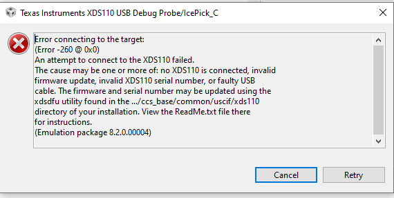

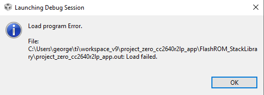

This is what happens...
i click the debug button, ccs compiles, links & starts to communicate with the launchpad & i get the following error:
so i remove power from the launchpad (disconnect the usb cable as power is supplied from usb) & reconnect & click retry.
but i then get this error instead...
so i click OK which returns me to the ccs edit state,
i again remove power from the launchpad & reconnect & click debug.
it starts the process & i get the first error again,
so i remove & reconnect power & click retry
and this time it downloads it all & sits waiting at main()!!
& this is consistently happening in this sequence every time i try & download my program..

    However, an interesting thing was the following....i ran the xdsdfu utility as "xdsdfu -e" and it reported NO xds110, i then disconnected it & reconnected and it reported the FOUND xds110
    Running this command a few times consistently returned the correct results.
    I then tried to download & debug from CCS & it came back with the result:
    Cortex_M3_0: GEL Output: Memory Map Initialization Complete.
    Cortex_M3_0: Failed Board Reset: (Error -260 @ 0x0) An attempt to connect to the XDS110 failed.
    I then ran "xdsdfu -e" again & sure enough it reported NO xds110!!
    If at this point i disconnect the USB cable & reconnect the USB & click RETRY, CCS now DOES find the XDS110 (because it has reset itself??) and loading proceeds normally.
    To me it appears that CCS somehow causes the XDS110 to shut down after performing the memory map inialization!!
    Is that possible at all, and if it is, what can i do about it??
    (recall this is consistent with both my launchpads - both purchased at same time about 3 months ago)
    moshe

    The error has now changed slightly......ccs gives the following message on loading the launchpad:
    Cortex_M3_0: Failed Board Reset: (Error -260 @ 0x0) An attempt to connect to the XDS110 failed. The cause may be one or more of: no XDS110 is connected, invalid firmware update, invalid XDS110 serial number, or faulty USB cable. The firmware and serial number may be updated using the xdsdfu utility found in the .../ccs_base/common/uscif/xds110 directory of your installation. View the ReadMe.txt file there for instructions. (Emulation package 8.3.0.00003)
    Cortex_M3_0: GEL: Error while executing StartUp( 9, 2, 0, 1751 ): Reset failed: retcode=-1
    at GEL_AdvancedReset("Board Reset") [cc26x0.gel:29]
    at StartUp(9, 2, 0, 1751)
    IcePick_C: Error connecting to the target: (Error -260 @ 0x0) An attempt to connect to the XDS110 failed. The cause may be one or more of: no XDS110 is connected, invalid firmware update, invalid XDS110 serial number, or faulty USB cable. The firmware and serial number may be updated using the xdsdfu utility found in the .../ccs_base/common/uscif/xds110 directory of your installation. View the ReadMe.txt file there for instructions. (Emulation package 8.3.0.00003)
