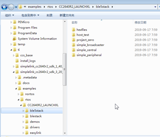

where can I find the samples of oad and multi_role for 3_20 sdk?
original post: e2e.ti.com/.../3103327
At this time the multi_role functionality likely will not fit into available flash using ble5stack on CC2640R2. You can refer to the discussions in e2e.ti.com/.../2729989
