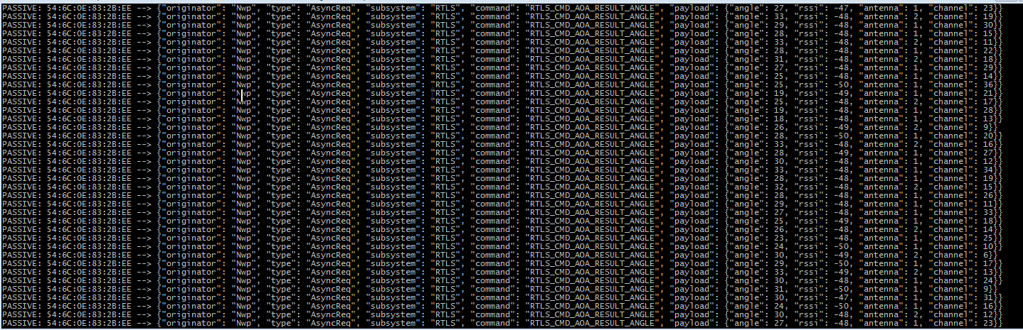

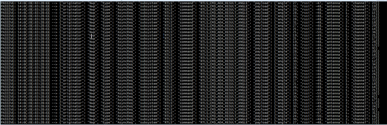

Customer has set up the demo as below:
They didn't move any board, but according to rtls_example.py, the angle is dynamic, between 19 and 33.
Please advise how to get the stable angle value in this demo. Thanks!

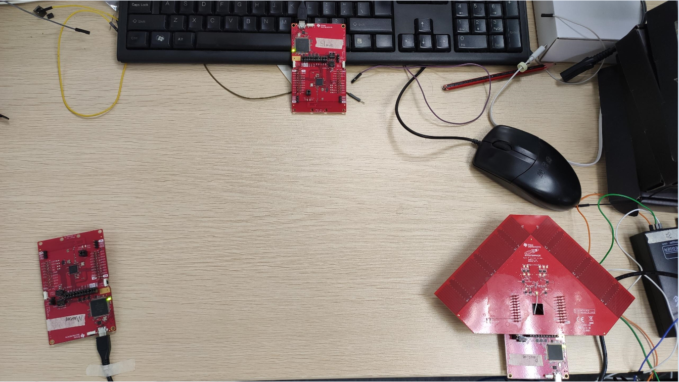

Hi, Marie,
They set up this demo based on SDK v3.20. And there is no big metal object since the engineer is in office which is an open air environment.
Yonghua
Hi Yonghua Pan,
Sorry to say this but the test environment showed on the picture is the worst you can have! There is a lot reflective surfaces that will provoke multi-path and bad measures. A desk is definitely *not* a good environment for AoA.
If you can run the tests in an open environment (outside or in an anechoic chamber), you will probably get better results. The goal is to remove all the surfaces that could reflect the RF signals (such as metallic pieces, walls...) and cause multi-path.
