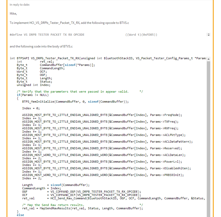

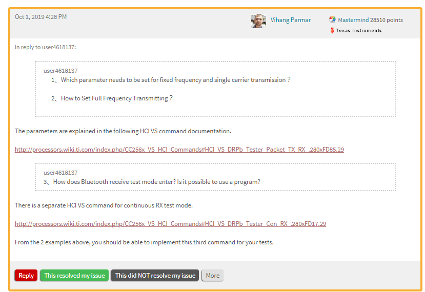

  • user4618137 said:
          1、Which parameter needs to be set for fixed frequency and single carrier transmission?
          2、How to Set Full Frequency Transmitting?
    The parameters are explained in the following HCI VS command documentation.
    http://processors.wiki.ti.com/index.php/CC256x_VS_HCI_Commands#HCI_VS_DRPb_Tester_Packet_TX_RX_.280xFD85.29
    user4618137 said:
    3、How does Bluetooth receive test mode enter? Is it possible to use a program?
    There is a separate HCI VS command for continuous RX test mode.
    http://processors.wiki.ti.com/index.php/CC256x_VS_HCI_Commands#HCI_VS_DRPb_Tester_Con_RX_.280xFD17.29
    From the 2 examples above, you should be able to implement this third command for your tests.

  • Hi Vihang Parmar:
        The VS_Enable_FCC_Test_Mode API is an implementation of the HCI_VS_DRPb_Tester_Con_TX (0xFD84) command. How to write HCI_VS_DRPb_Tester_Con_RX program? Do I need to add it to my SPPDEMO program so that CC2564B can enter the receive test mode?
    Yes, you can add a new API to the BTVS.c that implements the HCI_VS_DRPb_Tester_Con_TX command. You can use the HCI_VS_DRPb_Tester_Con_TX command and its implementation (VS_Enable_FCC_Test_Mode API) as an example.
            I see what you're saying,but  How to write a continuous RX test program based on the command of HCI_VS_DRPb_Tester_Con_RX ? Could you please provide a routine for continuous RX?
