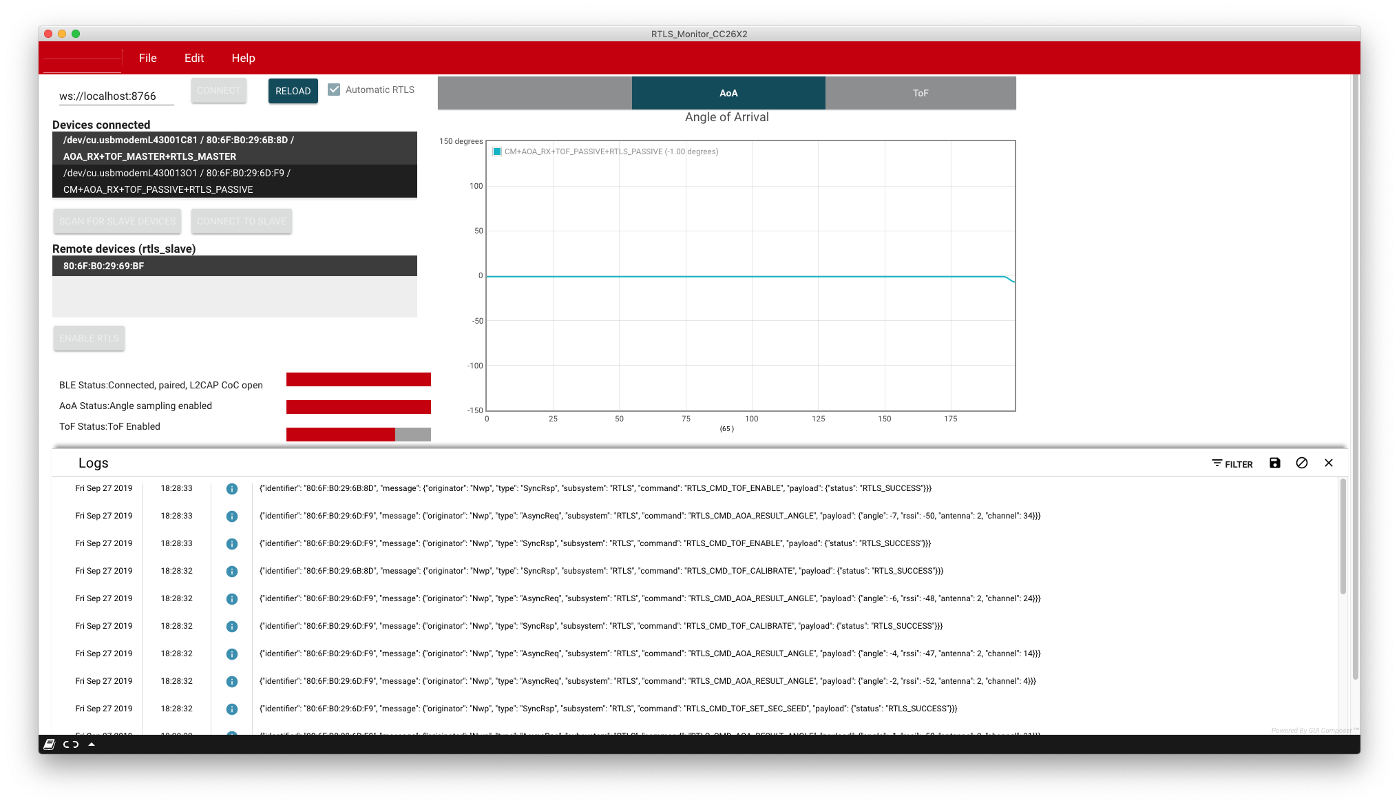

      But, when ToF is enabled, ToF does not proceed any further after RTLS_CMD_TOF_ENABLE.
      Figure 3. The freezed progress of ToF in CC1352P-2.

      In this circumstances, I would like to get the information the following lists.
      1. The way to change DIO 27 pin for "Ax".
        I think pOverridesCommon in urfc.c (passive) is involved in this.
        (line 142: 0xC0040341, // Pointer to antenna switching table in next entry)
      2. pOverrides_2M codes for CC13X2P in TOF.c
      3. How to fix the freezing problem of ToF?
        The ToF cannot process "RTLS_CMD_TOF_CALIBRATE", after enable ToF.
        CC2652 is process the ToF sequence as below:
        Master  "type": "SyncRsp"  "subsystem": "RTLS"  "command": "RTLS_CMD_TOF_GET_SEC_SEED"  "payload": {"seed": "CF:25:B3:DB:A1:62:33:FB:47:2A:E6:F6:83:8A:A5:EF:C7:F1:67:EE:39:81:B9:B4:84:5E:5A:E0:57:6E:AC:7B"}}}
        Passive  "type": "SyncRsp"  "subsystem": "RTLS"  "command": "RTLS_CMD_TOF_SET_SEC_SEED"  "payload": {"status": "RTLS_SUCCESS"}}}
        Passive  "type": "SyncRsp"  "subsystem": "RTLS"  "command": "RTLS_CMD_TOF_CALIBRATE"  "payload": {"status": "RTLS_SUCCESS"}}}
        Master  "type": "SyncRsp"  "subsystem": "RTLS"  "command": "RTLS_CMD_TOF_CALIBRATE"  "payload": {"status": "RTLS_SUCCESS"}}}
        Passive  "type": "SyncRsp"  "subsystem": "RTLS"  "command": "RTLS_CMD_TOF_ENABLE"  "payload": {"status": "RTLS_SUCCESS"}}}
        Master  "type": "SyncRsp"  "subsystem": "RTLS"  "command": "RTLS_CMD_TOF_ENABLE"  "payload": {"status": "RTLS_SUCCESS"}}}
        Passive  "type": "AsyncReq"  "subsystem": "RTLS"  "command": "RTLS_CMD_TOF_CALIBRATE"  "payload": {"calibVals": [{"freq": 2408 "tick": 524.2448181152344 "tickVariance": 0.5265231013298035 "rssi": -49 "numOk": 31} {"freq": 2412 "tick": 524.2315368652344 "tickVariance": 0.5429900169372559 "rssi": -49 "numOk": 29} {"freq": 2418 "tick": 524.2874877929687 "tickVariance": 0.4573494166135788 "rssi": -49 "numOk": 32} {"freq": 2424 "tick": 524.1654235839844 "tickVariance": 0.6796158850193024 "rssi": -49 "numOk": 30}]}}}
        Passive  "type": "AsyncReq"  "subsystem": "RTLS"  "command": "RTLS_CMD_TOF_RESULT_DIST"  "payload": {"distance": 0.7031402587886362 "rssi": -48}}}
        Passive  "type": "AsyncReq"  "subsystem": "RTLS"  "command": "RTLS_CMD_TOF_RESULT_DIST"  "payload": {"distance": 0.45285797119129967 "rssi": -49}}}
        Master  "type": "AsyncReq"  "subsystem": "RTLS"  "command": "RTLS_CMD_TOF_CALIBRATE"  "payload": {"calibVals": [{"freq": 0 "tick": 0.0 "tickVariance": 0.0 "rssi": -34 "numOk": 0} {"freq": 0 "tick": 0.0 "tickVariance": 0.0 "rssi": -34 "numOk": 0} {"freq": 0 "tick": 0.0 "tickVariance": 0.0 "rssi": -34 "numOk": 0} {"freq": 0 "tick": 0.0 "tickVariance": 0.0 "rssi": -34 "numOk": 0}]}}}
        Passive  "type": "AsyncReq"  "subsystem": "RTLS"  "command": "RTLS_CMD_TOF_RESULT_DIST"  "payload": {"distance": -0.6928958892826529 "rssi": -48}}}
        But, the CC1352P is process only ToF enable as below:
        Master  "type": "SyncRsp"  "subsystem": "RTLS"  "command": "RTLS_CMD_TOF_GET_SEC_SEED"  "payload": {"seed": "C6:5C:24:9D:67:3E:D9:DF:CE:31:66:7C:3A:CE:94:38:EF:F7:68:7C:CF:E9:9C:4A:B6:BD:68:D2:61:B3:99:CE"}}}
      4. A guidance to set tx power 20 dbm to rtls projects.
      Inseob
    • Hi Kim,
      1-      One remark about the Ax pin: this pin basically enables the first or the second antennas-array. This pin is not directly handles by the radio (contrary to the regular antennas pins) but is basically toggled after each connection event. The application is responsible to do this toggling: this is why this pin is not involved in the overrides.
      Maybe obvious but, the radio doesn’t know if it is working with one or the other antennas-array: only the application knows.
      In summary: nothing to change in urfc.c. Just verify that this pin is not hard coded in the application (especially in AOA_setupNextRun()).
      2-      In a general way, the overrides can be found using Smart RF Studio. I would encourage you to have a look at it.
      3-      Regarding the problem of the freezing calibration.
      Once again, maybe an obvious comment, but ToF “filters” the incoming samples and discard the ones above a certain threshold (this to eliminate the packets which have been reflected). As you are not using exactly the same device and the same settings as in the out-of-the-box example, maybe this threshold is not any longer accurate and should be modify (however, before you modify it, you should basically try to run the calibration with a slightly longer distance between the devices).
      4-      Tx Power can be changed using HCI_EXT_SetTxPowerCmd().
