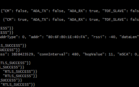

    I set connection interval at 240. I noticed ToF method is executed every 300 ms, while AoA every 600 ms. Looking at python log messages, I can see the attached message, where connection interval is set to 480.
    Let me know your opinion.
    Thank you
    Luca
  • Hi Luca,
    2.) Yes, this is supported in the next version of the SDK. Have a look at the updated documentation for RTLS when it is released.
    1.) So, initially, you are supposed to see new values at every connection event, and so the time-stamp should match your connection interval. Just note that the time-stamps you see come from Python, and they will depend on how the different threads are scheduled.
    As a first step to debug this, I would recommend that you have a look at the 'RTLSCtrl_postProcessAoa(...)' function in 'rtls_ctrl_aoa.c'. There are a few 'AOA_*' function calls (e.g. AOA_postProcess(...)) that return status values (but these values are not necessarily used). You can see if you get trapped at any of these calls if there is anything but success. The issue you see might be related to some of the data values are dropped, which looks like an increase in the connection interval.
    Vetle
  • Hi Vetle,
    I can't wait for new SDK! Do you have any expected release date?
    Concerning connection interval, what I find abnormal is the payload value which is double of connection interval set in configuration file. So I think somewhere it is multiplied by 2 but I cannot find where. Do you agree with this consideration?
    Thank you
    Luca
  • Hi Luca,
    On the release date I can't be any more specific than that it will probably be released within the next couple of weeks.
    If you go to the SDK download page (http://www.ti.com/tool/SIMPLELINK-CC13X2-26X2-SDK), you can select the "Alert Me" button to get notified when the new SDK release is available.
    I understand your issue, and no, there's no section of which your connection interval should be multiplied by 2. This is why I recommend that you have a look at the post processing of the data, and whether any of these functions return a status other than 'success'. If every other data event is dropped, it might be masked as if the connection interval is doubled.
    Vetle
