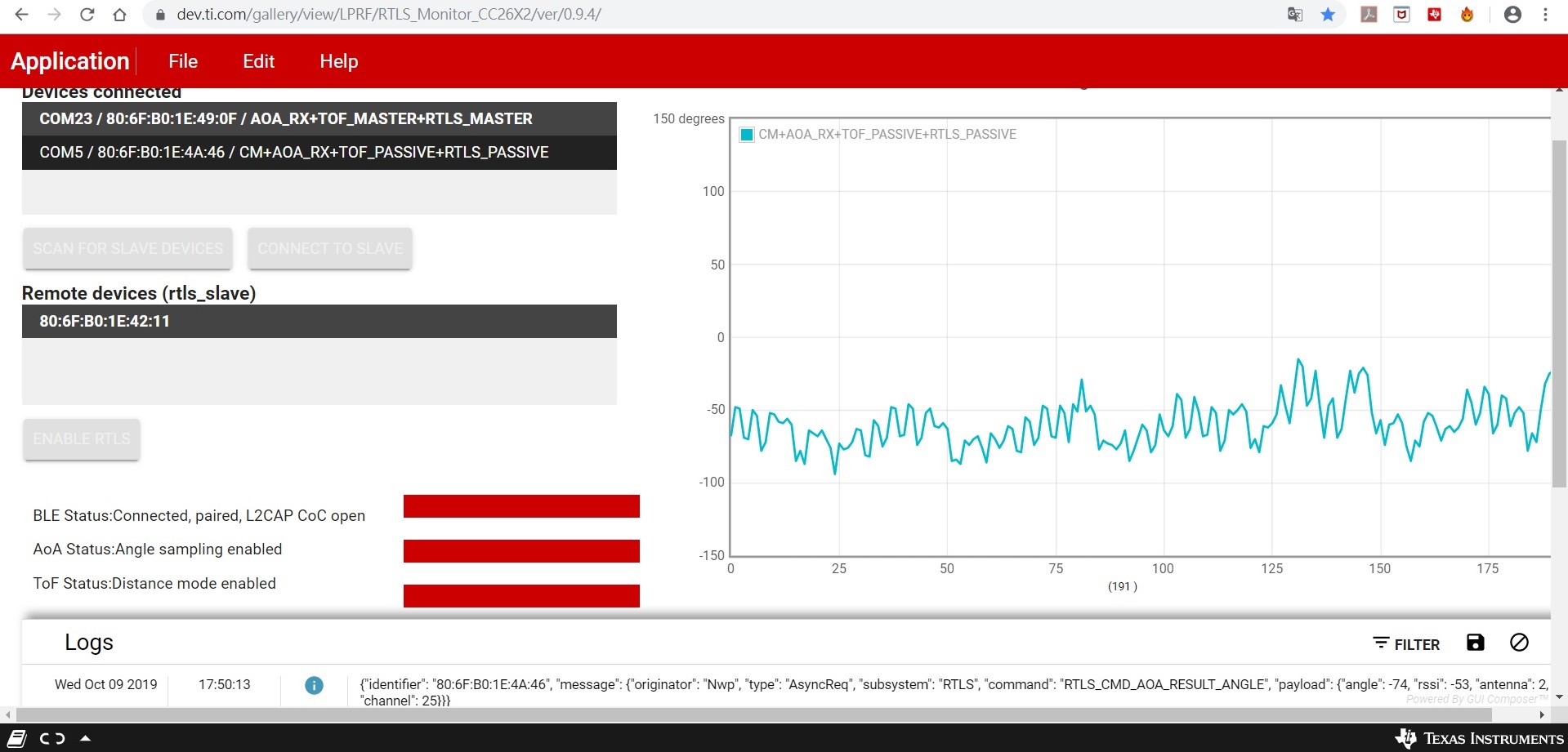

CCS/BOOSTXL-AOA: AoA angle value is unstable,How can I improve it ?
Part Number: BOOSTXL-AOA
HW:CC2642R1/CC2552R1 Development Kit(2652) Rev:B x 3  ; BOOSTXL-AOA x 1
SDK: SimpleLink CC12x2 26x2 SDK - 3.20.00.68
Case 1.
SDK :3.20.00.68 build default code r(tls_master,rtls_slave,rtls_passive)
reference guide: RTLS Toolbox Fundamentals
dev.ti.com/.../node

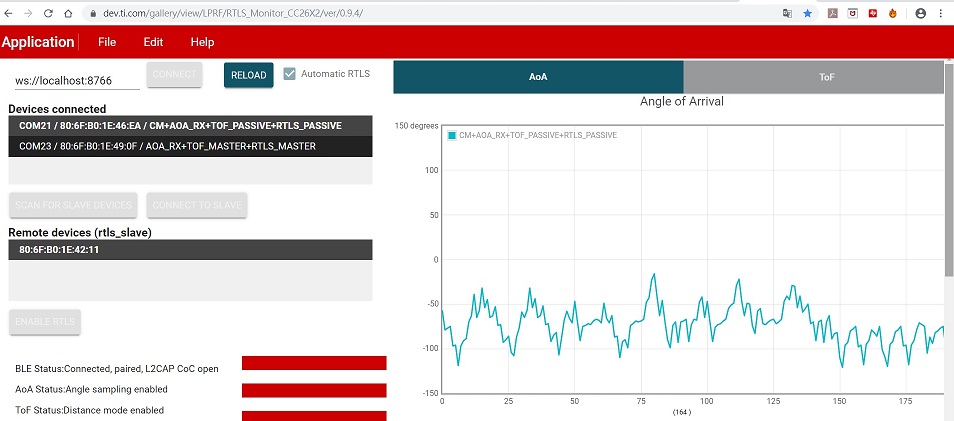

issue: angle is unstable.

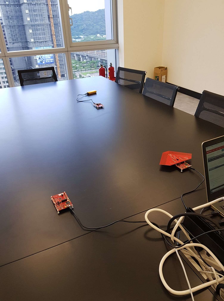

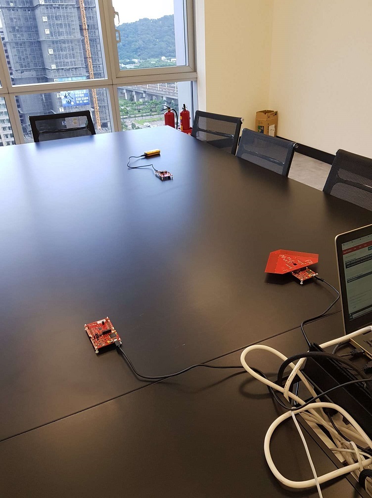

Setup environment
Angle : 0 degree
environment

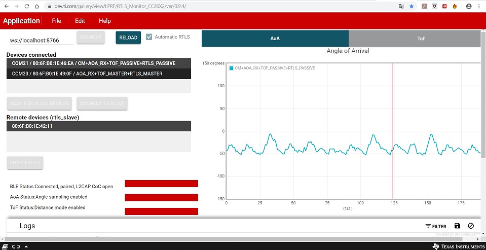

result
default_0.csv

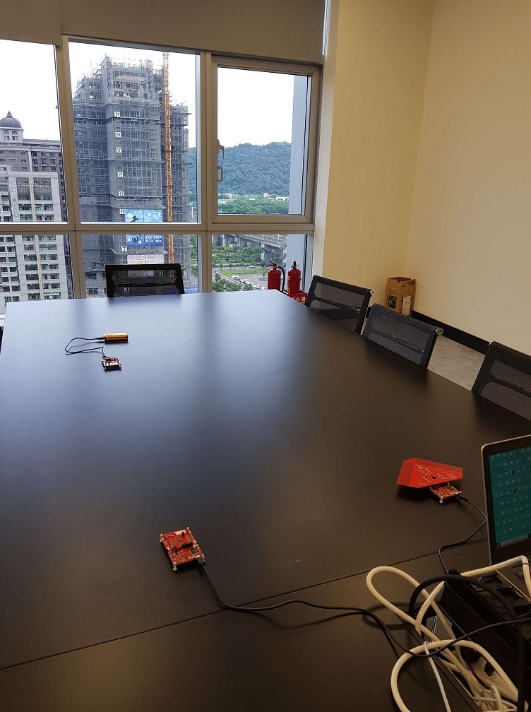

Angle : 30 degree
environment
result
default_30.csv

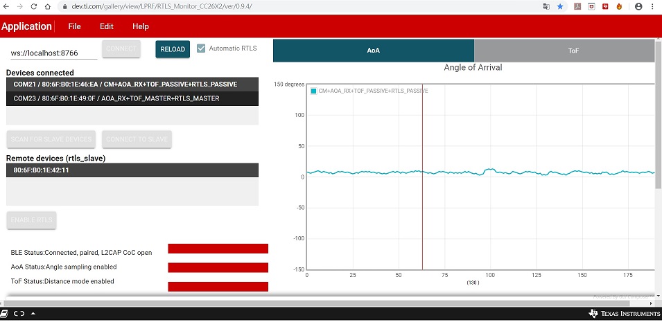

Case 2:
guide:Angle of Arrival(AOA) , according guide modify 3.20.00.68 code change to one antenna,
dev.ti.com/.../node
issue: whatever change slave position, the the measuring angle isn't change almoust(the value about 6 angle)
Angle : 0 degree
result
a1_0.csv
Angle : 30 degree
result
a1_30.csv

    Case 1: This kind of results is generally due to the test's environment. For example, does the table have some metallic parts? This could be very annoying for AoA. If so, I recommend you to change the test's environment. In addition, you can try to elevate a bit your launchpad and to have the slave and the passive a bit closer.
    Case 2: Do you mean you only activated one antennas-array? If so, make your-self sure that you haven't forget any step. In addition, make sure to consider the proper antenna array.

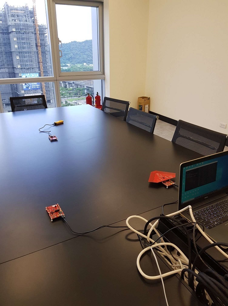

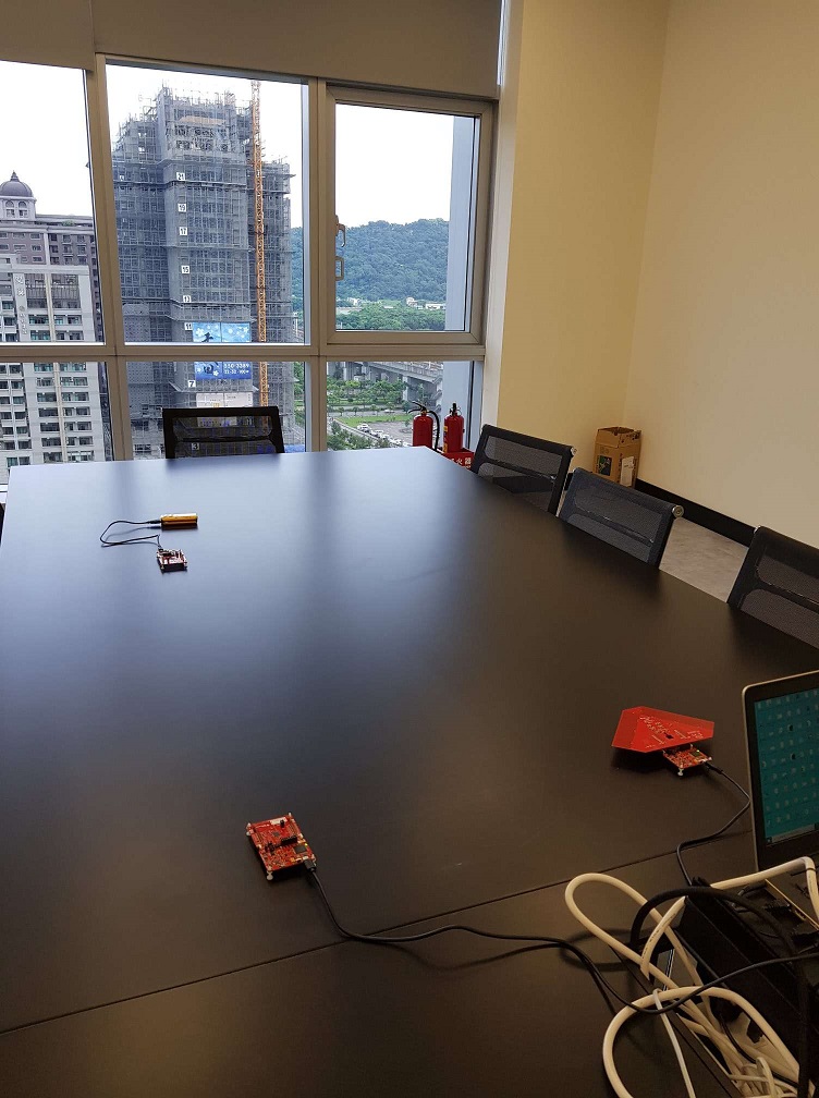

    Case 1:
    I test in wood desk, near haven't  metallic parts .and slave and passive distance about 1m , I have try to closer.but the result is the same.

    Yes , I follow guide:Angle of Arrival(AOA) to modify rtls_passive code
    Q1: Is rtls_master,rtls_slave need to modify(according guide ,only modify rtls_passive_code)?
    Q2 : How can I make sure to consider the proper antenna array?
    Case 1: Ok, so no metallic parts on the bottom of the table neither? You can try to elevate a bit the launchpads (basically using some box or books).
    Case 2:
    Q1: You're right, you only need to modify the passive device.
    Q2: By reviewing the code or by checking IOID_27's status. Note: if you have followed the lab, then the antennas-array A1 is activated.

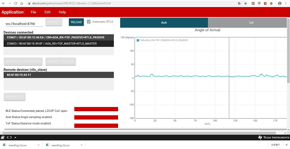

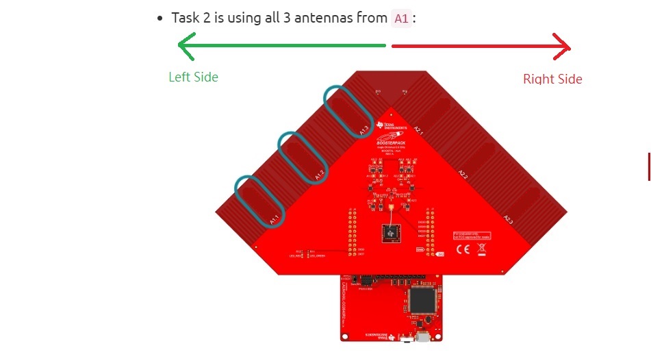

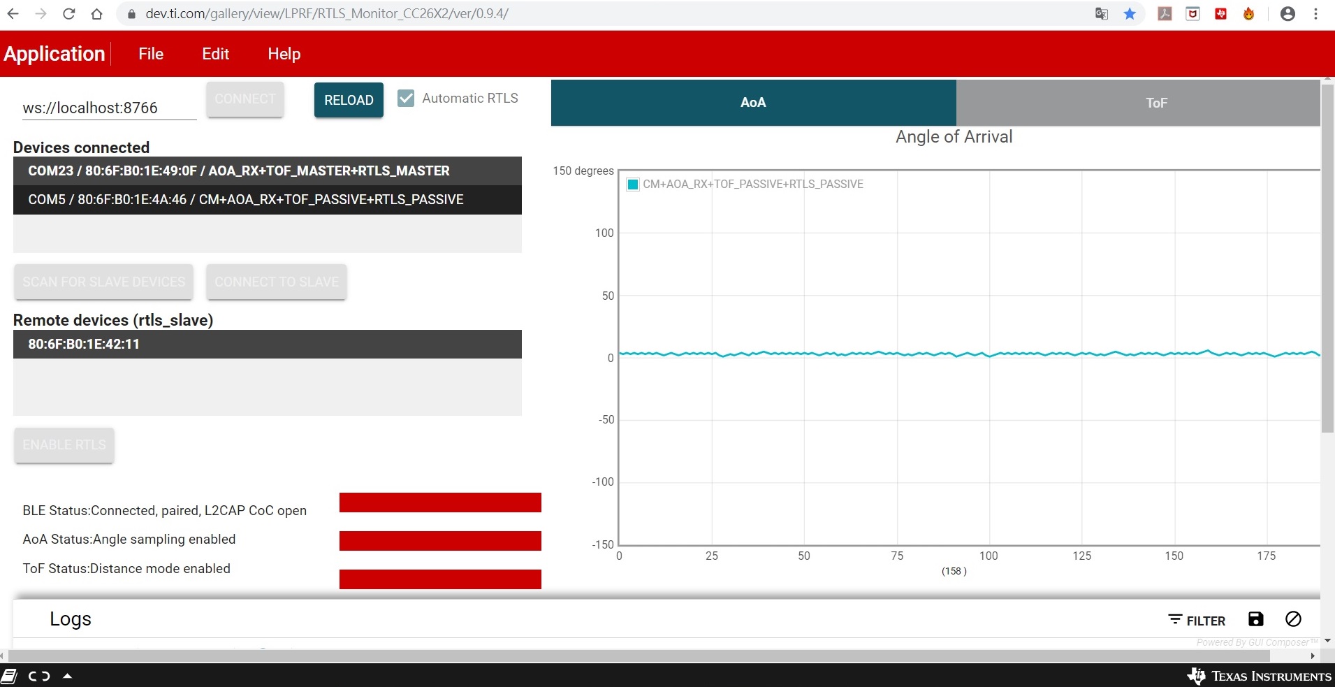

    Case 1, Task 2 – Modify AoA application to use only one antenna array
    Result: Only Left Side ,the angle is stable ,but Right Side the angle is unstable
    Case 2, Task 3 – Modify AoA application to use only two antennas
    Result: whatever change slave position, the the measuring angle isn't change (the value about 6 angle)

    Glad to see that you are getting results.
    Q1: If you compare the code for "Array 1 only" vs "Array 2 only", then what are the differences? Regarding IOID_27, is it stable (i.e. always HIGH or LOW) in both cases? What about the switching pattern of the antennas (IOID_28, IOID_29, IOID_30)? Is it correct in both cases? If nothing in the SW can explain the differences, then it is an HW problem. Can you try using another AOA_BOOSTERPACK if so?
    Q2: Once again, verify which antennas are effectively active. You can try to activate another pair of antennas to see if the results are different.
    Q3: In fact the number of antennas / antennas-array to use must be driven by your needs and your possibilities. Having more than one antenna array is absolutely necessary if you want to measure more than 180 degrees angles. For a given number of antennas-arrays, having multiple antennas (i.e. more than two) increase the accuracy of the results (if you have more measures then you can filter the results).

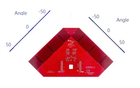

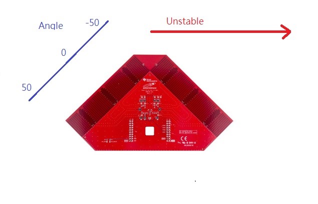

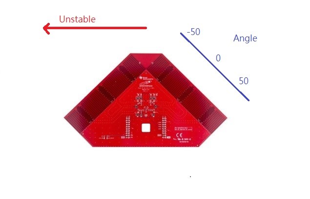

    Case (2). Modify AoA application to use only one antenna array - antennas-array A1
                    Only Left Side (A1 Array Side),the angle is stable ,but Right Side the angle is unstable
    Case (3). Modify AoA application to use only one antenna array - antennas-array A2
                    Only Right Side (A2 Array Side),the angle is stable ,but Left Side the angle is unstable
    (Only antennas-array A2) ,I move slave device position from (angle) -50 -> 0 -> 50 then back 50 -> 0 -> -50 ,

    I am not sure to well understand: in case 2 and case 3, do you mean that the angle is stable on the side where the antennas-array is activated and unstable on the side where the antennas-array is deactivated?

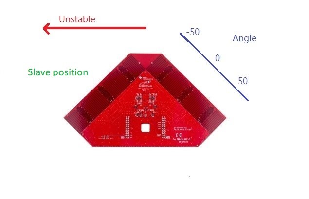

     A2 array is activated , ( A1 array is deactivated)
    (1)  put slave device in right side,as below picture position.
    result:
    log:
    0000.csv
    (2)  put slave device in left side,as below picture position.
    result:
    log:
    11111.csv
    Once again, I am sorry, I don't understand your problem.
    I don't understand why you are placing the slave on the deactivated side.
    Understand, Modify AoA application to use only one antenna array , The behavior is correct. If use only antenna array ,the other side isn't support.

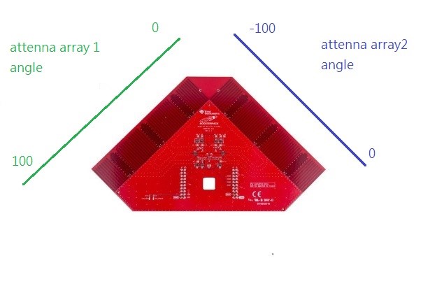

    If I want to demo two antenna array ,
    I use the default code , antenna array 1 responsible for left side,antenna array 2 responsible for right side,
    the behavior should be as below picture?

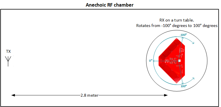

    The position of the 0 and the direction of the angle can completely be decided at the application's level or at the GUI's level (you basically need to add an offset to the computed value).
    With that said, by default, the settings are the following:
    - out-of-the-box, using the two antennas-array please see (dev.ti.com/.../landing_page_index.html), section "AoA Performance".
    - if only one antenna is activated, then it's as you described:
    I hope this will help,
    As you said, by default, the settings are the following:
    but I use 3.20.00.68 ( rtls_master,rtls_slave,rtls_passive) build default code, test result is
    How can I add an offset to the computed value,let the result as below?

    The easiest solution seems to basically do something following this pseudo code:
    if(value > 100) {
        /* No modification required */
        return value;
    else{
        return (-100 - value);
    This code can be added on the master/passive side or on the GUI side.

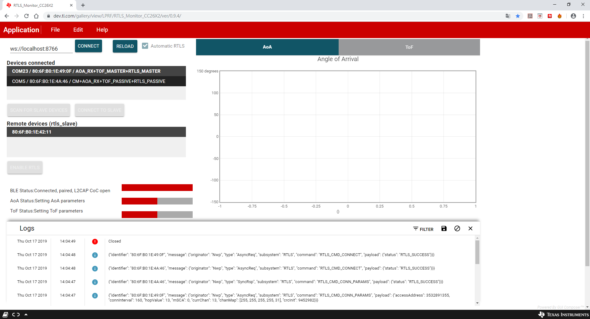

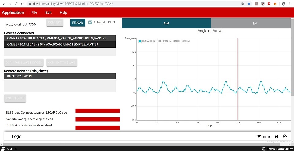

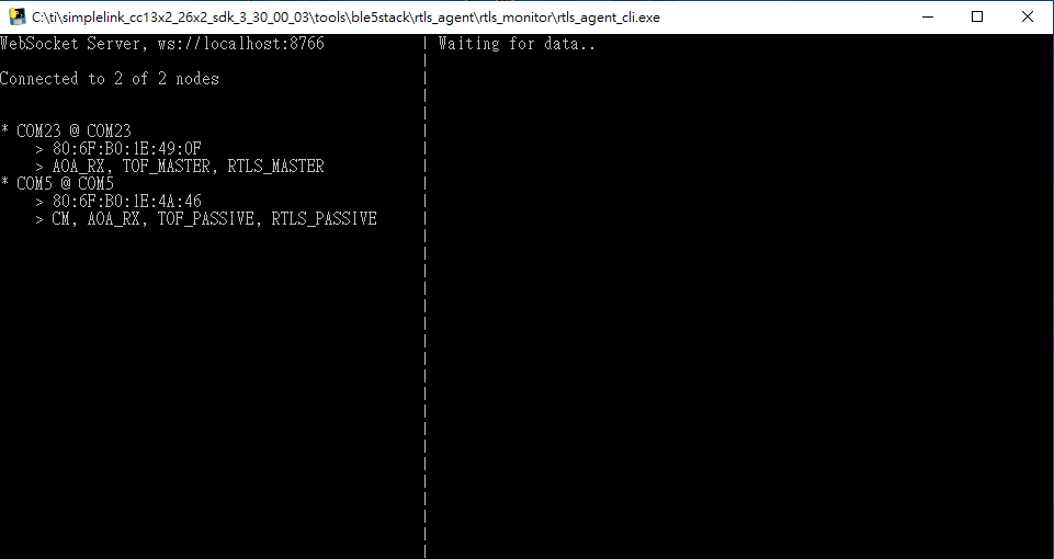

    I try to use the newest SDK: simplelink_cc13x2_26x2_sdk_3_30_00_03
    but it isn't work
    HW:CC2642R1/CC2552R1 Development Kit(2652) Rev:B x 3 , BOOSTXL-AOA x 1
    SW: SimpleLink CC12x2 26x2 SDK - simplelink_cc13x2_26x2_sdk_3_30_00_03
            C:\ti\simplelink_cc13x2_26x2_sdk_3_30_00_03\tools\ble5stack\rtls_agent\rtls_monitor\rtls_agent_cli.exe
            "dev.ti.com/.../"
    rtls_master,rtls_slave,rtls_passive build 3.30.00.03 default code ,flash by uniflash
    result:
    eventlog:
    6428.eventlog (1).csv

    The problem you are running into is due to the GUI you are using (0.9.4). Please use version the GUI version 0.9.5 for CC26x2. The GUI might not be released yet, but it will be soon.
    In the meantime, and regarding your other requirements, I would recommend you to have look to the other python scripts enclosed in your SDK (in rtls_agent\examples). For example, the script rtls_aoa_iq_with_rtls_util_export_into_csv.py will show you how to record the data in a csv file.
