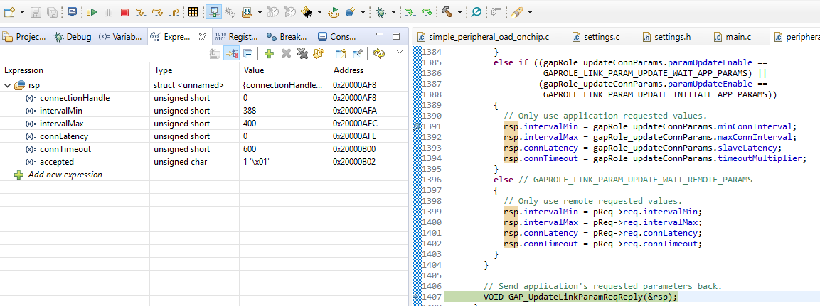

Simple_peripheral receives GAP_UPDATE_LINK_PARAM_REQ_EVENT in gapRole_processGAPMsg @ peripheral.c and checks gapRole_updateConnParams.paramUpdateEnable variable. This variable is set to GAPROLE_LINK_PARAM_UPDATE_INITIATE_APP_PARAMS by the  customer. Due to this the simple_peripheral go to this code and replys with local connection interval:
          else if ((gapRole_updateConnParams.paramUpdateEnable ==
                    GAPROLE_LINK_PARAM_UPDATE_WAIT_APP_PARAMS) ||
                    GAPROLE_LINK_PARAM_UPDATE_INITIATE_APP_PARAMS))
            // Only use application requested values.
            rsp.intervalMin = gapRole_updateConnParams.minConnInterval;
            rsp.intervalMax = gapRole_updateConnParams.maxConnInterval;
            rsp.connLatency = gapRole_updateConnParams.slaveLatency;
            rsp.connTimeout = gapRole_updateConnParams.timeoutMultiplier;
I saw that 500ms interval (value 400) passed GAP_UpdateLinkParamReqReply function.

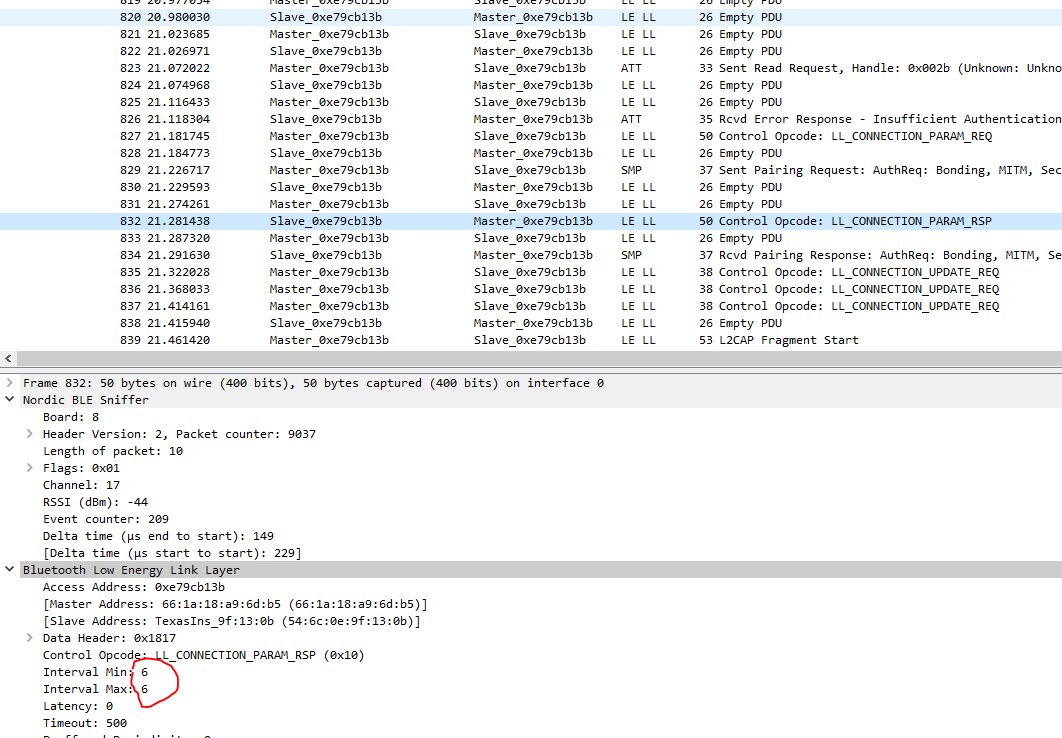

But when we look to a sniffer logs, the actual reply on the air is with 7.5ms interval:
Is this a bug? Why app answers with 7.5ms interval while we pass 500ms interval to GAP_UpdateLinkParamReqReply?

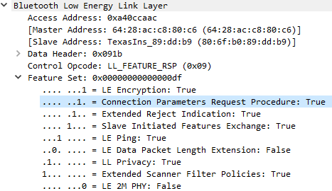

    Marie, are you wondered in the Connection Parameters Update Procedure support?
    Slave device support it as shown in Feature response:

    I checked with reading simpleProfile char5 by android phone. The char5 requires authentication, and android automatically start con param update procedure. As you can see - the device response with remote parameters instead of local ones.
