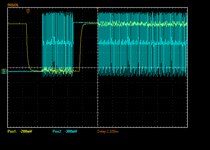

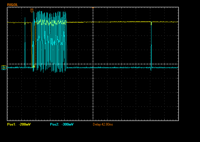

    Below are a couple screen captures of the programming event. The first second image is a closer look of the first image. First image is 10 ms/div and second image is 500 us/div, both are 1 v/div. Channel 1 (yellow) is the reset line and channel 2 (green) is the TCK. The scope was set to trigger off of the falling edge of the reset line. You can see there is still activity after the last reset. Any idea on what it could be doing after the last reset? Where would I look for what is controlling what the programmer is doing during the programming sequence?
    Mike

    It should not be any activity on the TCK-line after the final reset. This can cause the JTAG-domain to wake up. What type of programmer/debugger are you using?
    -Simon

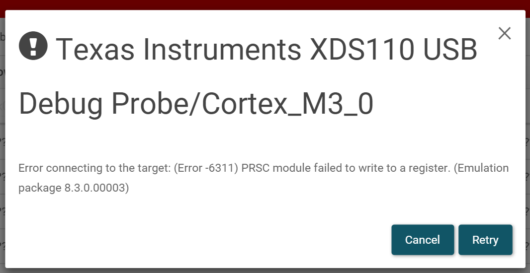

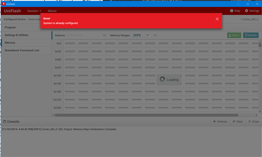

    I see the same result with both CCS and Flash Programmer. I see the continued clock cycles on the TCK pin after the last reset pulse occurs. I downloaded and attempted Uniflash. I can not get it to connect to the board but I can get Flash Programmer 2 to connect and program. Uniflash just gives me this error:
    I attempted to run the re-sync to see if it would help and now whenever I do anything that tries to connect to the device I get this error:
    I'm not sure what is going on with Uniflash but it has created a completely different set of problems and doesn't resolve the initial issue.
    Any other thoughts?
