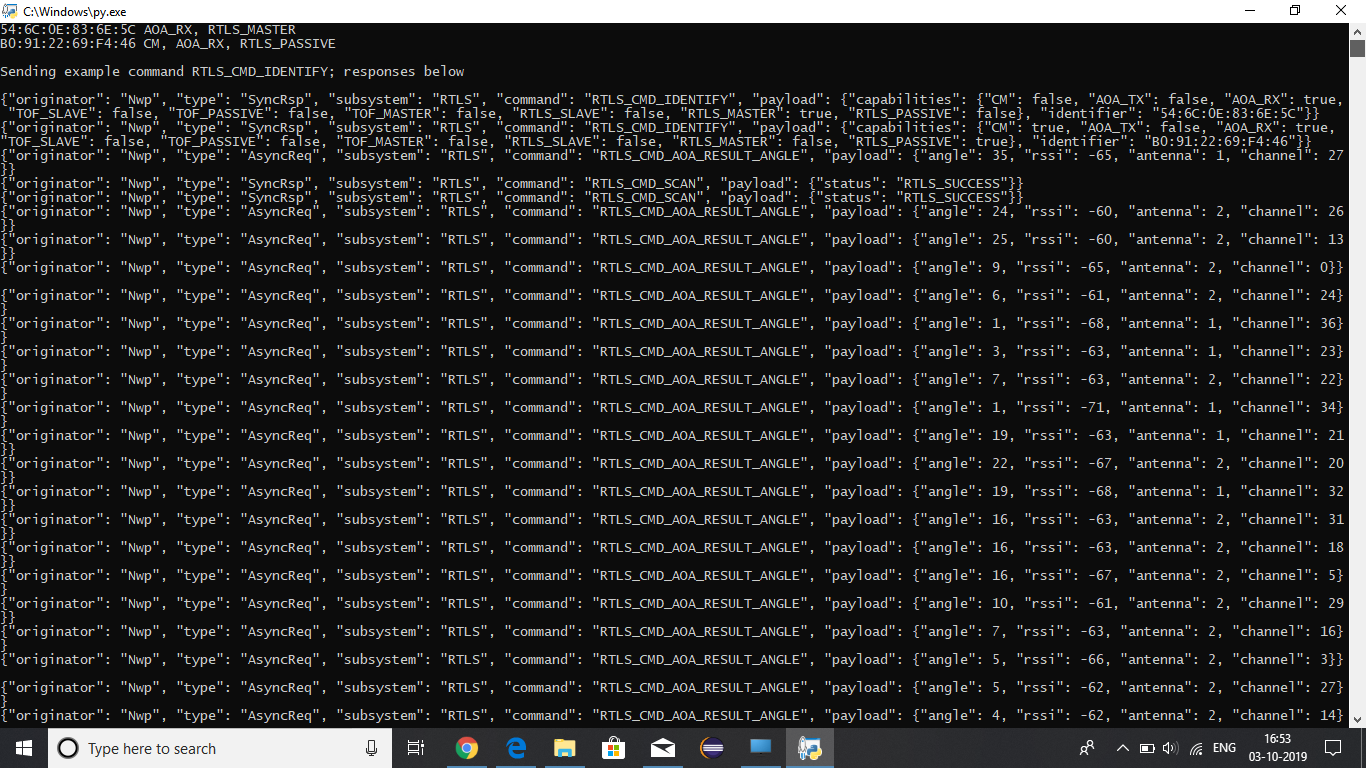

    I am not using RTLS monitor and python script at the same time.
    I checked that Academy link and made the mentioned modifications regarding editing COM port of master and passive in rtls_example.py.
    I run firstly the rtls_example.py file and got the angle values on cmd prompt window later i run the rtls_aoa_iq_log.py file and got the .csv file in the same folder but that file is empty.

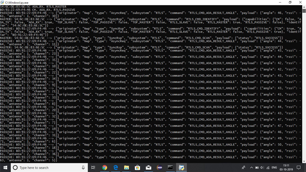

  •  Hi,
    I have attached the output of rtls_aoa_iq_log.py script.

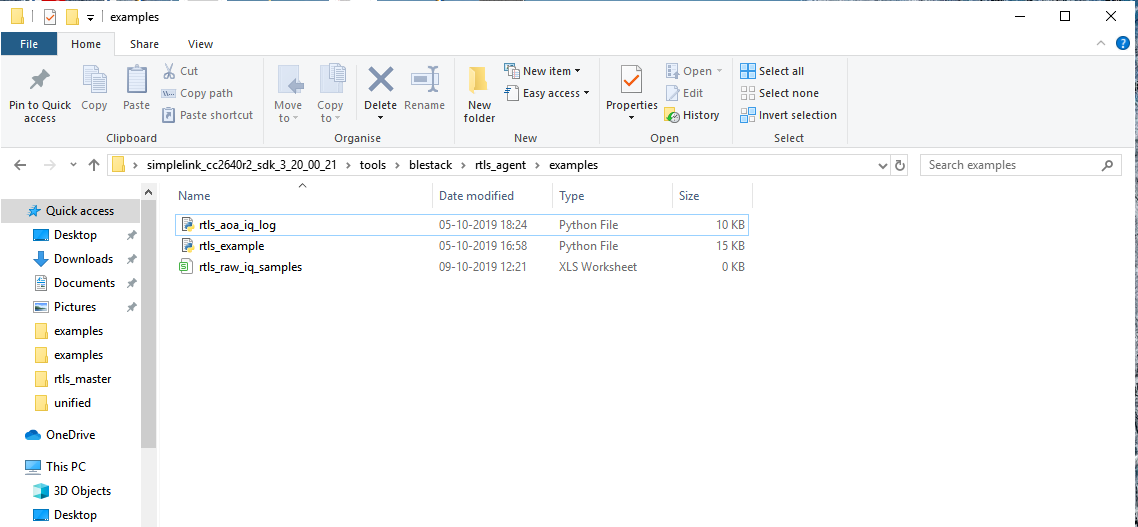

    .csv file is obtained in the same folder of python files
    Akansha

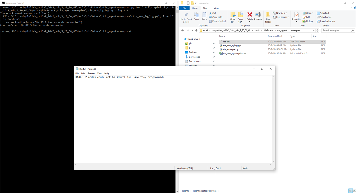

    Thanks for taking time to clarify.
    - Now, it would be interesting to have a look to the log/debug messages provided by your script. Can you redirect the messages printed into a file and produce a screenshot as the one I produced below? (as I am not in the office, I basically launched the script without attaching any LaunchPad to my computer, so obviously it crashed...)
    - Maybe obvious, but can you confirm you are using the Virtual Environment?

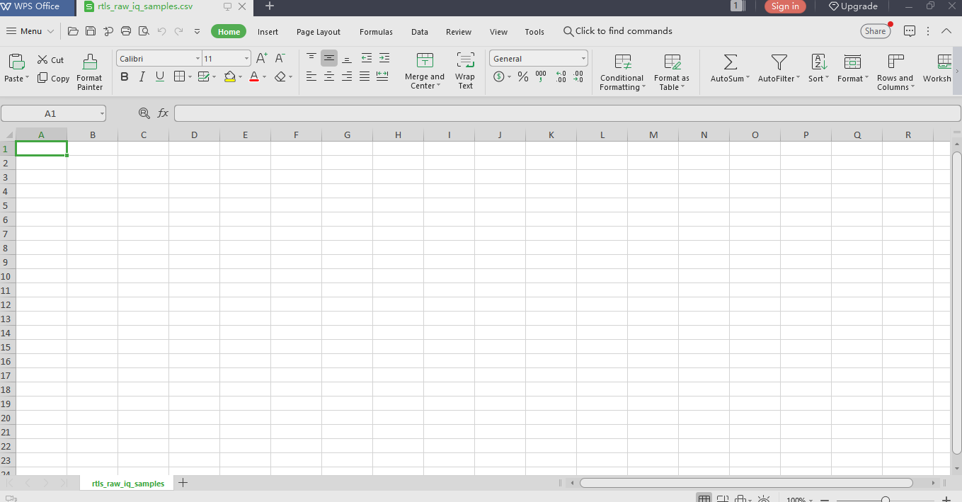

    - Can you precise if the .csv file is completely empty? (i.e. is the very first line completely empty or does it contain "pkt" "sample_idx" "rssi" "ant_array" "channel" "i" "q")
    I have attached .csv file, example folder screenshot, output of python script.
    I have created the virtual python environment in rtls_agent folder.
    .csv file obtained is completely empty as can be seen from file attached.
