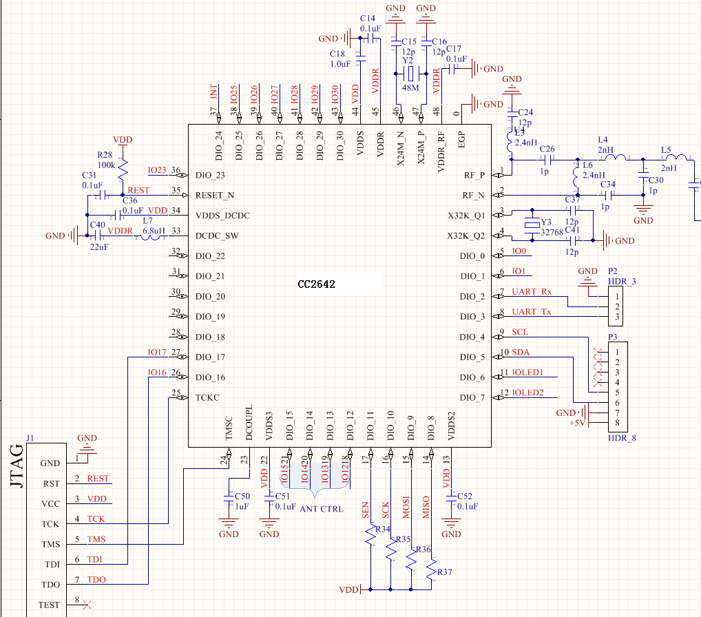

We are trying to switch from CC2640 to 2642... we designed our own board (as below) and debug project with CCS + XDS200 probe.
2 things we have met:
1,  with respect to AOA passive project demo (from SDK), UART baud rate is measured only 38400, which is 1/3 of 115200 as desired. Other project demo (from SDK) doesn't seem to have this issue.

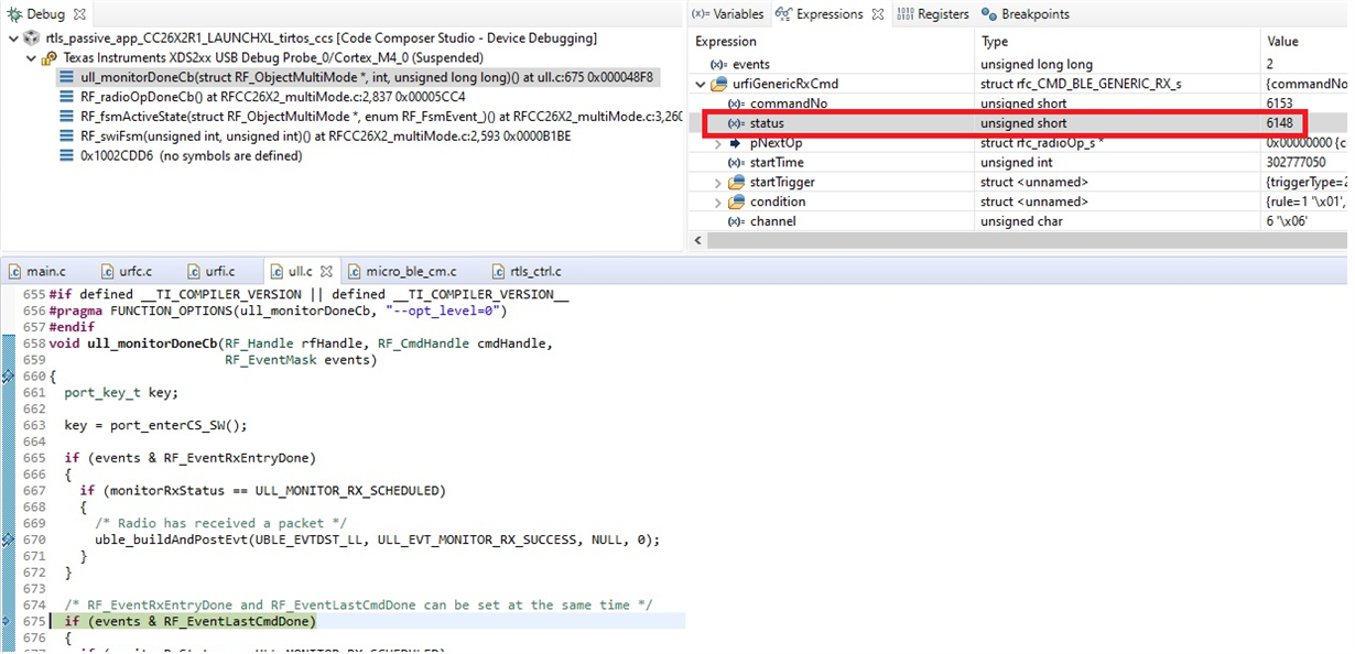

2, project was not able to receive AOA data. CCS break-point debug indicates RF status error of SYN_PROG_ERR (as below).
I checked VDDR, it is around 1.67V range. The 48M crystal is 2-pin passive component (No GND Pin), do i have to use 4-pin package instead?
Please let me know if there is anything i can try to solve this.

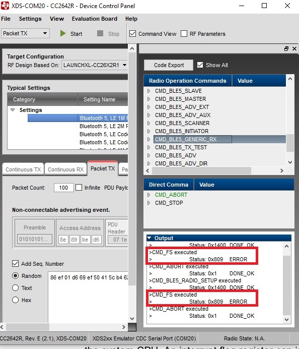

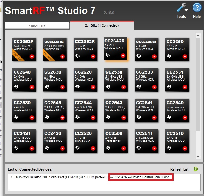

    I think my device is rev E from the marks "CC2642R1F TI 965 E", but Smart RF Studio recognizes as "CC2642" and reports error of 0x0809.

    Just tried 3 projects... yes both empty & uart echo works fine while rfCarrier (step debug info) reports status error of 0x0809 then 0x0808.

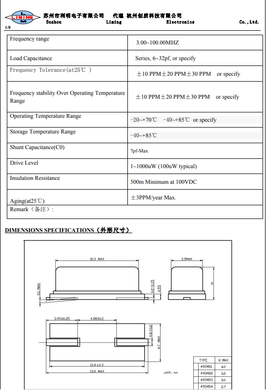

    Below is the 48M spec on my board. If the 48M is not good enough, i will try to replace it to another vendor.
  • What is the ESR of this xtal? If you look on the 48 MHz part of the "clock specifications part" of the datasheet it's listed the required spec of the xtal.
  • hi TER,
    thanks again for your kind support and quick response.
    Just confirmed the 48M is the criminal. I measured it by spectrum analyzer, found it actually oscillates at 16Mhz (though marks 48M part number on top).
