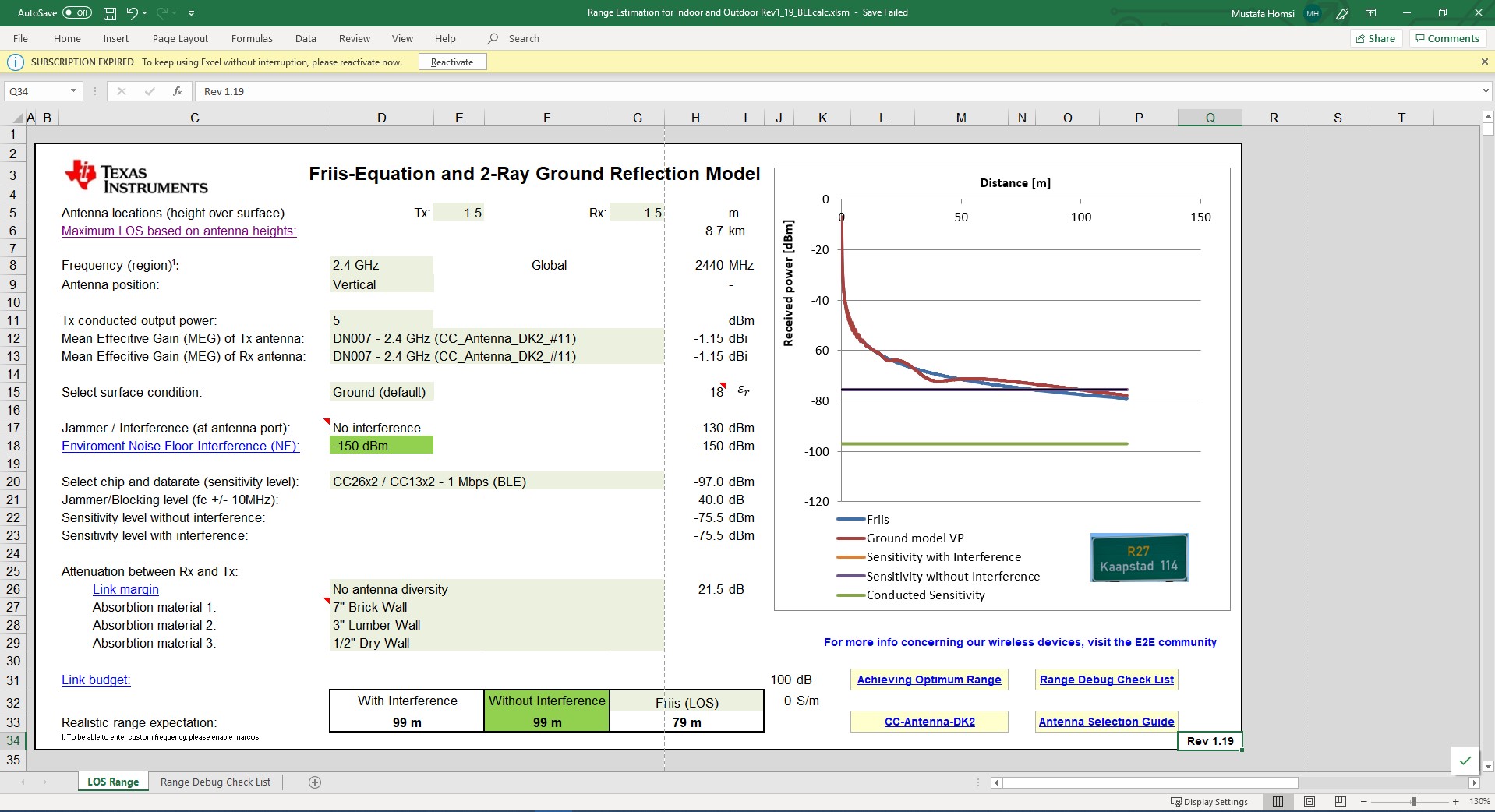

I am testing your BoostXL AoA board with the CC26x2 launchpad using the RTLS demo. However, when one of the devices is moved into a room, or behind any wall it almost immediately loses connection, regardless of the distance. Is there anything we can do to prevent this from occurring?

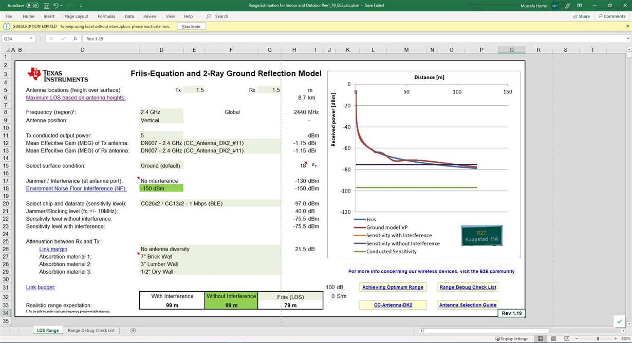

  • According to TI RF Range Estimator document listed on the LAUNCHXL-CC26X2R1 website, we still should get a reasonable range even through walls (attached the calculator for reference).
    I agree that walls are going to degrade the signal strength but the LAUNCHXL-CC26X2R1 has enough link budget (~100dB) to afford penetrating multiple walls depending on the materials as shown by the calculator. The link budget calculated as 5dBm Tx output power, -2.30dBi Tx+RX DN007 antenna gain and -97dBm Rx sensitivity at 1Mbps data rate which can even be improved by going down to 125kpbs. A dry wall on the other hand will roughly degrade the signal by about 1dB and a brick wall will degrade it by about 8dB.
    Based on this I believe the device should still measure the distance through wall using ToF or/and AoA. Please let me know if I am missing something here. Thanks!
