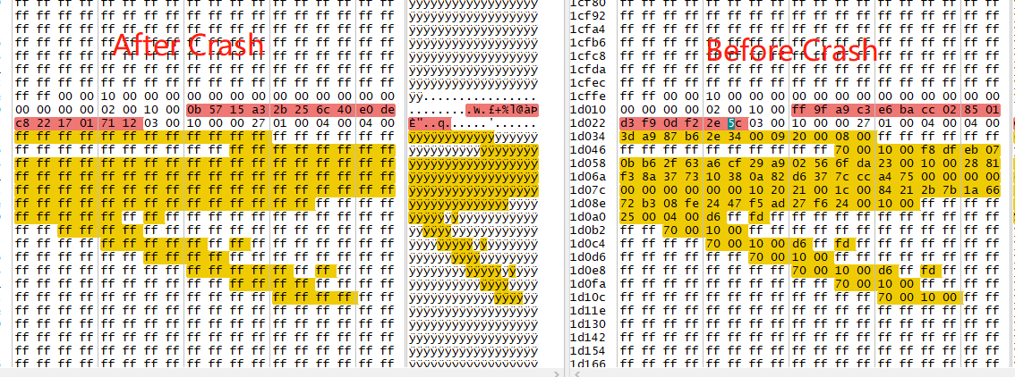

CC2640R2F-Q1: Came across an exception, and then the board is reset (due to watchdog enabled), I found the SNV part on flash is initialized, all bond info erased
Part Number: CC2640R2F-Q1
Other Parts Discussed in Thread: CC2640R2F, BLE-STACK
Platform: CC2640R2F
SDK: simplelink_cc2640r2_sdk_3_10_00_15
APP: private app base on simple peripheral + sdi task
I'm running stress test (connect/disconnect) for my private app, after hundreds of times, exception occur.
Since I have enabled watchdog, the board was then reset. But after that, all bonding info are missing. I tried to dump the whole flash, and found the SNV part looks like been initialized.
In my opinion, even exception occurs, the SNV part shall not be initialized since all bond info are there.
My question is, what's the logic to initialize SNV?
Flash dump:
