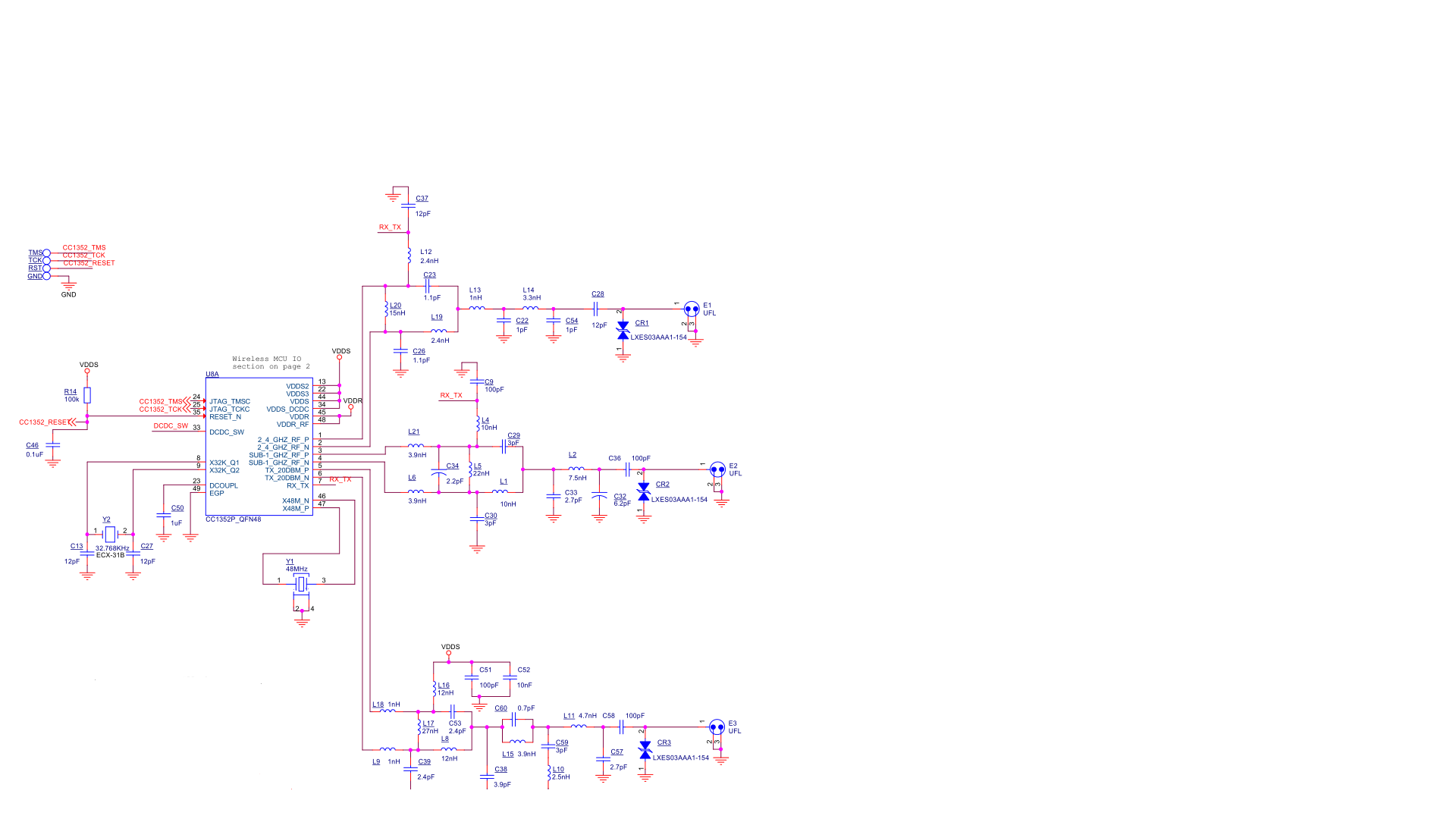

CC1352P: BLE simple peripheral connection problem
Part Number: CC1352P
We are working with CC1352P REV-E  Custom board. WE are using following tools
1. SDK V3.20
2. CCS9.10
3. Btool V1.41.18
We have used simple peripheral example code.
1. Using btool i am trying to communicate with peripheral  we can able to see the advertisement,but i am facing problem in establishing connection, when establishing link it is disconnecting immediately, we could not able to connect.
2. Same code we have flashed in LAUNCHPAD CC1352P REV-E . We can able to read write. with launchpad firmware is working fine.
we know that it could be hardware issue. what could be the reason for it in hardware. I am attaching RF section can you please guide for improving hardware.
