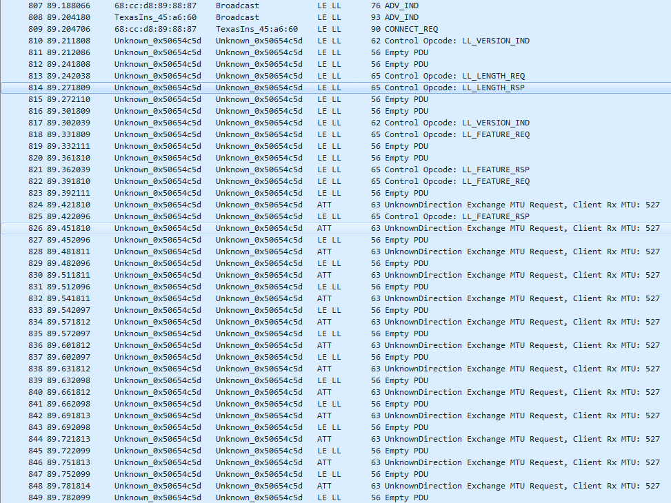

I have mostly successful migrated from CC2640 to CC2640R2 but there is one thing which is not working and I really can't figure out whats wrong so I bought a BLE Sniffer and tried to see what happens.
Situation:
  • Code Composer Studio 9..0
  • Ble Stack 3.20.0.21
  • Simple_Peripheral example as base
Android phones do connect just like they did with the old module even does an older iPhone 6.
I think the iPhone wants to change the MTU size, but I am not sure. Can someone give me a hint or a solution?

  • Hello User,
    Which iPhone phone model and iOS version is this?
    Did you run the Simple_Peripheral example without any modifications?
    The CC2640R2F support max MTU size of 251.

  • Which MTU size did you set on the CC2640R2?
    What happens if you simply connect to the basic Simple_Peripheral example?
    Can you upload the sniffer log?

    I did invest another few days to try to fix the problem. I just started again from beginning and changed the characteristics to mine in the simple peripheral example. The good news is: iPhone and CC2640R2F do now agree to 65 MTU and I do also get the callback with ATT_MTU_UPDATED_EVENT.
    But there is another problem: The iphone sends a request for "GATT Characteristic Declaration" and receives an "attribute not found" error.
    Do you know this error?

  • Dear Eirik
    Sorry for my late reply. I did a complete reset and tried again to make thinks working. The good news: Everything seems to work fine now, the bad one: I can't say what specific error did lead to the behaviour.
    At the end, I think, it was a mix between stack and heap size issues and task synchronisation. I also had to enable "CACHE_AS_RAM" to have enough memory for everything.
