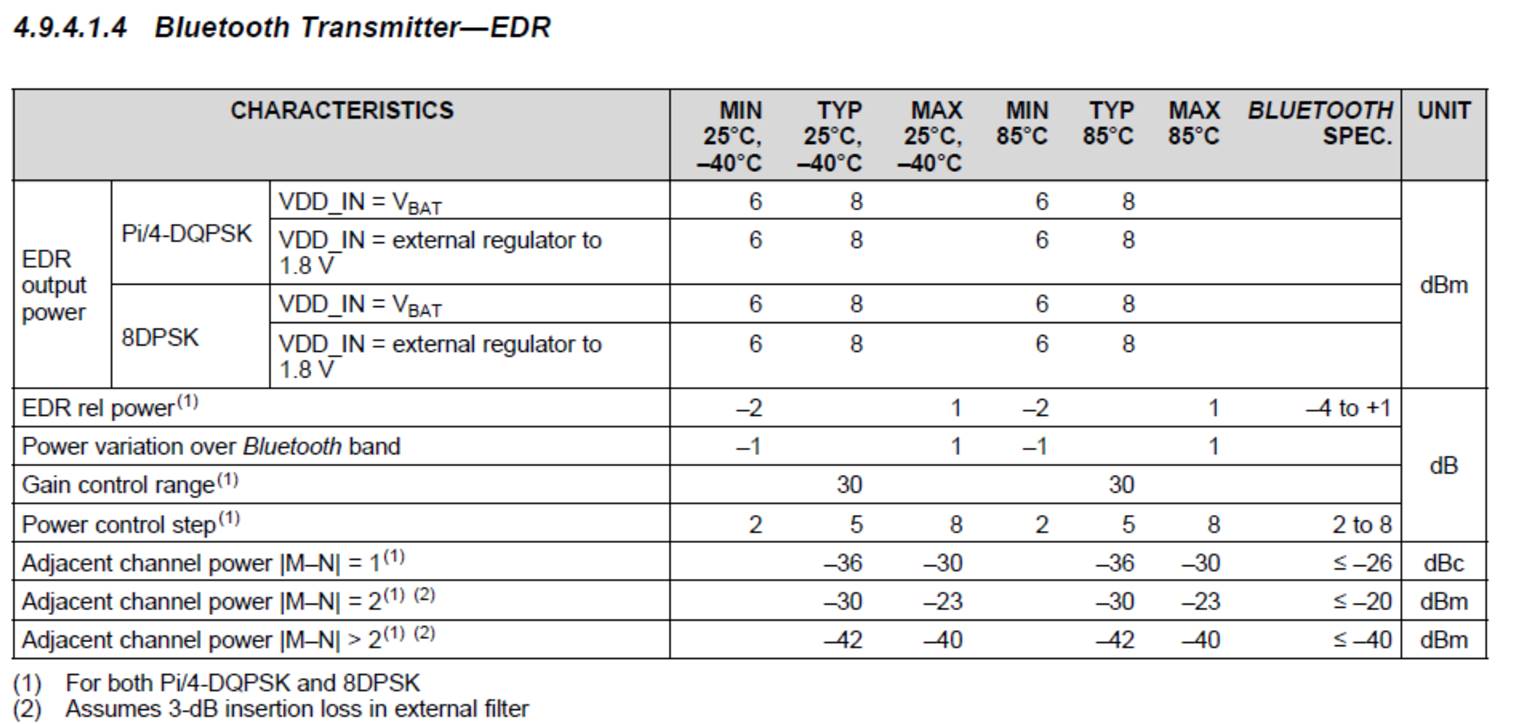

I want to know what is the temperature range  BT HCI module(BL6450CQ automotive)  can be  normal operation behavior.
I did‘t find  min temperature  info from BL6450CQ DS only max temperature 85°...
could you tell me where is be written?
    The temperature range for this device is -40C to 85C. If you look on page 14 for BT Transmitter – EDR characteristics the table shows the  performance characteristics over the temperature range.
