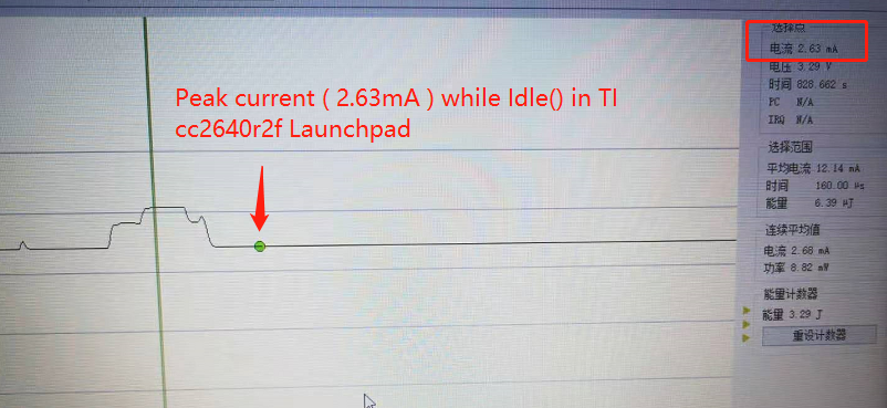

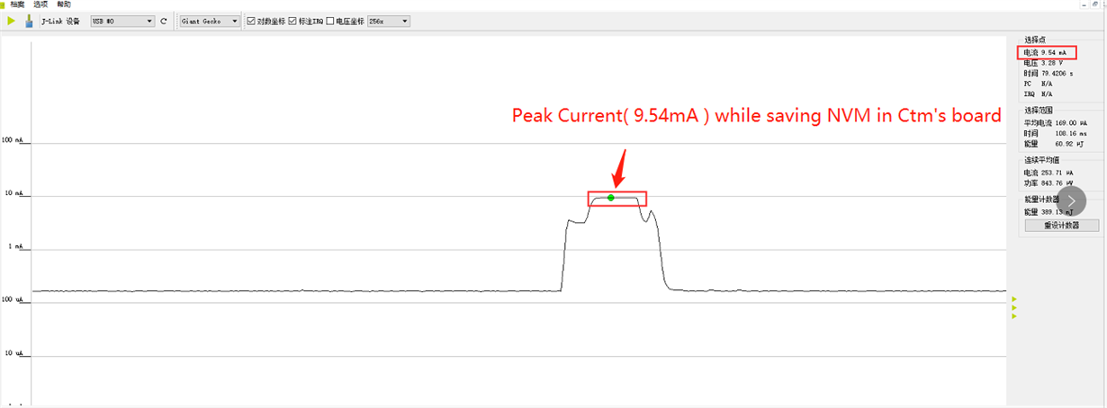

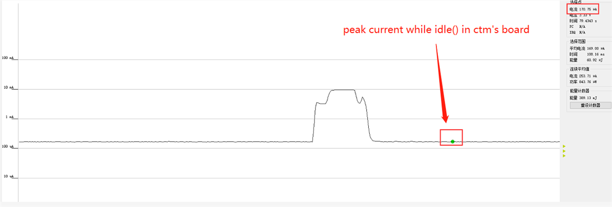

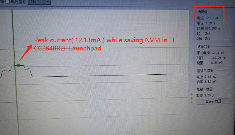

         There is a issue in my ctm : The power consumption while saving NVM will become high and cause CC2640R2F crash (UVLO).
The cc2640r2f board is power by cr2032 battery . After testing .The peak current is above 9mA while saving NVM which will cause that
the supply volage drops below 1.8V. we also try to add 2*47uf capacitor in VCC but the issue still exsits. and we download the same
software in TI cc2640r2f laundchpad and the peak current is the same as Ctm‘s board.
          How can we reduce the peak current while saving NVM?
