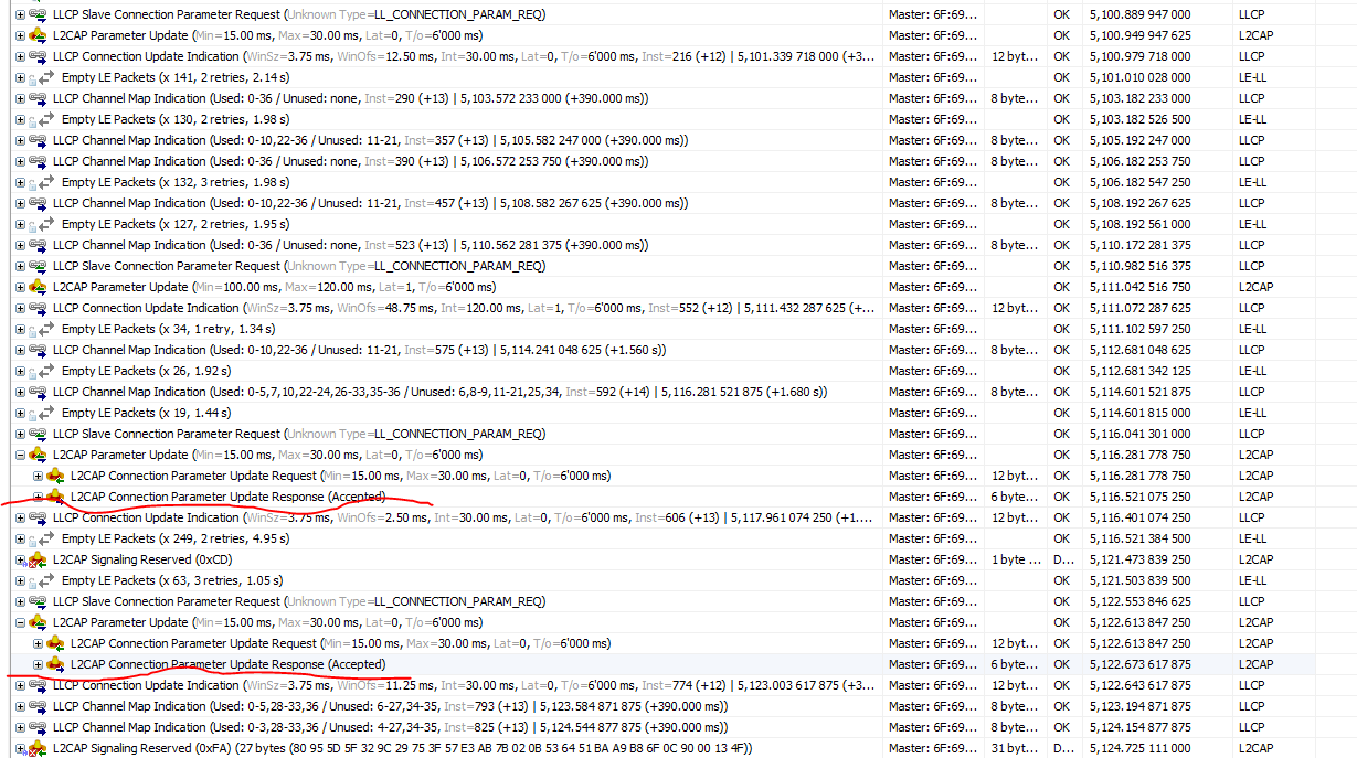

if the parameters are different, function GAP_UpdateLinkParamReq() will return 0(success) and will trigger GAP_LINK_PARAM_UPDATE_EVENT
but if the parameters is the same as previous one, function GAP_UpdateLinkParamReq() will return 0(success), but no GAP_LINK_PARAM_UPDATE_EVENT,
then again to update parameters, function GAP_UpdateLinkParamReq() will return 17(bleAlreadyInRequestedMode), no GAP_LINK_PARAM_UPDATE_EVENT,
then any requirement to update, function GAP_UpdateLinkParamReq() will always return 17(bleAlreadyInRequestedMode), no GAP_LINK_PARAM_UPDATE_EVENT.
Disconnect and re-connect can recover it, but it doesn't  make sense.
BTW, in initiate I changed the timeout to the minimum with GAP_SetParamValue(GAP_PARAM_CONN_PARAM_TIMEOUT, 1), or the GAP_UpdateLinkParamReq()  will be failed if too often.

  • Hi Marie H,
    I was testing the connection parameter update function and find such issue.
    SDK version  is 3.10.00.53.
    My device is a slave and provided user an interface to update connection parameters for power control.
    From the captured log, the second update request was send out successfully and accepted by master, but the no GAP_LINK_PARAM_UPDATE_EVENT. This could be a bug. The bad result is no chance to update connection parameter any more if not cut off the connection

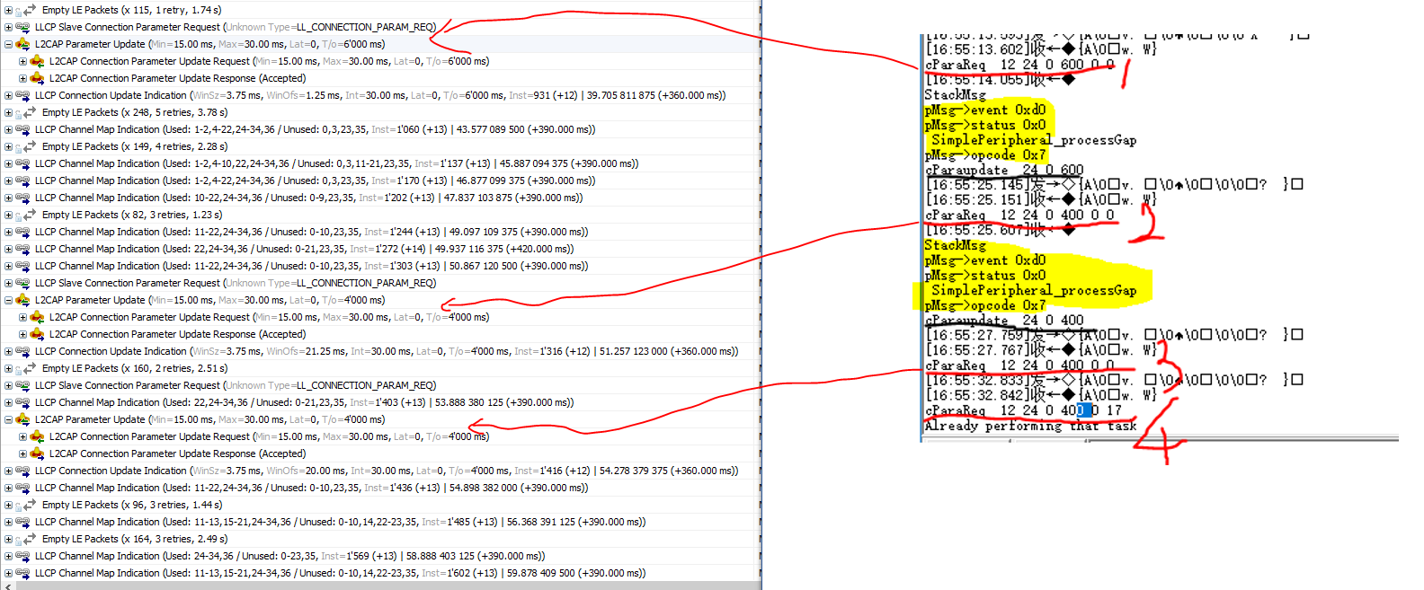

    1. Can you check if you are receiving a HCI event with opCode HCI_LE_CONNECTION_UPDATE and check the status of this one? (E.g. in SimplePeripheral_processStackMsg(), in the HCI_COMMAND_STATUS_EVENT_CODE case, check for HCI_LE_CONNECTION_UPDATE opcode.)
    2. Can you post the log file? (I would like to compare the LL Connection Update packets.)
  • Hi Marie H,
    I've add debug message in SimplePeripheral_processStackMsg(), when the issue happens, there is no any event in stack message.
    the log as below:
  • Hi Fan,

  • Thanks Sage, Fan,
    This is expected behavior. When the only update is in the transmit window offset there is no reason for the controller to tell the host, and thus there is no event passed from the host to the application.
  • Hi Marie H,
    No Event is OK for the same parameters, but the sad truth is this will cause connection parameter mechanism dead. After the second requirement with the same parameters,  GAP_UpdateLinkParamReq() will always return 17(bleAlreadyInRequestedMode), EVEN change the value. This should be unexpected and unacceptable.

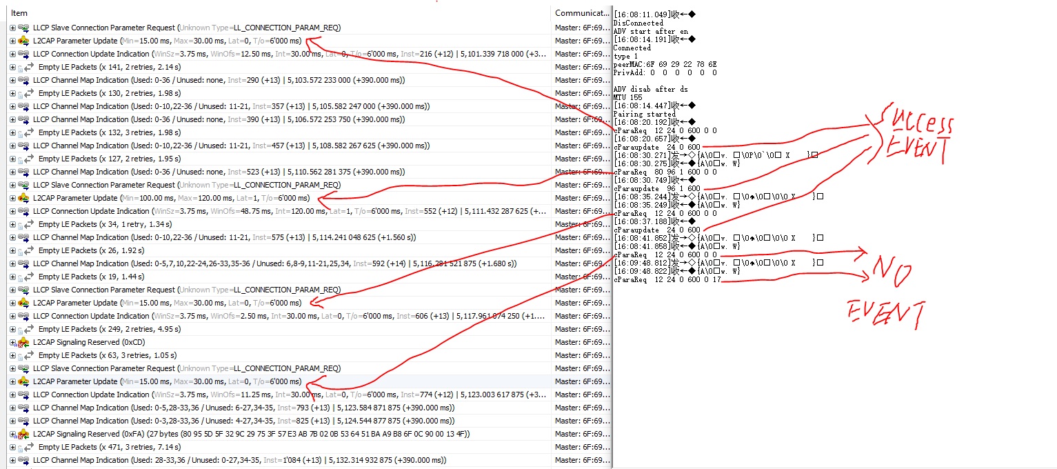

  • Hi Marie,
    Your test procedure should be enough to find out the issue. A master,  support  LL connection parameter update request or not, will not affect the result, I've tested both.
    Please print out the return code of GAP_UpdateLinkParamReq()  each time you pressed the left button, and print out the event status of GAP_LINK_PARAM_UPDATE_EVENT in SimplePeripheral_processGapMessage
  • Hi Fan,
    I just tested again. As you say, when sending multiple GAP_UpdateLinkParamReq() commands with the same parameters I get the 0x11 bleAlreadyInRequestedMode error. However if I change the parameters I am able to send multiple GAP_UpdateLinkParamReq() in the same connection.
  • Hi Marie,
    Great, you can reproduce the issue I faced.
    In the same connection, once 0x11 bleAlreadyInRequestedMode was got, all the following request will be with the same 0x11 error, even parameters was changed.
    This should be a bug and with high potential risk in my application. For in my application, parameter was used to control the power consumption while our application is especially sensitive to power. If the parameter cannot be updated, the power consumption and data transmission cycle will be out of control.
    Or there is was an interface I can use to cancel the previous request if 0x11 was returned, so that I have the chance to request update in the same connection. Though it is not the fundamental solution.
    BTW, we used to use CC2640R2 SDK 1.40.00.45 without such issue.

  • Hi Fan,
    When I send GAP_UpdateLinkParamReq() with a new value each time I always get success. When I send first GAP_UpdateLinkParamReq() with the same parameters a couple of times and then change the parameters I can not get a success status anymore. I have filed this as a bug.
    As a work-around I would suggest:
    a) Always change the parameters after sending a GAP_UpdateLinkParamReq(), even if it's just a small change.
    b) Terminate and re-establish the connection if you get the 0x11 fail status.
