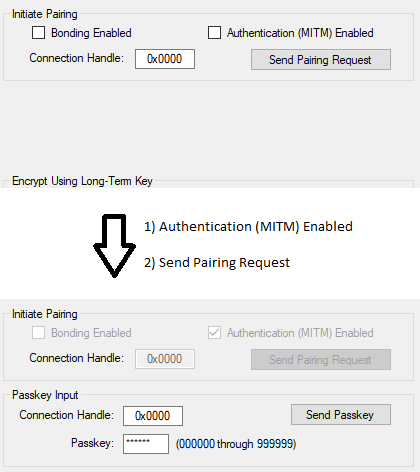

I am following the instructions in SimpleLink Academy (task 3 - simplelink_academy_cc13x2_26x2sdk_3_20_03_00/modules/ble5stack/ble_02_security/ble_02_sec_funds.html) to enable pairing on a CC2652R1LP (running project zero) and a CC2652R1LP running host test using BTool.
The instructions state there should be a passkey box to enter the passcode shown on the project zero terminal. However, I have a blank box between "initiate pairing" and "long term key" as shown below
Is this box only enabled when certain conditions are met?
If I issue a GAPBondMgr_PasscodeRsp message from btool with the required password then projectzero terminal shows that pairing was successful, however btool times out after ~60 seconds with a pairing error and is not usable after that.
Also attached is the btool log showing that there is no GAP_AuthenticationComplete event generated even although project zero says it is successfull
000027 [ 23.766 ] INFO: (project_zero.c:1726) Updated params for F0:F8:F2:D2:B7:68, interval: 45.0 ms, latency: 0, timeout: 2000 ms
#000028 [ 29.447 ] INFO: (project_zero.c:1500) Pairing started
#000029 [ 29.447 ] INFO: (project_zero.c:1500) Pairing started
#000030 [ 29.447 ] INFO: (project_zero.c:1552) BondMgr Requested passcode. We are Displaying passcode 123456
#000031 [ 42.992 ] INFO: (project_zero.c:1506) Pairing success
I suspect I am missing something but think I have followed the simplelink academy instructions.

    Have you tried to click the "Send Pairing Request" button in the "Pairing Bonding" tab  (after link established)?
    The "Passkey Input" box is dependent on this request event:
    Vetle
  • Hi Vetle,
    Sorry for the delay. I was fighting more fundamental problems with the project than pairing.
    I still cannot get the Pass Key box up. I do the steps:
    1.Set Pairing mode to initiate

    There is no authentication event after this. Is this required to trigger the pass key request?
    Iain
    In your initiator(BTool), you need to set your IO capability to Keyboard only instead of no input no output.
    When you set one device to have display but the other device has no input no output capability, then just work will be chosen based on the figure 84 in the following chapter in user's guide.
    For more information, please take a look at the software user's guide.
    http://dev.ti.com/tirex/content/simplelink_cc13x2_26x2_sdk_3_30_00_03/docs/ble5stack/ble_user_guide/html/ble-stack-5.x/gapbondmngr.html#selection-of-pairing-method
  • Hi Christin,
    Thanks for the follow up. It appears that the step of setting IO to keypad is missing from the SLA instructions.
    Iain
