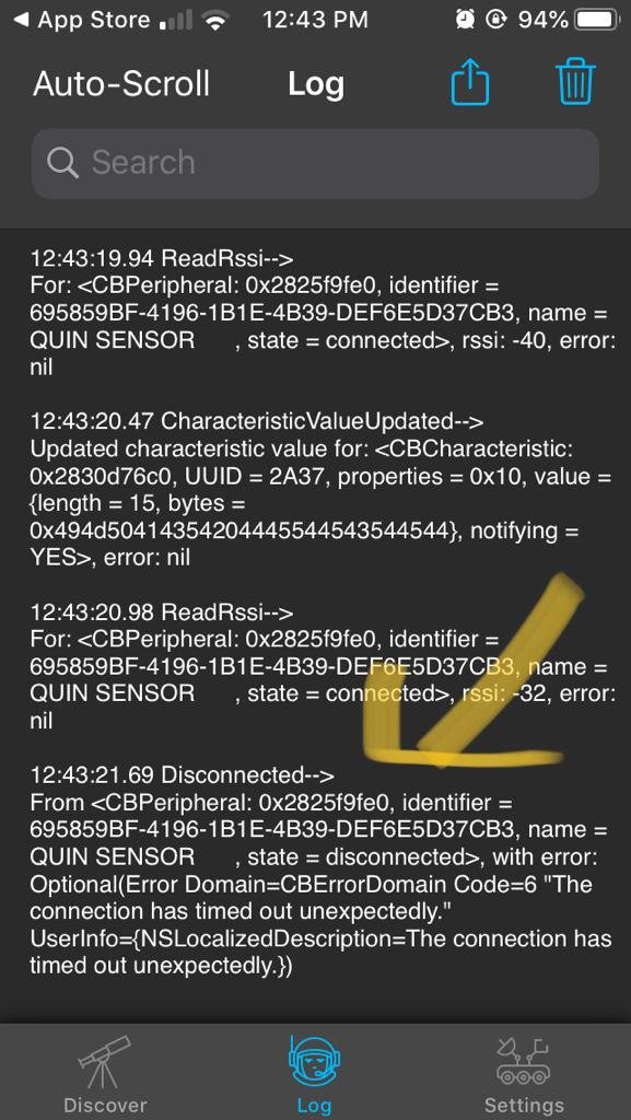

Hi Team,
We tested our setup with android and as well as IOS.
TESTING WITH ANDROID:  getting connected and working fine with android device.
TESTING WITH IOS: getting disconnected immediatly after connecting with IOS device .Could not debug the exact problem.Can you please help me out here.

    Please refer the below attached image for the error we are getting while testing with ios device.

  • Hi Elin,
     The code looks stable with android device now, but could not get the same stability with ios device. What could be the reason for this !
    When testing with ios device , we get "error: The connection has timed out unexpectedly".
    Assuming it could be issue with connection parameters, have changed them and checked for stability but could not achieve it.
    If it is issue with connection parameters,Can you please suggest me the exact parameters which gives stability both with android device and also ios device.
    If not, what are the reasons for this specific issue!

  • Hi Elin,
    Disconnect issue using,
    Android device : got resolved, could get stability
    IOS device : still issue exists,but far better than before.
    This is achieved by handling interrupts properly in the code. Disabling the specific interrupt when it is in ISR and enabling it when the periodic task gets executed.
    ISR()
    //Disable the interrupts
    //flag=true to trigger the Task()
    Task()
    //check for the flag
    //if flag is true, send message through BLE
     //clear pending interrupts
    //Enable the interrupts
    By this implementation,we could achieve the stability. Please, let me know if any better option to resolve this specific issue.
