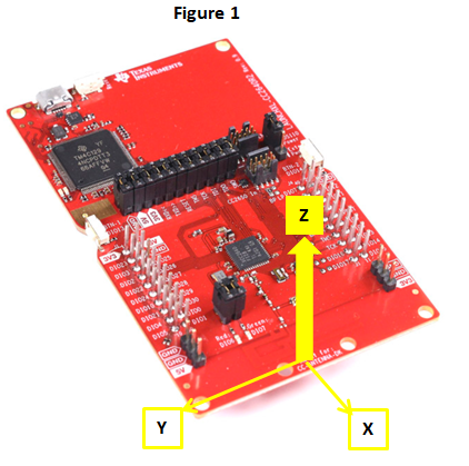

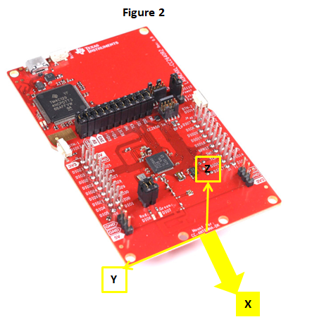

Part Number: LAUNCHXL-CC2640R2
I am using LANUCH-CC2640R2
I have question
1. In this board mount Inverted F-Antenna 2440 MHz, right ?
2. How much gain of antenna ?
Thank you
Hi
The CC2640R2 uses a inverted-f antenna tuned for 2.4 GHz. Information about this antenna can be found here: http://www.ti.com/lit/pdf/SWRU120. The maximum gain when used on the reference board is measured to be +3.3 dBi,
