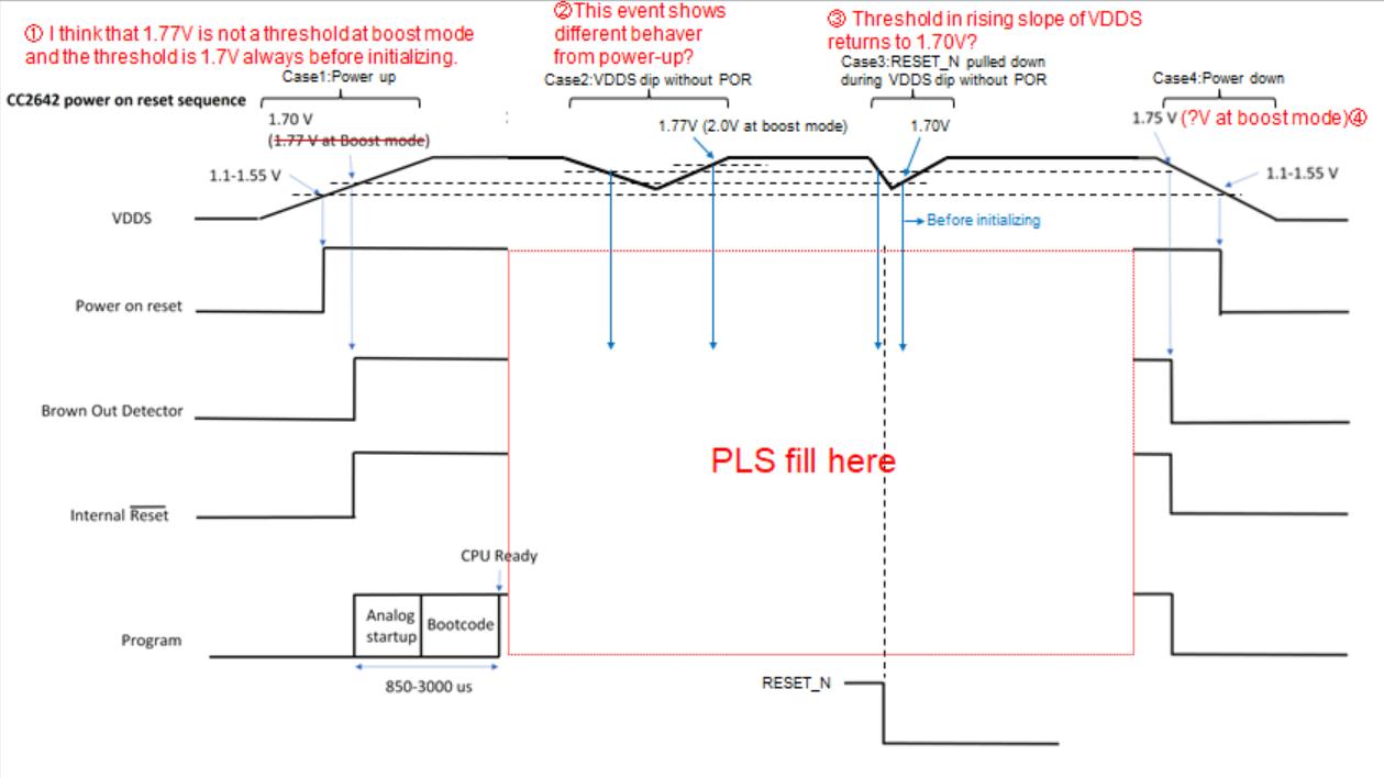

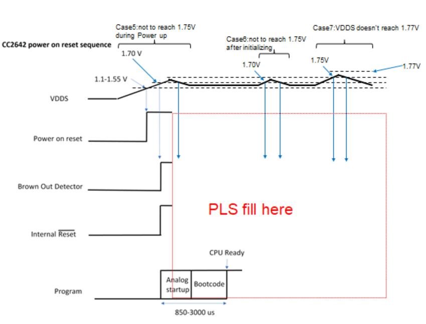

Hi.
CC2642 has power on reset.
Could you tell me the power on reset sequence and ansewer the following questions.
1. Is there any restriction on the timing of VDD ON to reset release?
2. 48MHz oscillation stabilization wait time inside the CC2642 when VDD is ON.
3. Time from VDD ON to software start.
4. When VDD OFF → VDD ON, there are restrictions on time and voltage required for generating power-on clear.
BR Hiroki
