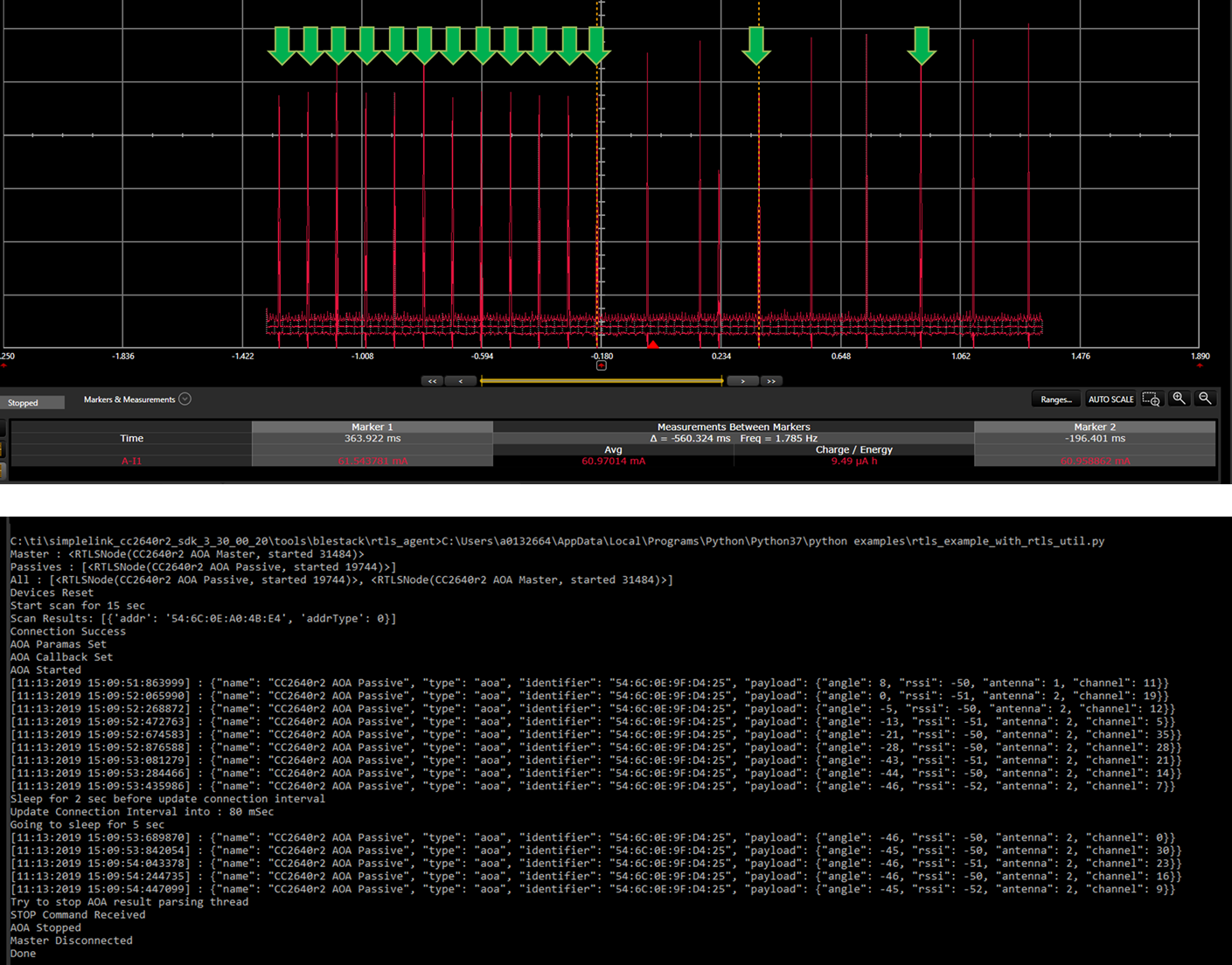

    I have done the described modification (I set DEFAULT_UPDATE_SLAVE_LATENCY to 6). Here is the power profile while running the script rtl_example_with_rtls_util.py (update_conn_interval has been set to true and I kept the other default values):
    I marked the connection events with the green arrows. Before updating the connection interval, there are 100ms between two connection events. After the update, there are 560 ms between two connection events (I set the connection interval to 80 ms and the slave latency to 6: (6+1)x80=560). You will notice some activity in between the green arrows: this is due to the recharge pulses of the device (I guess the definition is too low to see the difference so I ask you to believe me).
    To finish, you can see the passive is still reporting every 0.2 s. I am working to understand why.

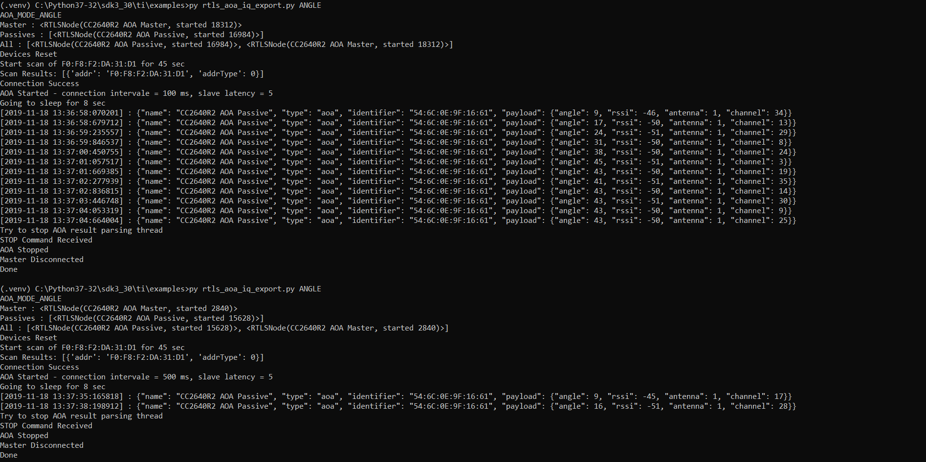

  • Thank you Clément.
    I am mainly using a customized "rtls_aoa_iq_with_rtls_util_export_into_csv.py" script to extract raw data but added support for AOA_MODE_ANGLE.
    To test the slave latency, I updated the TGAP_CONN_EST_LATENCY using DEFAULT_UPDATE_SLAVE_LATENCY in the rtls_master.c as follows:
    // Slave latency to use if automatic parameter update request is enabled
    #define DEFAULT_UPDATE_SLAVE_LATENCY 5
    static void RTLSMaster_processRTLSConnReq(uint8_t *connReq)
      if (state == BLE_STATE_IDLE)
        //Set latency
        uint16_t defaultUpdateSlaveLatency = DEFAULT_UPDATE_SLAVE_LATENCY;
        GAP_SetParamValue(TGAP_CONN_EST_LATENCY, sizeof(uint16_t),
                             &defaultUpdateSlaveLatency);
    The slave latency works as expected however I do not see any issue on the repoting intervale from the receiver?
    In the first run, the connection intervale is as expected i.e. 100 * (1 + 5) = 600 ms
    In the second run, the connection intervale is also as expected, 500 * (1 + 5) = 3000 ms

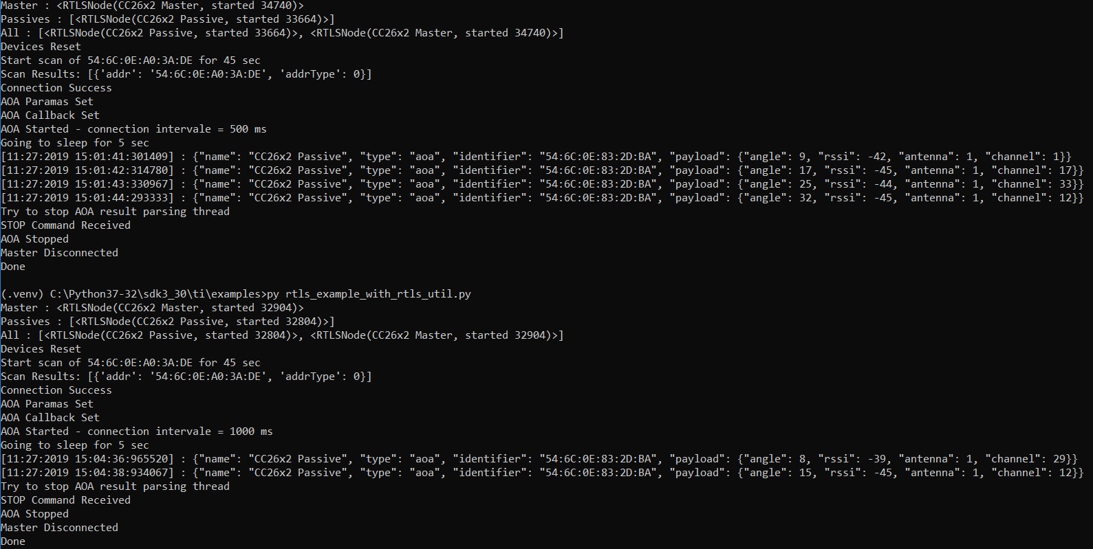

  • Hi Clément,
    How many times are you able to call Rtls_Util.set_connection_interval(connect_interval_mSec)?
    I tried it out by increasing the value of TGAP_CONN_EST_LATENCY with +1 everytime RTLS_PARAM_CONNECTION_INTERVAL is called but after a few times everything stops?

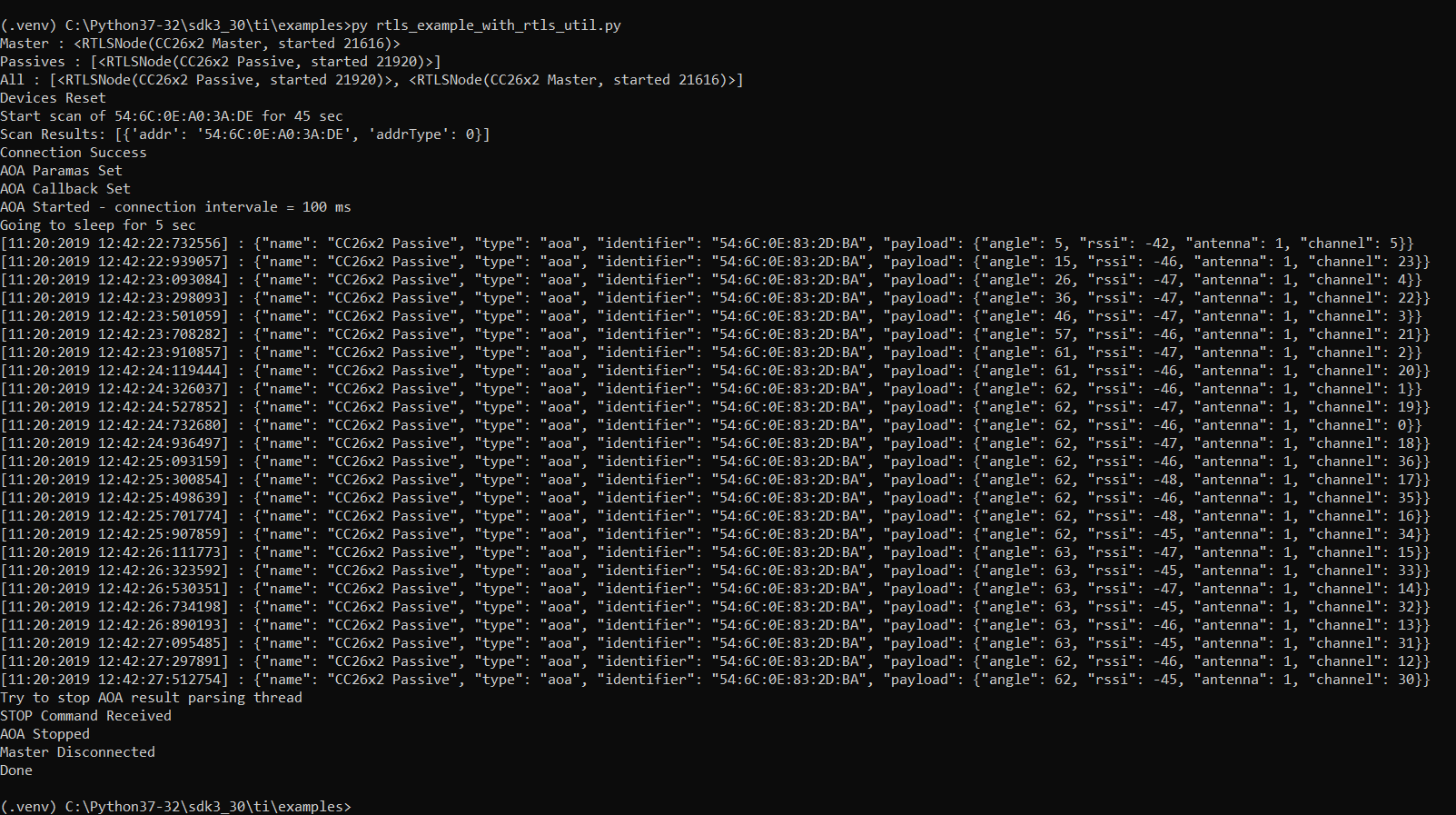

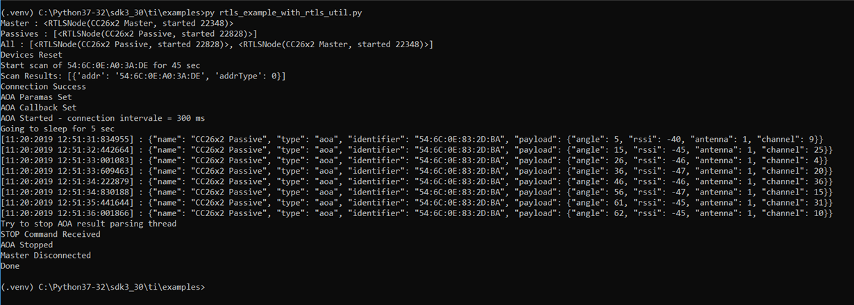

  • Hi Clément,
    Based on my observations, the slave latency only affects the transmitter but not the receiver, which is what I would expect.
    However, the report intervale is not constant but always twice as the connection intervale which indicates that the slave latency is at least 1 and not 0?
    These observation can be done by simply changing the connection intervale in the script for each run.
    Results: connection intervale at 100ms -> 200 ms report intervale
    Results: connection intervale at 300ms -> 600 ms report intervale
    Could you please check with R&D team why the slave latency is 1 by default?
