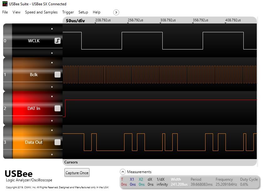

  • I have spent many hours trying to get the I2S function on the CC1310.
    I came across the following in “C:\ti\simplelink_cc13x0_sdk_3_20_00_23\source\ti\drivers\I2S.h”
    The code is shown below:
    This is a Shot of the I2S signals: Here 16 words are being sent out with every other word being the same to write to a D/A.
    I have both the PlayAndStop and the RepeatMode totally functional. The Repeat mode did need some correction in the write ISR, adding the I2s_init() and making the end while like the while in PlayandStop. Compareit to Playand stop and make it the same.
    Somebody at TI could have saved me a lot of time if they had refered this code to me before!
