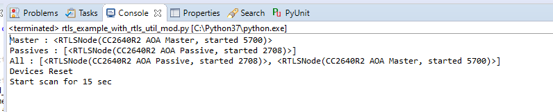

    I apologize for not getting back promptly. I followed your instructions for generating the .c/.h files needed to configure the radio parameters and a placed them in all of the project workspaces. When I first attempted to compile the projects for the slave, master, and passive CC2640 devices, I received an error reporting that the "RF_cmdFs" struct was already defined somewhere else in the program. Hoping that it would not conflict with the other command structures defined in the Smart RF settings files, I commented out all instances of "RF_cmdFs" in the .c/.h files. Once I confirmed that everything compiled without any errors, I flashed all the devices and I then tried to start up the Python script called "rtls_example_with_rtls_util.py." The program hangs and doesn't get past this point:
    On closer inspection, it appears that the master device eventually stops responding altogether (before making this modification, it did work and the program proceeded normally):

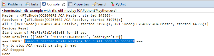

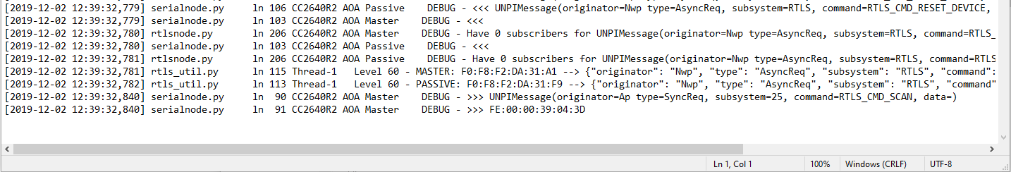

  • In the "rtls_agent" Python application (namely the examples), I discovered that the master device never reports that it successfully pairs when it reaches the "rtlsUtil.ble_connect(slave_bd_addr, connect_interval_mSec)" call. In the console window, I see the following:
    The timeout error was traced back to the "rtls_util.py" file immediately after the "self._master_node.rtls.connect(slave['addrType'], slave['addr'], interval)" line.
    Moving back to CCS: as I mentioned in my recent reply, I made a modification under the "GAP_LINK_ESTABLISHED_EVENT" event section to set the channel map before the master device sends its connection information to the passive device, but it appears that once that happens the master device cannot successfully connect with the slave. In addition to the questions above, I was hoping to ask if there is something else that I am supposed to do to get the slave device and the master to pair using the channel map I want to use? Thank you!
