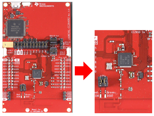

I am starting to design PCB board
I have reference from LAUNCHXL-CC2640R
I need to use the nessary component for bluetooth communication such as CC2640R2F chip, Crystal, Antenna and component that related.
1. Can I use CC2640R2 bluetooth by keeping only nessary component for reducing PCB size as figure below ?
2. What the component can I cut and keep ?
3. please tell us about PCB size that I can use ?
Please advise

  • Hi.
    If you are designing a custom board I recommend you read through CC13xx/CC26xx Hardware Configuration and PCB Design Considerations. In this report, on page 6, you can find reference designs for the different devices. The CC2640EM-CXS is a small design with only the required BLE components that you can base your design on that uses the CC2640R2F device.
    In chapter four of the same document, you can find the recommended board stack-up, which is 1.6 mm.
    Vegard

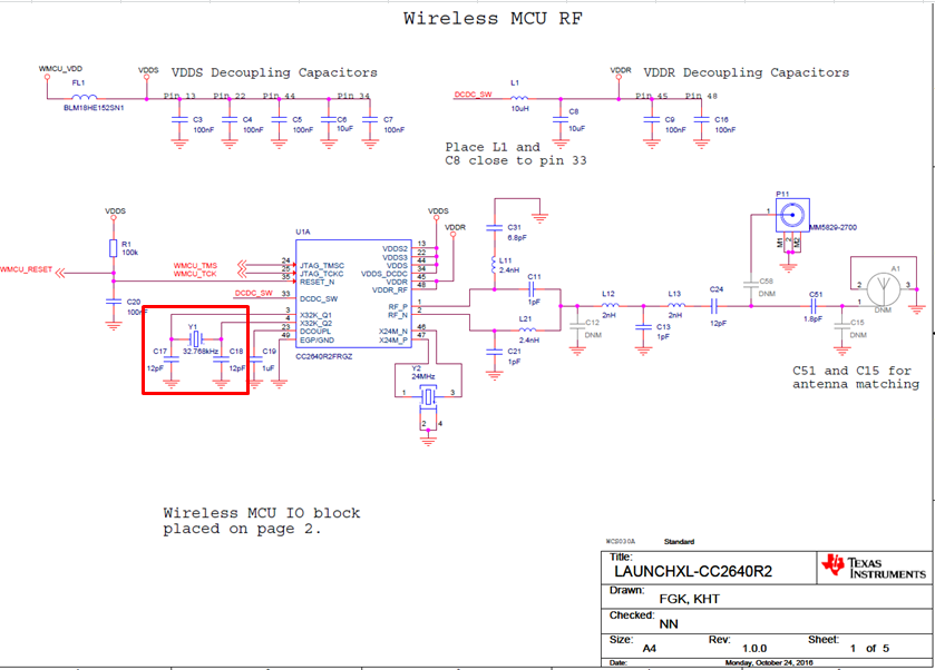

    3. Is the FL1 necessary to connect ?, Can I remove this component ?
    4. If I not use external 32.768kHz, How I should do if no connect (leave open/connect to GND) ?

    4. You can leave these pins floating.
    Vegard
  • For your question No. 2: you need those for proper CC2640R2F operation.
    For your question No. 3: you can leave it open, but you need to use internal oscillator, which is enabled at code.
    -kel

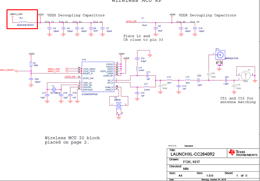

    I will use differential output internal bias by reference schematic from LAUNCHXL-CC2640R2_1_0_0_Schematics only page 1
    1. I need to use BLE, Can I no connect X32K_Q1 and X32K_Q2 ?
    2. What the other component can I remove in this schematic ?

  • Hi
    1. It is possible to remove the XOSC and still use BLE, there is a application report on this topic here: http://www.ti.com/lit/an/swra499c/swra499c.pdf
    2. If you switch to Global LDO mode, you can remove some of the DCDC components, read chapter 9.3 here: https://www.ti.com/cn/lit/an/swra640c/swra640c.pdf
