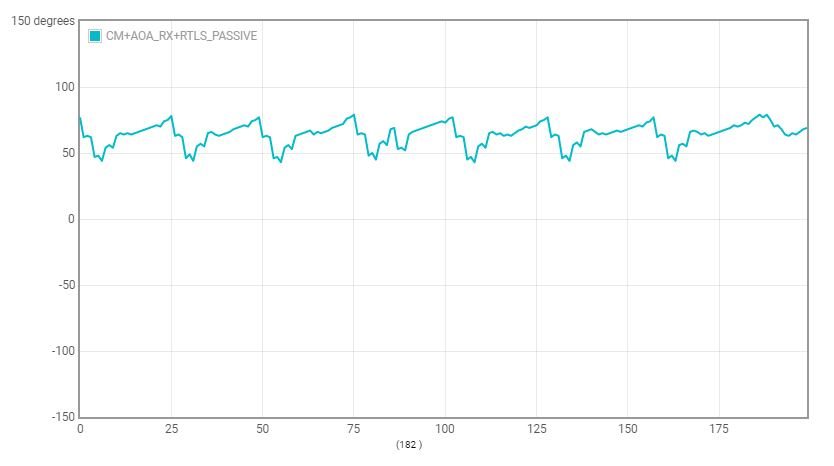

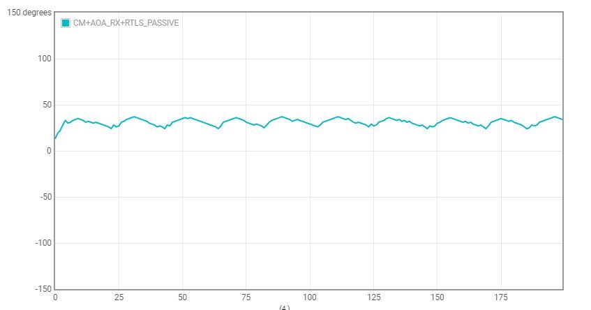

2.
When performing AoA there are now and then periodically repeating patterns like you can see in the images below. Do you now why that is?
Thanks for your help

    2- This type of results is generally due to a bad connection between the boosterpack antennas and the launchpad antenna. Have you moved the capacitor C51 and connected the boosterpack antennas to the launchpad antenna as described in the section "Preparations" of this document?
    I hope this will help,
