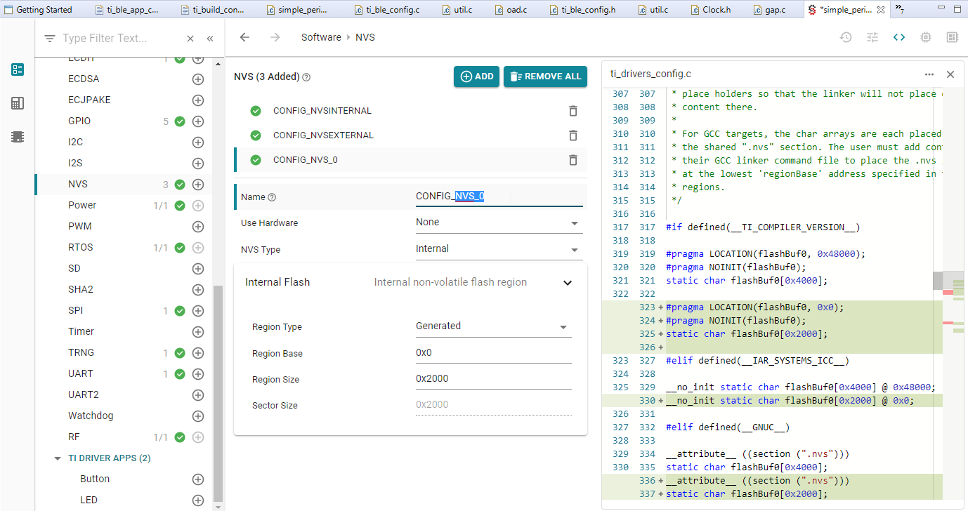

Currently I am trying to store 2 large string arrays and 2 custom structures in non-volatile memory. It is important that these are not lost on reboot or anything like that.
I believe I should use the NVS driver, as the osal_snv driver only supports the use of 2 pages, which is not enough for my data.
Am I correct to use the NVS driver?
I have already tried to use the example code for the NVS internal. However, when trying nvs_read(), the code hangs indefinitely. The same happens when I try adding NVS regions to the Simple Peripheral with On Chip OAD example code.
Any help would be greatly appreciated!
