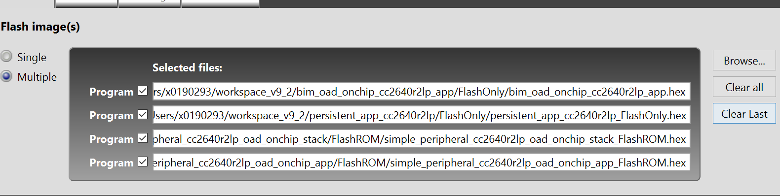

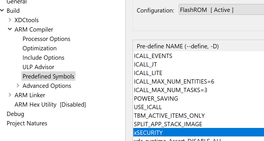

I want to test OAD example with two launchpad boards. I take every step as the OAD enhanced guide shows, but when downloading all the needed file---BIM,persistent,stack,app. The OAD target is not advertising. Pease check the following details:
SDK version: 3.30; CCS version:9.2 ;  Hardware: CC2640R2F launchpad
1.Modify the predefined symbols to xSECURITY to all relevant project then build in the order of BIM,persistent,stack,app.
2.Load the project to OAD target with Flash programmer 2[mass erase it before burn] :
3.After that, Putty did not show anything:
Do i miss anything in the above steps? Please guide me to the right direction, thanks in advance.
