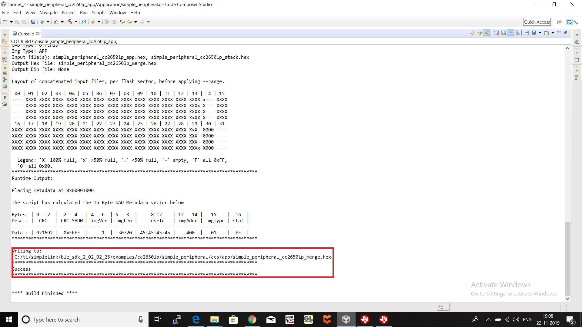

CC2650: ODA is stuck in cc2650 in ti Ble Device monitor 2.9.0
Part Number: CC2650
Other Parts Discussed in Thread: CC2640
While trying to update ODA as you can see in the screen shot attached below, its not successful even after waiting about 30 min as the as the program is still 0% loaded. I also confirm that the there was no interference with the device, it was connected for the entire period with no status change. I am using CCS editor.
  • Part Number: CC2650
    HOw activate ODA in cc2650 using CCS please can send me the code. and the step I do not want to try the IAR or 2 cc2650. I just want to  do with the simple app
  • You can download and install BLE-STACK-2-2-3 and refer to sensortag example in it for BLE OAD example.

    **** Build Finished ****[quote user="Paresh Bhoi"]
    Part Number: CC2650
    hi this side Paresh, I have  once again built the program still it stuck in Ble device monitor I also attache all the  command  in CCS built con

    Writing to:
    C:/ti/simplelink/ble_sdk_2_02_02_25/examples/cc2650lp/simple_peripheral/ccs/app/simple_peripheral_cc2650lp_merge.hex
    Success

  • Hi Paresh,
    Please build a bin file and use this one in the OAD process.
    Also, please make sure you are following all the steps in the OAD User's Guide (located in C:\ti\simplelink\ble_sdk_2_02_01_18\docs\CC2640 BLE OAD User's Guide.pdf).
  • I followed all the step all the oda characteristic is shown but when i am trying to new. Hex fill it is stuck. One more  thing add when a power off and power on the lunchpad board it is not discovery .
  • Hi Paresh,
    Please read the OAD instructions carefully. You will need the bin file not a hex file.
