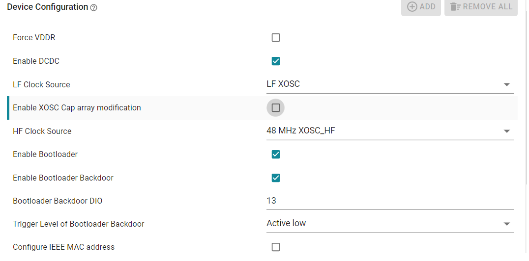

and in CCS our system configuration is shown in the below picture
We've used FC-12M 32.7680KA-A3 32.768kHZ crystal with two 12pF external capacitors and ECS-480-10-33B-CKM-TR 48MHZ crystal with no external capacitors and also tried all possible iterations of cap array for capacitance tuning.

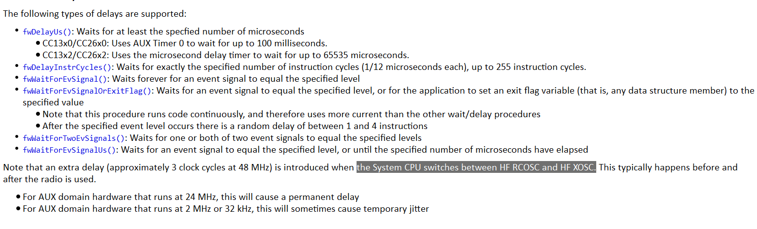

1- Is there an internal 48MHz clock source for HF clock? we ask this question because of highlighted statements in the Sensor controller document.

    1. Yes, the chip has a internal RCOSC running at 48MHz. This is used as the main system clock for the CPU and peripherals. When RF operation is needed, a more accurate HF OSC is needed, si the device switches to the external one. You can read more about the clock systems in section 6.13 in the datasheet.
    2. To implement a delay function in the sensor controller based on the RTC you can use the Timer 0/1 Event Trigger and read the RTC value. The Timer 0/1 Event Trigger uses a 8kHz signal which is in sync with the RTC.
    When you say your code does not work in one of the examples, how does it not work. Note that the Cap Array Tuning is for tuning the HF_XOSC, and not the LF_XOSC.
