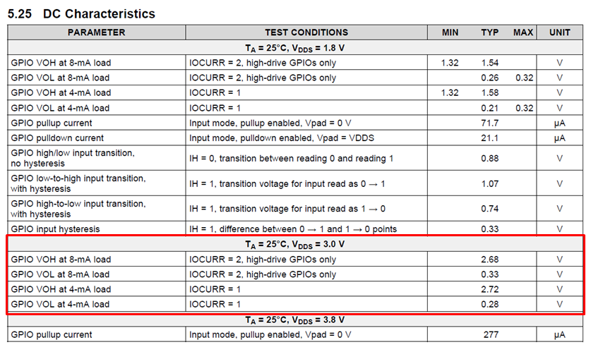

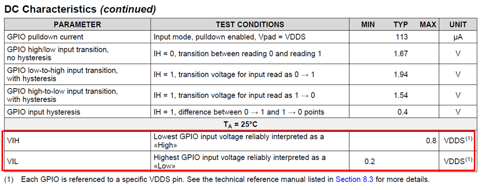

If I supply VDDS = 3.3V, I need to know about input/output voltage level.
1. How much the value of input voltage for high level and low level ?
2. How much the value of output voltage for high level and low level ?
