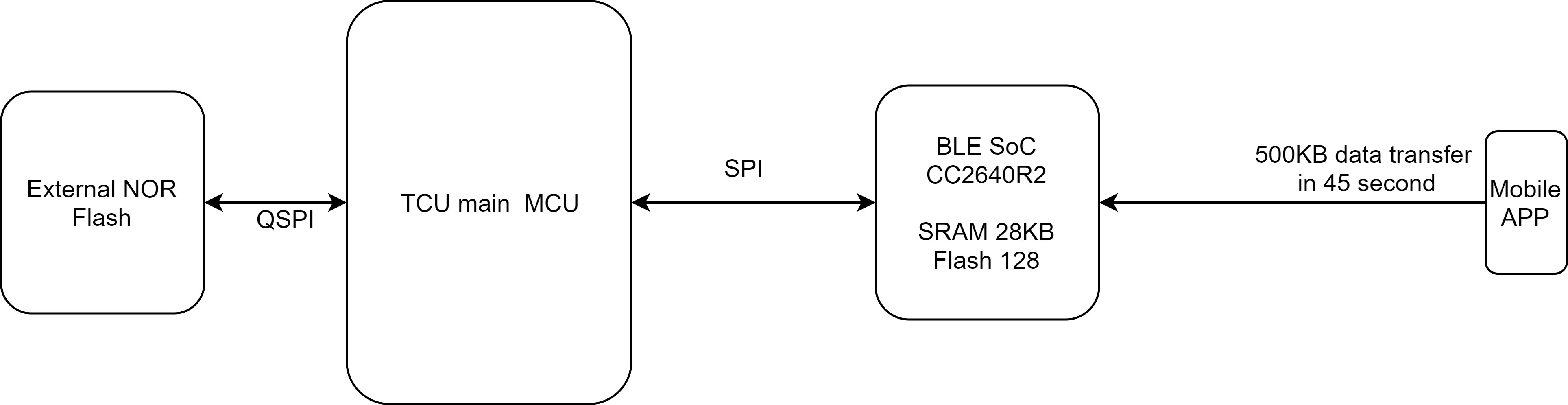

thanks for the reply
In my usecase, EEPROM is not directly connected to the BLE SoC. EEPROM is directly connected to the MCU via QSPI.
It is suitable for my usecase?
Do you mean you use CC2640R2F as BLE network processor and you have another MCU to act as host with EEPROM connected to this MCU?
Which one you want to do OAD? MCU or BLE Soc? What SW do you run on BLE SoC? Is it peripheral role application or BLE network processor?
