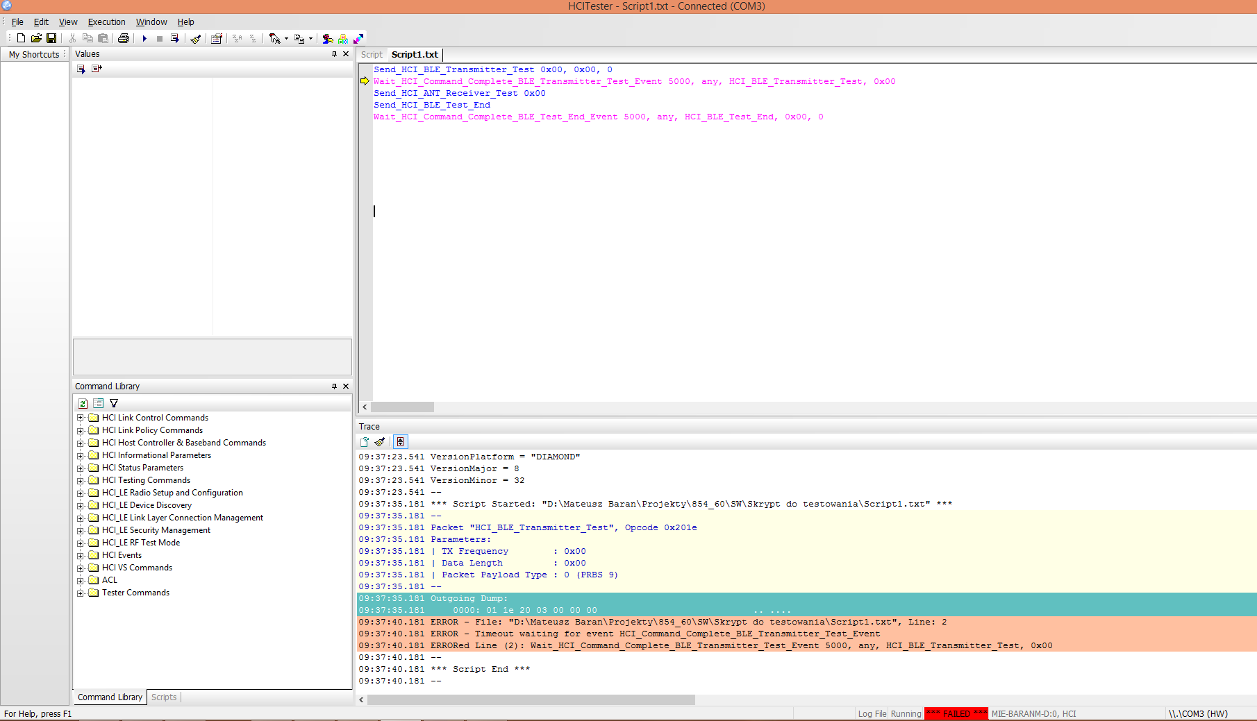

I have problem to turn on the PTM mode in CC2640 microcontroller. I follow with instruction which is placed in simpleLink location:
simpleLink location on the disc -> /ti/simplelink_cc2640r2_sdk_3_20_00_21/docs/blestack/ble_user_guide/html/ble-stack-3.x/creating-a-custom-bluetooth-low-energy-application.html#using-production-test-mode-ptm

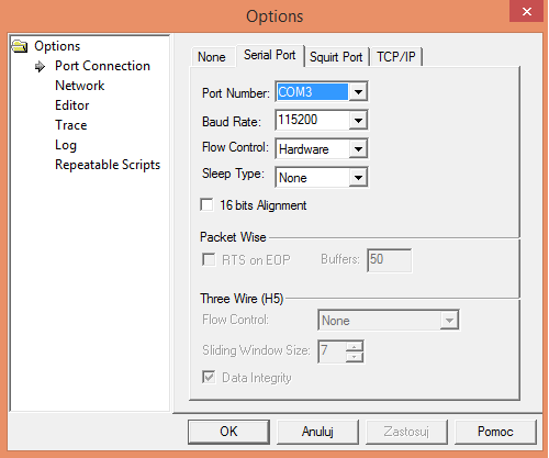

To the test I use LAUNCHXL-CC2640R2 Rev:1.0 and HCItester(version 3.0.0.37). When I send some HCI command I don't receive answer and in the HCITester console I have timeout error. UART have same setup like in HCItester.

  • Hello Mr. Simon,
    I have this issue on the LaunchPad. Here you have my setup in the LaunchPad:
    Here you have my setup in HCITester:
    Here you have my defect in the HCItester console:
    Till I started working with tests, the UART working fine.

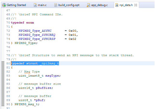

    when I implemented NPI. I have some problem with compilation. To modiffy project settings I modiffy app file: .projectspec:  I add :

    After that I also have problems in compilation. To solve this problem I changed "_npimsg_t" on the "_npi2msg_t",  because compiler give me error "multipy definition":
    Before I start work with NPI I turned off task which is responsible on UART. Before I program the Flash I build  stack library and app project.
    Best regards Mateusz
