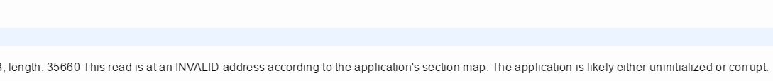

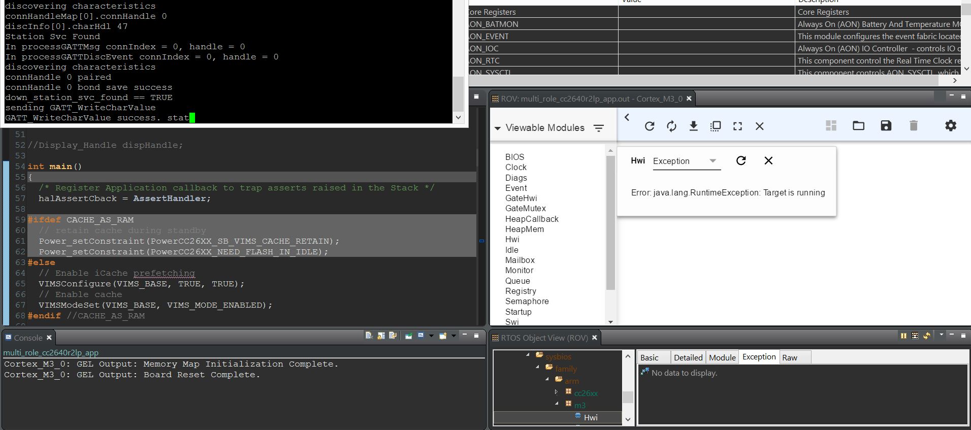

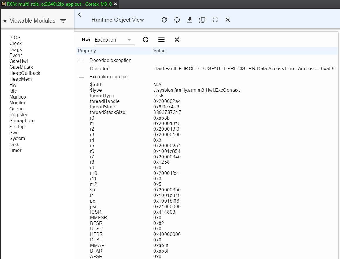

  • Hey Sean,
    Hwi exception:
    Error: java.lang.RuntimeException: Target is running
    To the left you can see UART log (putty). Gets stuck in the middle of the print, right after GATT_WriteCharValue() is done:
    Still have no idea what's wrong..
    Amit

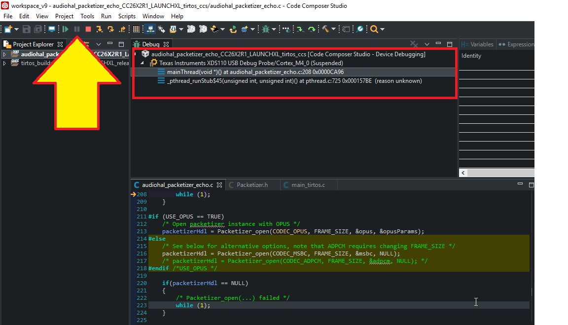

  • Amit,
    Please hit the pause button.
  • Hey Sean,
    Amit

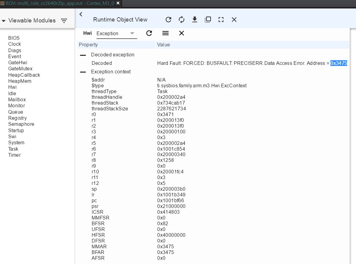

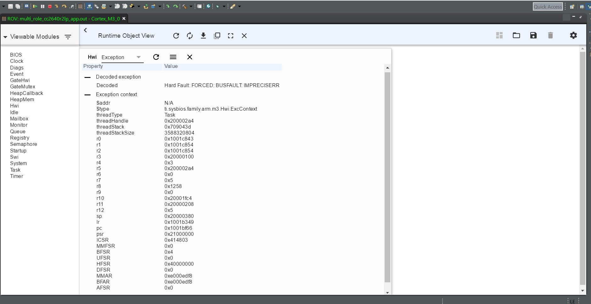

  • Amit,
    You have an imprecise error, force it to precise as detailed by:
    http://dev.ti.com/tirex/content/simplelink_cc2640r2_sdk_3_30_00_20/docs/blestack/ble_user_guide/html/ble-stack-3.x-guide/debugging-index.html#exception-cause
    Then attach to debugger and re-run the experiment.
  • Hey,
    Is this ok:
    Amit

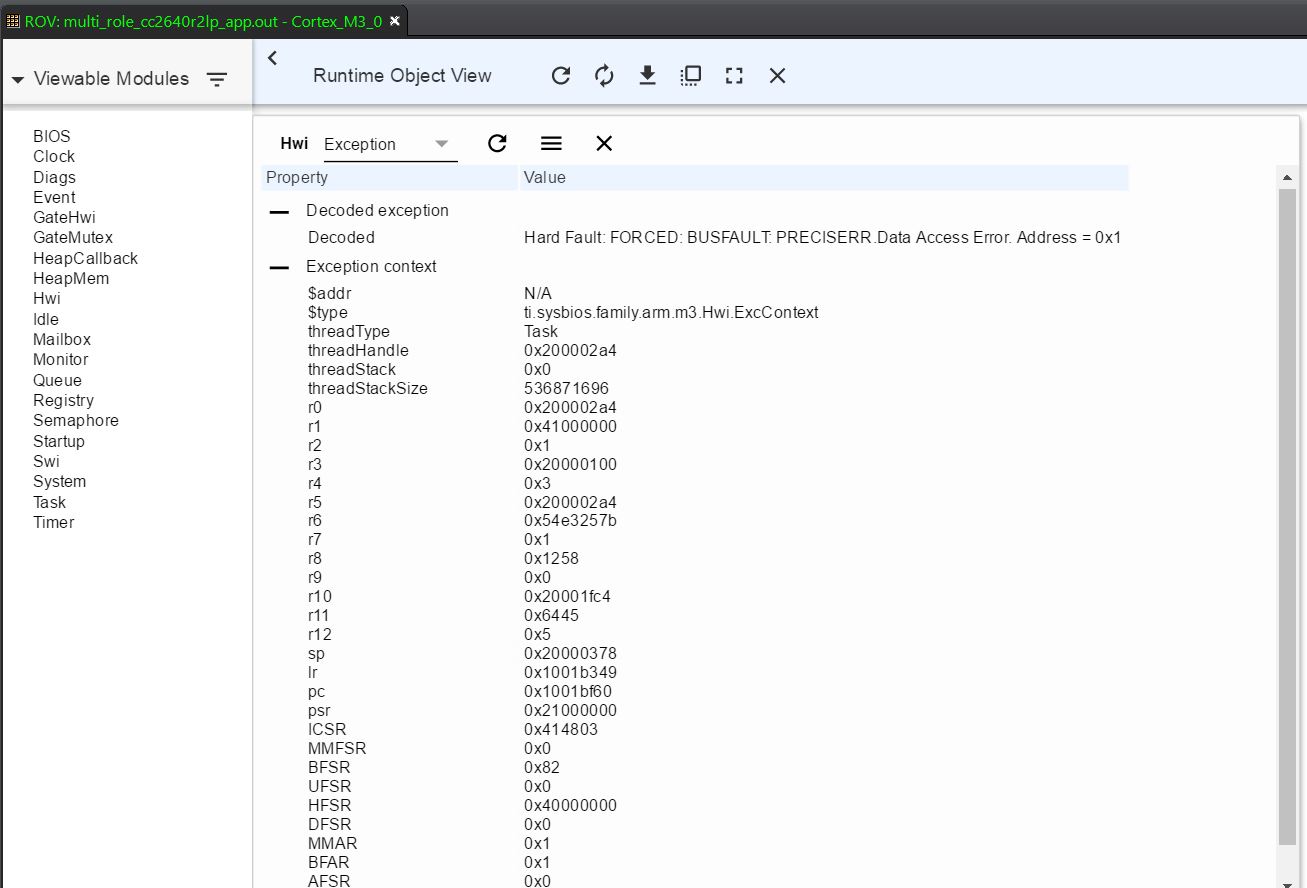

  • Hey Amit,
    Something in the code is attempting to write to address 0x01. This is in Flash (thus not writable) and is causing a bus fault.
    I recommend setting a hardware watch point on address 0x01 and seeing what code is writing to that address.

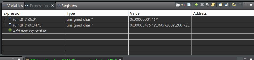

  • Hey Sean,
    How do I set a hardware watch point? I am sorry, using this debugger is kind of new to me.
    Amit
    I'm not sure I've done this right. I've added this to the expressions:
    "(uint8_t*)0x01"
    But then I got data access error in some other address 0x3475:
    So I've added another expression like this:
    Then I got a different address again:
    So I'm not sure I've added the hardware watch point right. Can you please tell me whats wrong?
    And again I remind you that if only I keep those two useless lines in my code:
    It works without errors and doesn't get stuck.
    I have no idea whats going on..
    Amit
  • Hi Amit,
    We have a guide on how to set watchpoints in CCS here:
    http://dev.ti.com/tirex/content/simplelink_cc2640r2_sdk_3_30_00_20/docs/blestack/ble_user_guide/html/ble-stack-3.x-guide/debugging-index.html#watchpoints-in-ccs
    I have linked it for your benefit. However, since as you have observed the address is changing we need to do a bit more clever debugging.
    Here is what I can summarize:
    1. You are reaching a hard fault because the device is attempting to write to flash memory
    2. The address at which the attempted write occurs is random
    3. The presence of the "useless" devList structure in memory is likely masking the problem because it is changing the layout of variables in SRAM

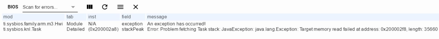

  • Hey Sean,
    I've tried both ideas and here's what I've found.

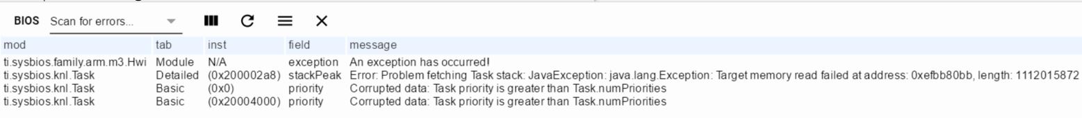

    Note - the error also occurs if I only comment this line
    Leaving devList[] definition not commented:
    So unless the compiler removes devList[] for no usage, it should be in the memory. And of course I still get the same error.
    To the attempts:
    1. Here's what the BIOS scan for errors produced:
    2. I've reduced optimization level to 3 - Interprocedure Optimizations and let it run again, here's what it produced:
    Still clueless...
    Amit
  • Hi Amit,
    This almost certainly confirms the case of memory corruption. The ROV cannot read the internal structures related to the kernel because they have been written unexpectedly by some other process or pointer. Which is why the ROV is unable to show information correctly.
    Memory corruption usually happens in the following conditions:
    1. Heap issues e.g. FREEing a pointer twice or using a pointer after it has been free'd
    2. Size issues, an API is called with an improper length causing an operation to touch memory it shouldn't
    Since the bad operation (triggering the exception) is happening at a random address, the watch point approach won't work.

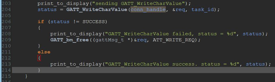

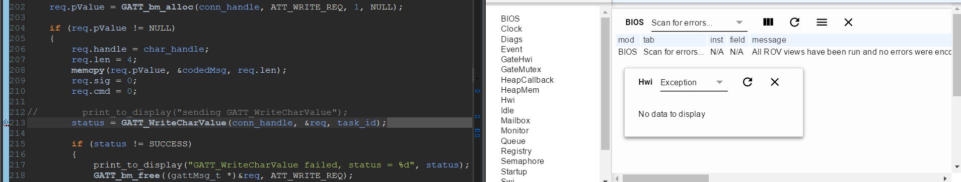

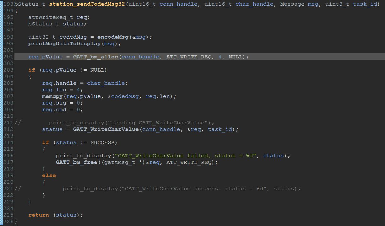

  • Additionally, can you post all the modifications to the code surrounding the GATT_WriteCharValue and mr_doGattRw that you have made?
  • Hey,
    Confirmed:
    No errors before GATT_WriteCharValue.
    Amit
  • Hi Amit,
    Thanks for the test
    Your screenshot reveals a potential issue with the code:
    In line 213 you allocate space for 1 byte inside req.pValue, then you pass that value to the stack with req.len = 4; (line207).
    Also in line 208 there is a memcpy that will write 4B into a pointer that only has 1 byte allocated for it which will corrupt the structure of the heap.
    In summary, if you wish to write 4 bytes in GATT then you should modify the GATT_bm_alloc to allocate 4B instead of 1.
    req.pValue = GATT_bm_alloc(conn_handle, ATT_WRITE_REQ, 4, NULL);
    The 3rd parameter is of interest here which controls the size of the memory to allocate.
  • Hey Sean,
    For a minute I thought this was it, fixed this mistake and changed the size to 4 but it still gets stuck in the exact same manner :/
    So close... but it still seems to me like something in GATT_WriteCharValue.

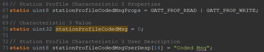

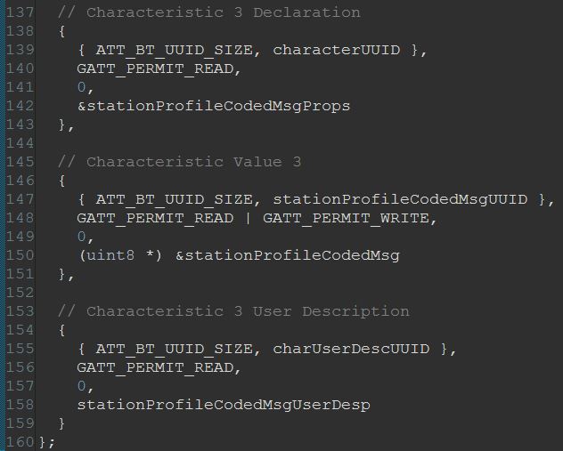

    Can you share the place the you actually define the stationProfileCodedMsg variable? How about where you pass it into the profile (e.g. gattAttribute_t [])
  • Hey Sean,
    Hope you had a good vacation.
    This is the definition of stationProfileCodedMsg in station_profile.c:
    This is codedMsg definitions in stationProfileAttrTbl[]:
