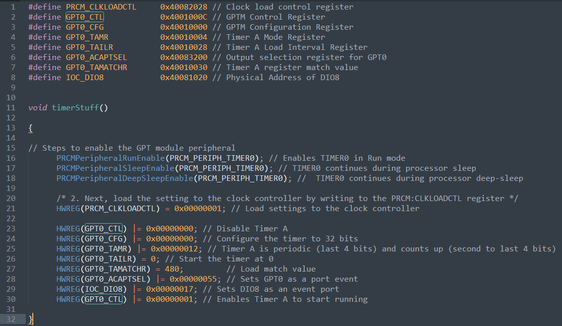

A bit of pseudo-code for what I have:
#define PRCM_CLKLOADCTL     0x40082028 // Clock load control register
#define GPT0_CTL            0x4001000C // GPTM Control Register
#define GPT0_CFG            0x40010000 // GPTM Configuration Register
#define GPT0_TAMR           0x40010004 // Timer A Mode Register
#define GPT0_TAILR          0x40010028 // Timer A Load Interval Register
#define GPT0_ACAPTSEL       0x40083200 // Output selection register for GPT0
#define GPT0_TAMATCHR       0x40010030 // Timer A register match value
#define IOC_DIO8            0x40081020 // Physical Address of DIO8
void timerStuff()
// Steps to enable the GPT module peripheral
      PRCMPeripheralRunEnable(PRCM_PERIPH_TIMER0); // Enables TIMER0 in Run mode
      PRCMPeripheralSleepEnable(PRCM_PERIPH_TIMER0); // TIMER0 continues during processor sleep
      PRCMPeripheralDeepSleepEnable(PRCM_PERIPH_TIMER0); //  TIMER0 continues during processor deep-sleep
      /* 2. Next, load the setting to the clock controller by writing to the PRCM:CLKLOADCTL register */
      HWREG(PRCM_CLKLOADCTL) = 0x00000001; // Load settings to the clock controller
      HWREG(GPT0_CTL) |= 0x00000000; // Disable Timer A
      HWREG(GPT0_CFG) |= 0x00000000; // Configure the timer to 32 bits
      HWREG(GPT0_TAMR) |= 0x00000012; // Timer A is periodic (last 4 bits) and counts up (second to last 4 bits)
      HWREG(GPT0_TAILR) = 0; // Start the timer at 0
      HWREG(GPT0_TAMATCHR) = 480;         // Load match value
      HWREG(GPT0_ACAPTSEL) |= 0x00000055; // Sets GPT0 as a port event
      HWREG(IOC_DIO8) |= 0x00000017; // Sets DIO8 as an event port
      HWREG(GPT0_CTL) |= 0x00000001; // Enables Timer A to start running
My code will compile, but I am unable to see the timer output on the desired pin. I'm unsure if my issue is with the order I am writing to the registers, or if I'm setting the output on the pin wrong. Any assistance would be greatly appreciated.
Thanks for your time.
Nick
  • I expected the file to just display on the site, but it isn't on my end, so I'm attaching an image of the file:
  • We only give very limited support for bare metal related questions. Please look into using the drivers directly (APIs http://dev.ti.com/tirex/explore/node?a=VLyFKFf__3.6.2&node=ADfS7ixpgUmHy56H6NON4Q__krol.2c__LATEST&r=VLyFKFf__LATEST) or look into the driver code on how the drivers uses the driiverlib functions.
