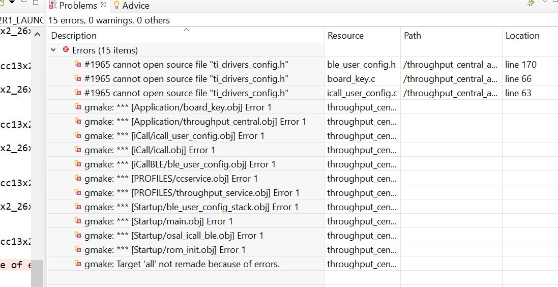

  • Worked around the CCS installation error by installing CCS on a development laptop. CCS 9.3 installed. Also installed the simplelink_cc13x2_26x2_sdk_3_40_00_02 SDK. Then copied the github repo over and attempted to build "throughput_central" application.
    I received many errors. Any ideas? Looks again to be an issue with configuration files not being correct or are absent.

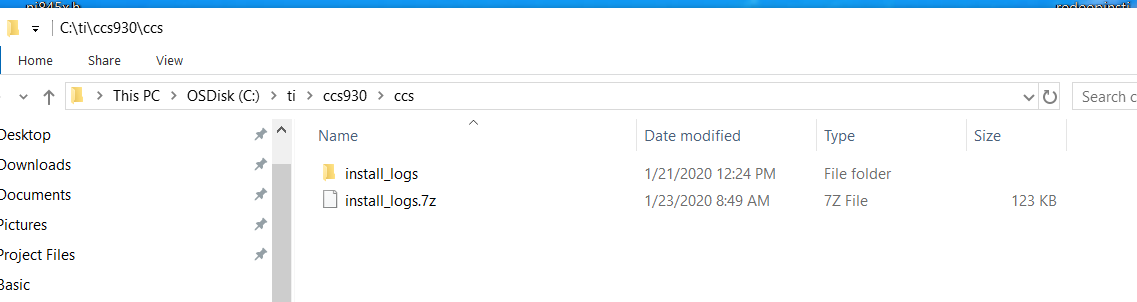

  • Is there a ccstudio.exe in C:\ti\ccs930\ccs\eclipse?
    If so, can you try running it? Does CCS startup successfully? Can you start the debugger for your device and connect to it?
  • There is nothing in the CCS directory except for the install logs.

  • Hi Brandon,
    I just saw that my project was trying to find the files in the newest version of the SDK instead of v3.20 which caused the error. By selecting the correct SDK (v3.20) in Properties -> General -> Products -> SimpleLink CC13x2 CC26x2 SDK you should be able to build the project successfully.
    Elin
