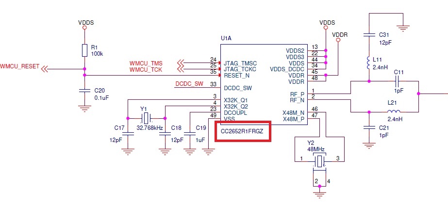

2. Evaluation of CC2642R
From schematic of LAUNCHXL-CC26X2R1 which I downloaded on TI.com page, CC2652R is mounted.
To evaluate CC2642R, we need to replace CC2642R with CC2652R?
Or CC2652R is function compatible, so we can evaluate CC2642R's performance with this lauchpad?
I would appreciate if you would give me comment.
Thanks and best regards,
Ryo Akashi
  • CC2652R is a superset of CC2642R meaning that you can evaluate CC2642R using a CC2652R Launchpad.
    If they plan to use BLE only,they should use  CC2642R since CC2652R cost a bit more since it's a superset.
    The difference between the devices is which protocols that are supported and this is covered in the datasheet.
