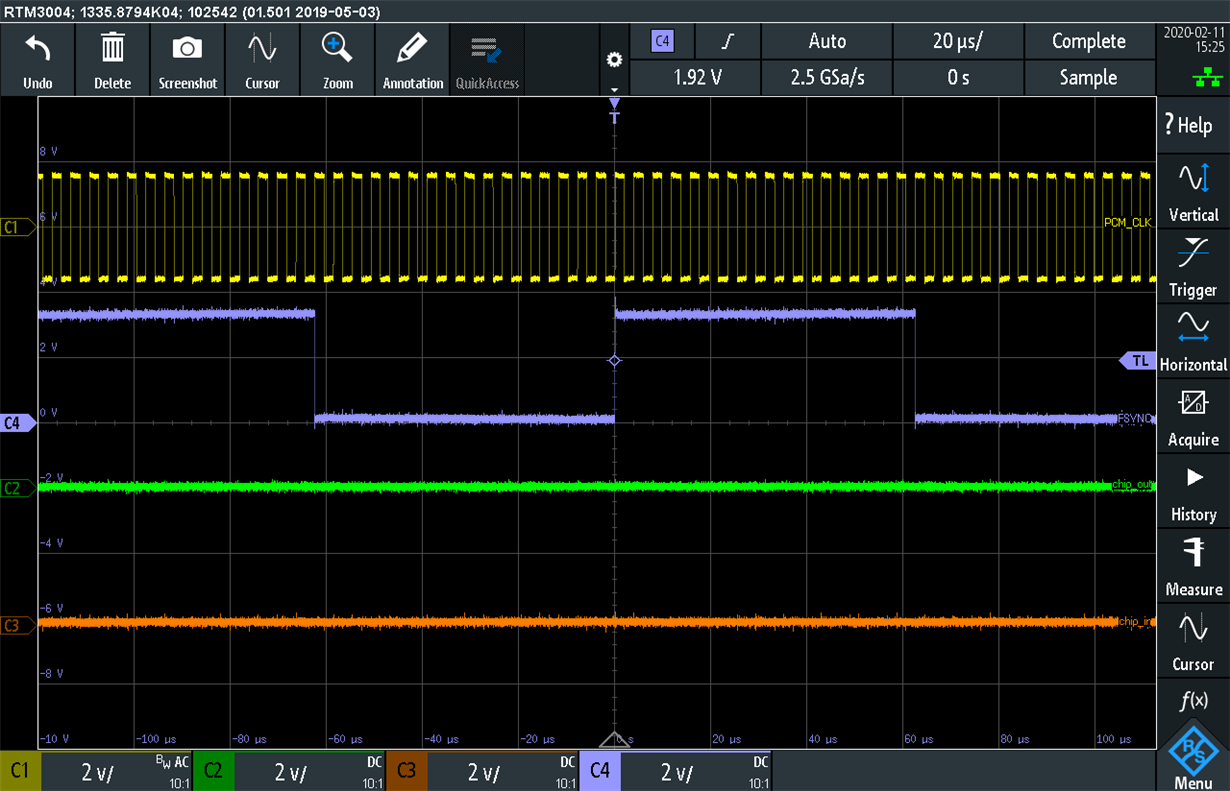

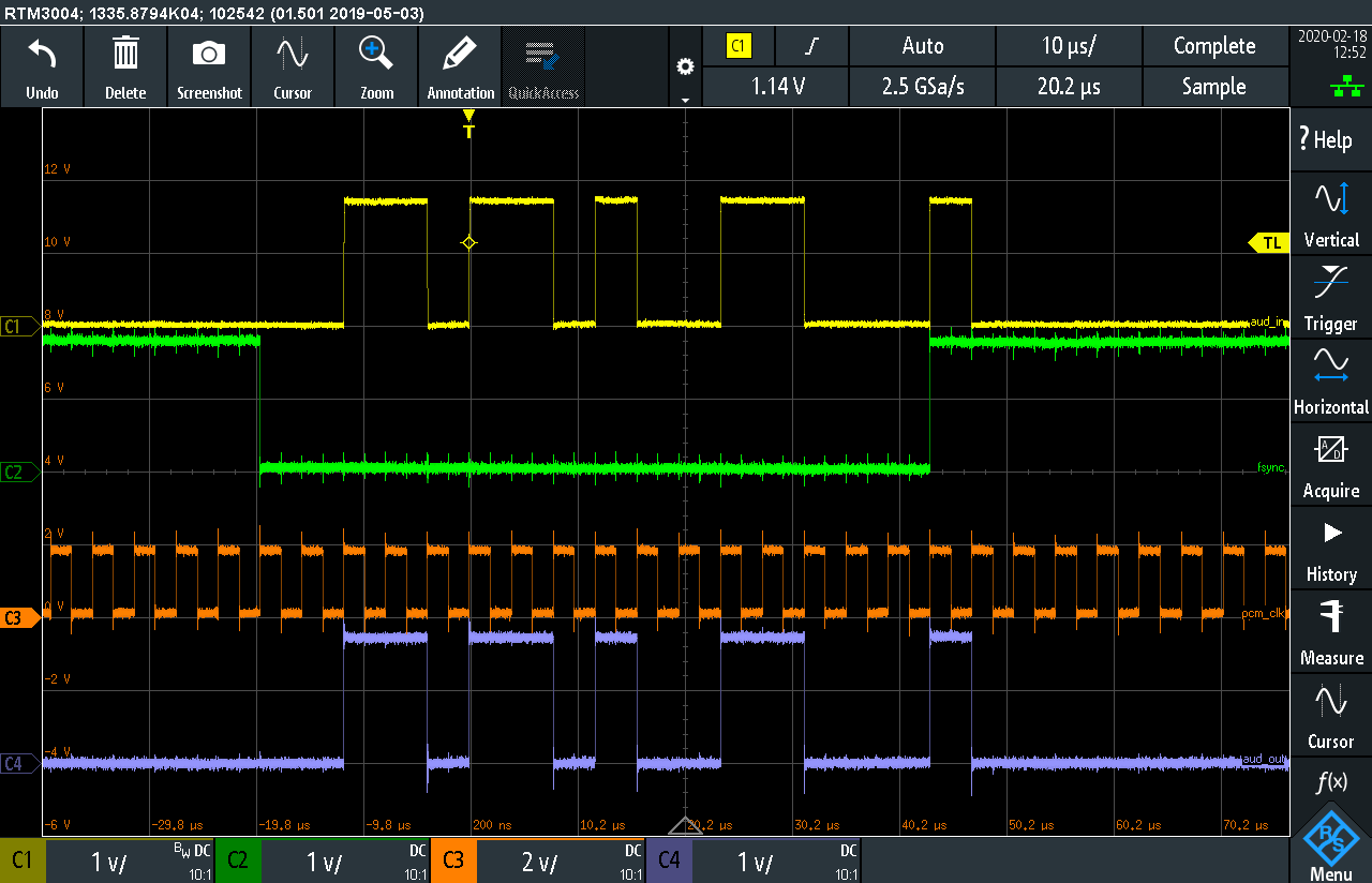

  • Hi Vihang,
    We will do PCM loopback check in our factory verification, as you said that we:
    1. After BT chip initialized including HCI_VS_Write_Codec_Config
    2. Send HCI_VS_Set_Pcm_Loopback_Enable(0xFE28) to enable CC2564 loopback mode
    3. Send data to CC2564 over AUD_IN
    4. Record data from CC2564 over AUD_OUT
    5. Compare input and output data
    The compare result is identical, below is the waveform we measured during PCM loopback test:

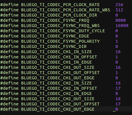

  • Hi Vihang,
    Here is our PCM configuration settings for CC2564 in BT stack:
    I attached the HCI log, and the #93 frame is HCI_VS_Write_CODEC_Config command:
    https://e2e.ti.com/cfs-file/__key/communityserver-discussions-components-files/538/hci_5F00_gw_5F00_dump.7z
    Please review if our PCM settings is correct, thanks.
  • Hi Will,
    The PCM parameters above indicate that all the input and output signal edges are selected as rising edge (0x00). But the oscilloscope capture shows that the PCM data input signal to the CC2564C (out from host/codec) is also asserted on the rising edge of the PCM clock. For best result, you should output the signal (in either direction) on rising edge and sample the signal on the input (on the other device) on the falling edge.
    So, I would recommend making the following change on the CC2564C side.
    #define BLUEGO_TI_CODEC_CH1_IN_EDGE     1
    #define BLUEGO_TI_CODEC_CH2_IN_EDGE     1
    Since the data out from CC2564C on both channels is configured for rising edge, please make sure the input on the host/codec is configured for the falling edge. Please give it a try.
    Vihang
